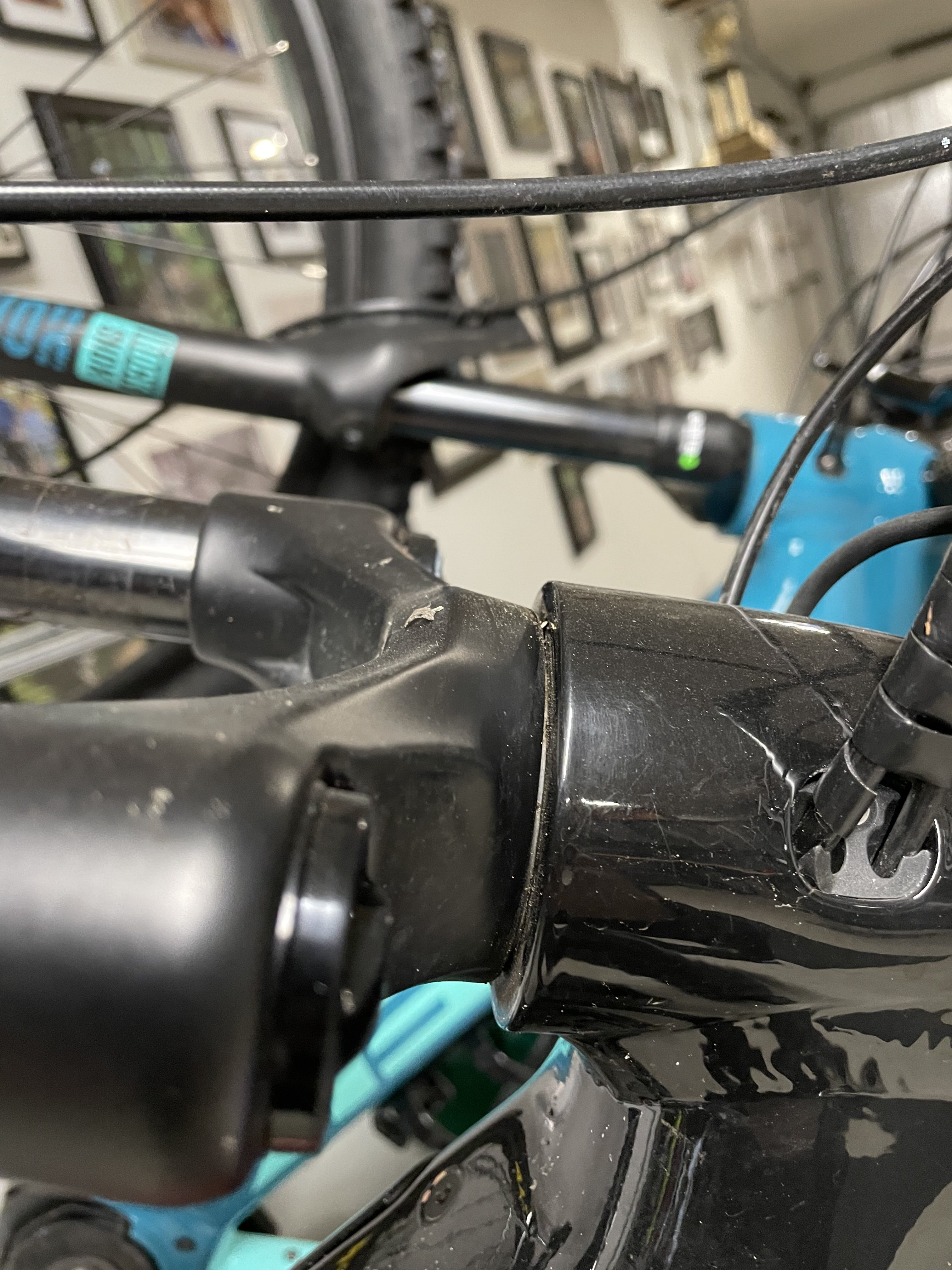

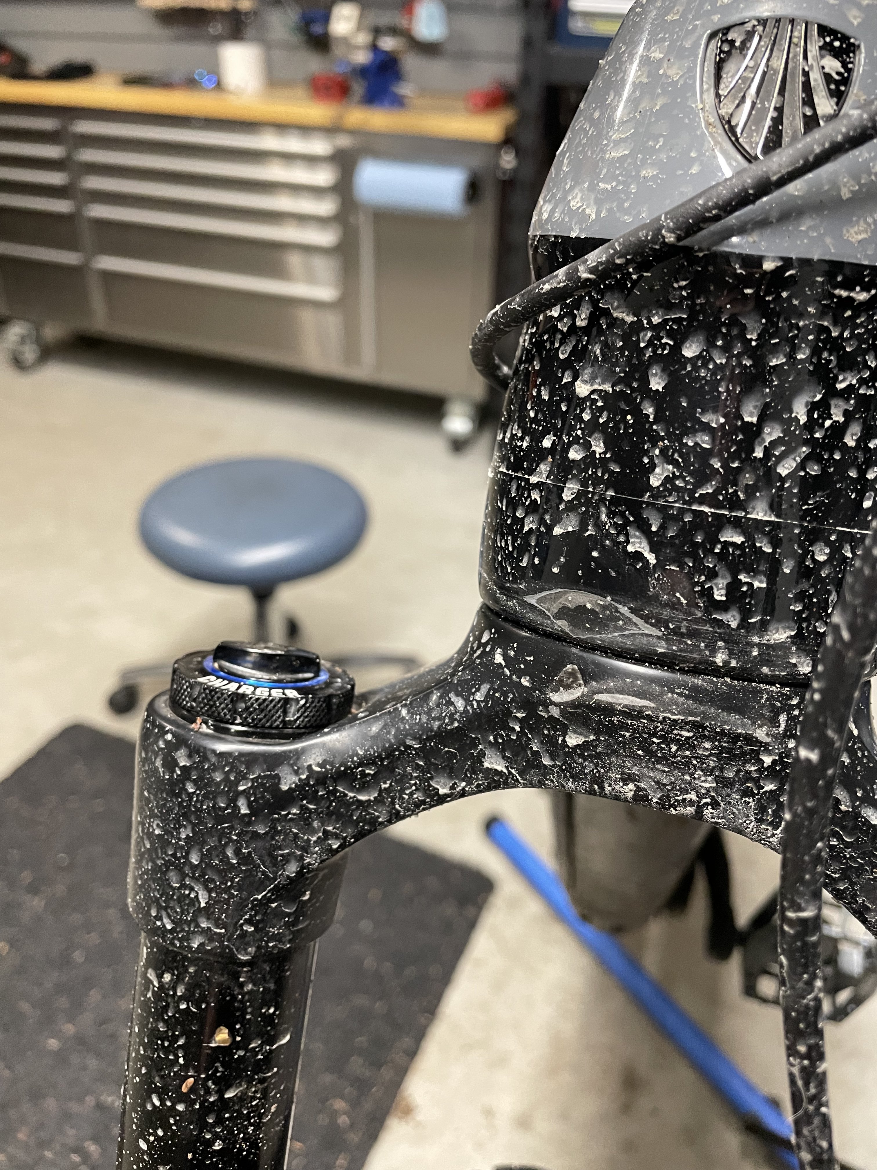

Here’s a couple of pictures of the step and no-step.
This is from my Trek hardtail with pike forks. Typical step occurs with this type of fork. Noticeable to me but doesn’t affect performance.
Here’s my Rail with Deore/Lyric forks. No step. (Oh man, that is dirty). The Zeb ultimate (which lines up to the Trek frame profile) is exclusive to Trek. I was about to upgrade this fork (Zeb Ultimate) but the Lyric upgrade seems to be fine. Plus the Zeb was $1800.
I don’t think an adapter is needed and debris is not an issue.

Thanks for posting. I see what you mean about that step now. I'm not sure how much that would bother me. But it does seem a little out of place. How do you like the Fox 38 on your rail? So it was a straight swap?
