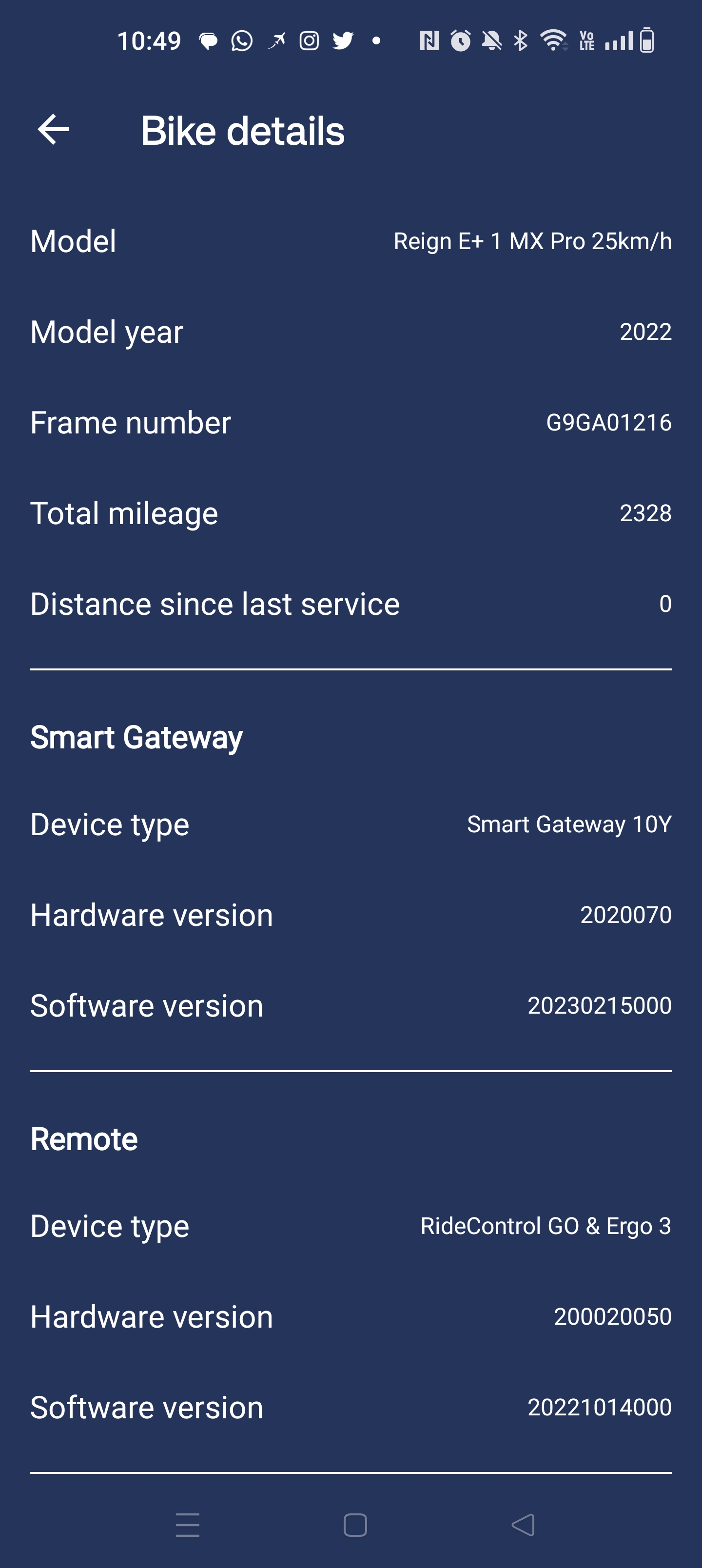

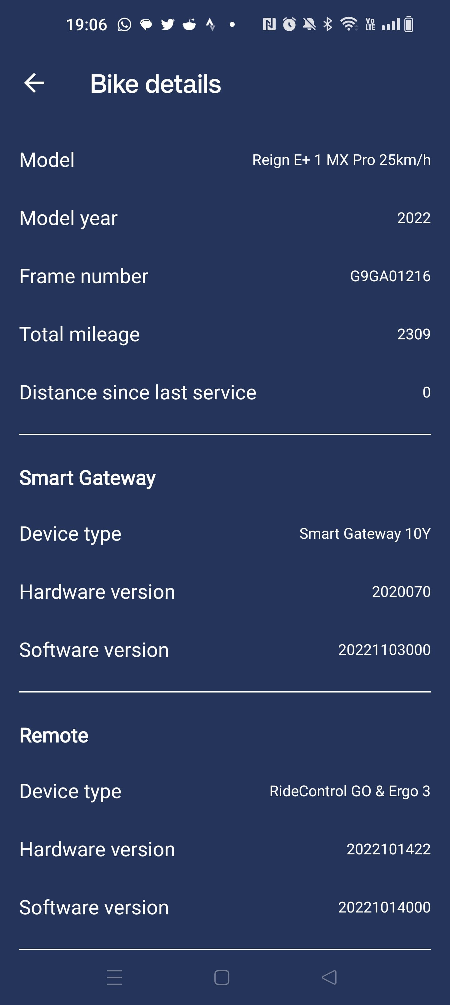

So, I updated my software on the app at the weekend on my giant reign e+1 and now it only charges to 85%. Very frustrating and wish I'd know of this issue before downloading the new version. Never had an issue with the app before and the bike has been absolutely faultless in the 2500 miles I have had it (since new) has anyone else experienced this? Is there a solution? Definitely the app as it was charging perfect until this point.
Fordo 197
Apr 2, 2022
31
44
Uk
firmware version??

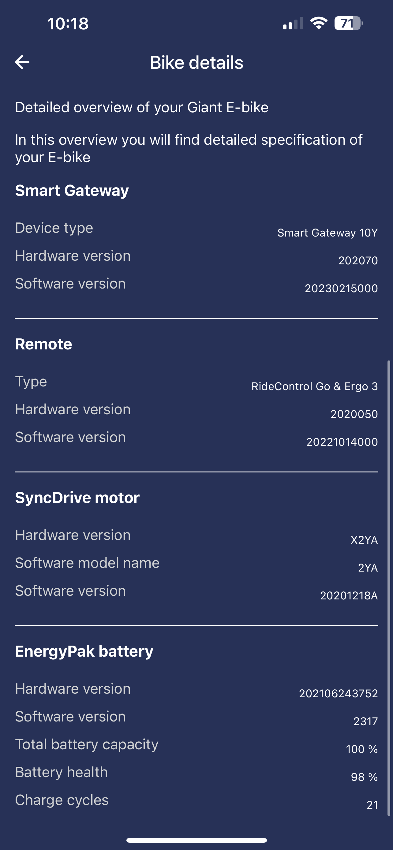

I also just started having an issue with my bike not charging. I removed the battery and it charged to 100%.
I
Did you update your bikes to the latest version released last week, 22th?
