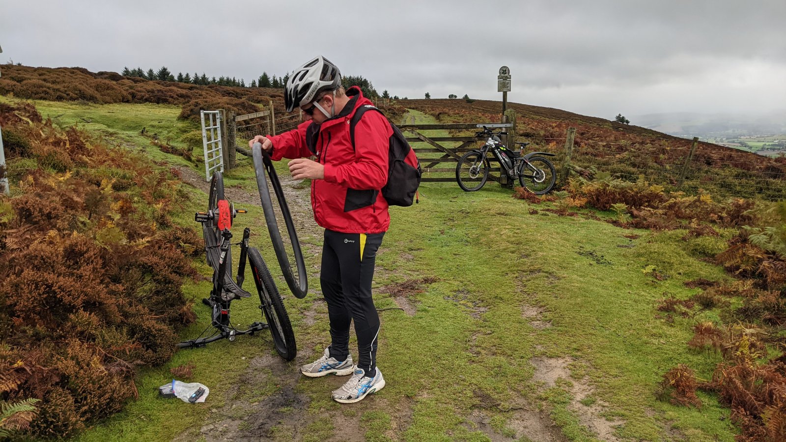

I’ve got Schwalbe Nobby Nic tyres on my bike, my dad has smart sams.
Today we were out in the Cotswolds for a ride, and before we started dad discovered a thorn in his tyre (why he didn’t check before we left home I don’t know lol). Needless to say the tube needed replacing.
An hour later and a helpful local mechanic we’d managed to unset the tyre and put the new tube in etc, and get out on our ride.
I guess what I’m asking is whether anyone has some super tips for changing a tyre (well getting the damned thing off the rim) when away from home?
I’ve previously had a pinch flat on my bike but that was near home, where it was much easier to just walk it home and take my time sorting it (still wasn’t fun).
Suggestions greatly appreciated.
