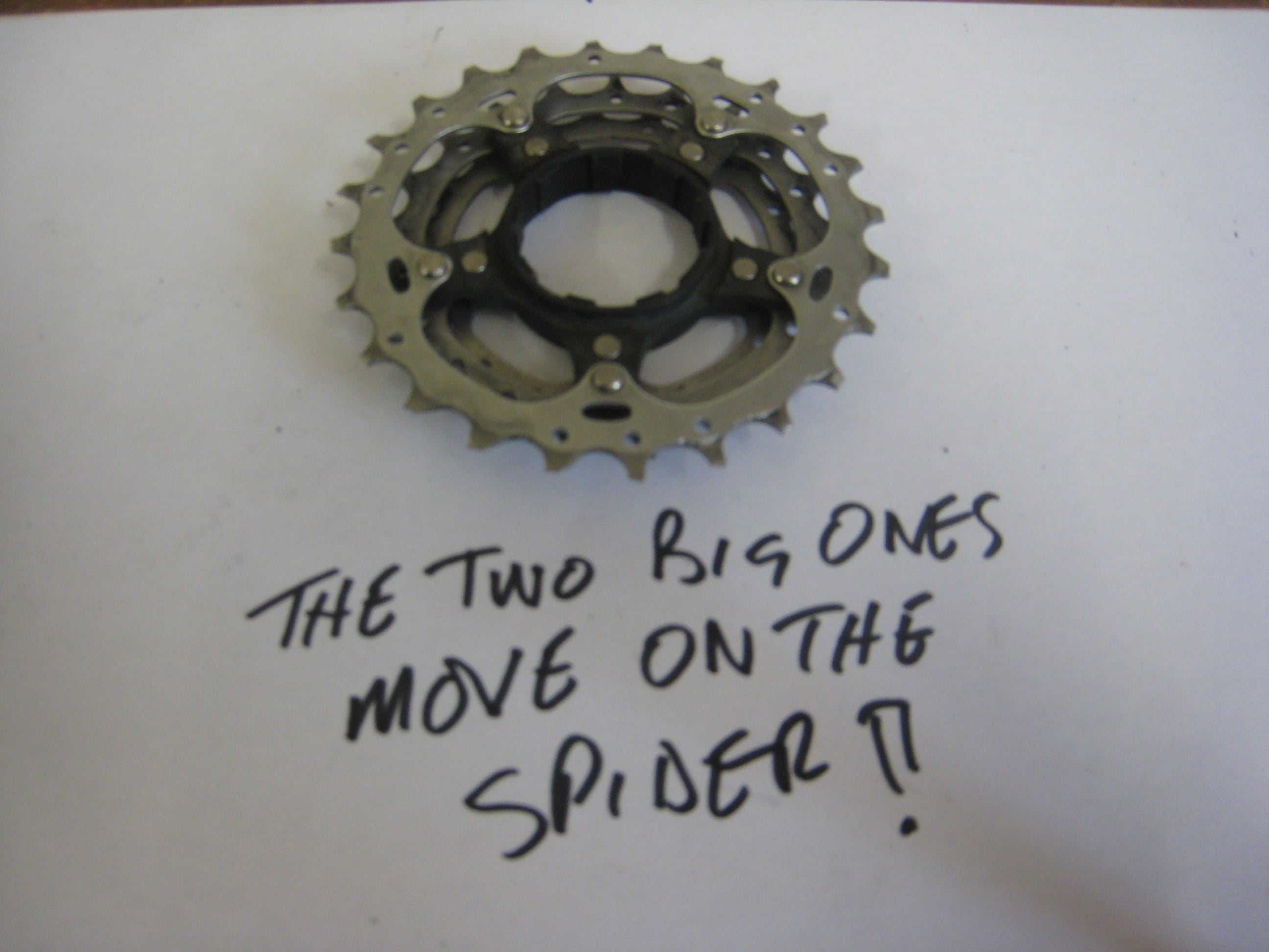

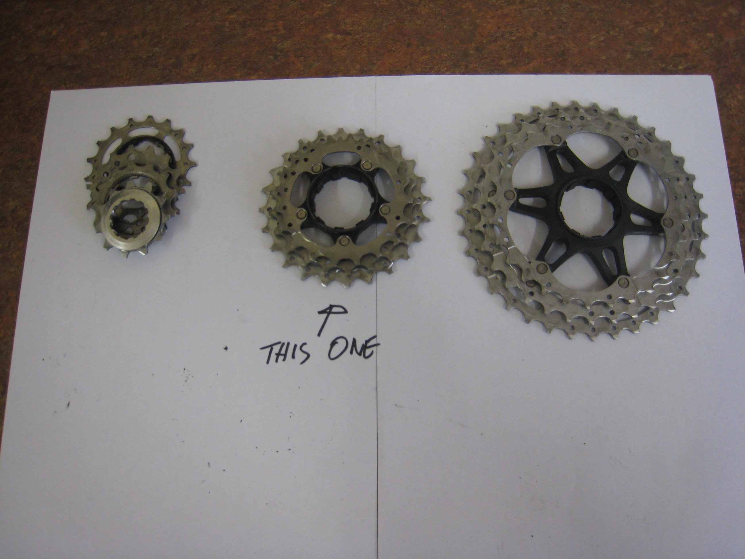

Some SRAM HG cassettes do also. none of them holds the smaller sprockets that caused the OPs issue. Those bolts don't really do a great job of reducing alu freehub gouging either
