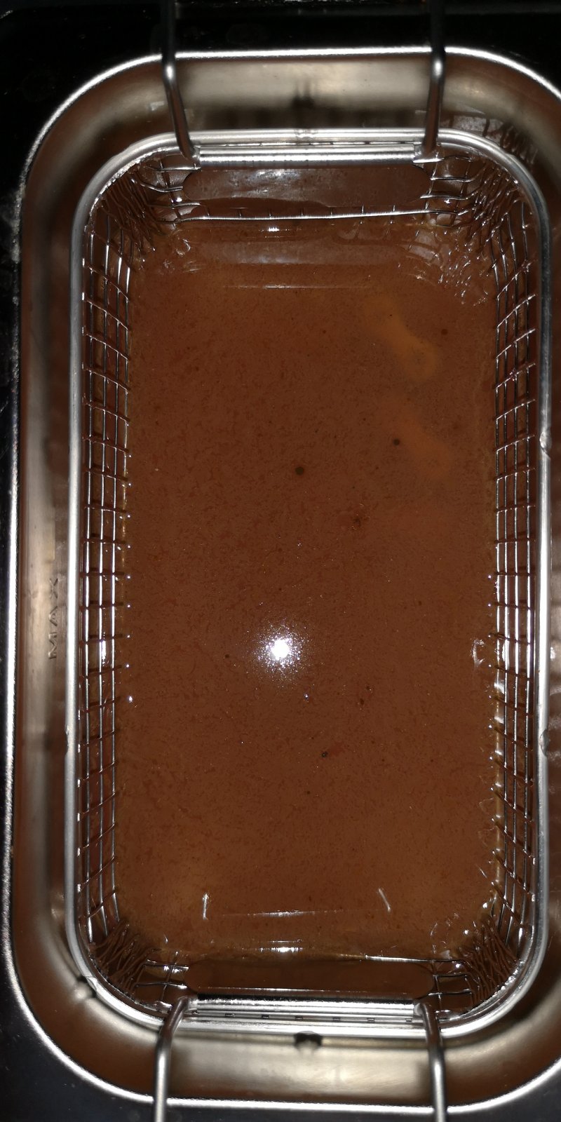

Used a 50/50 dilution of standard Muc-Off bike cleaner.
I was planning on filtering using a coffee filter but it looked so contaminated it got dumped.
I originally did my after ride drivetrain clean using the usual cleaner tool and undiluted Muc-Off bike cleaner but it didn't remove all the grit so went for the soak in petrol but the gritty noise still stayed.
After the Ultrasonic clean, problem sorted. Now the question do I just lube it or wax it. So many options available.🤯
