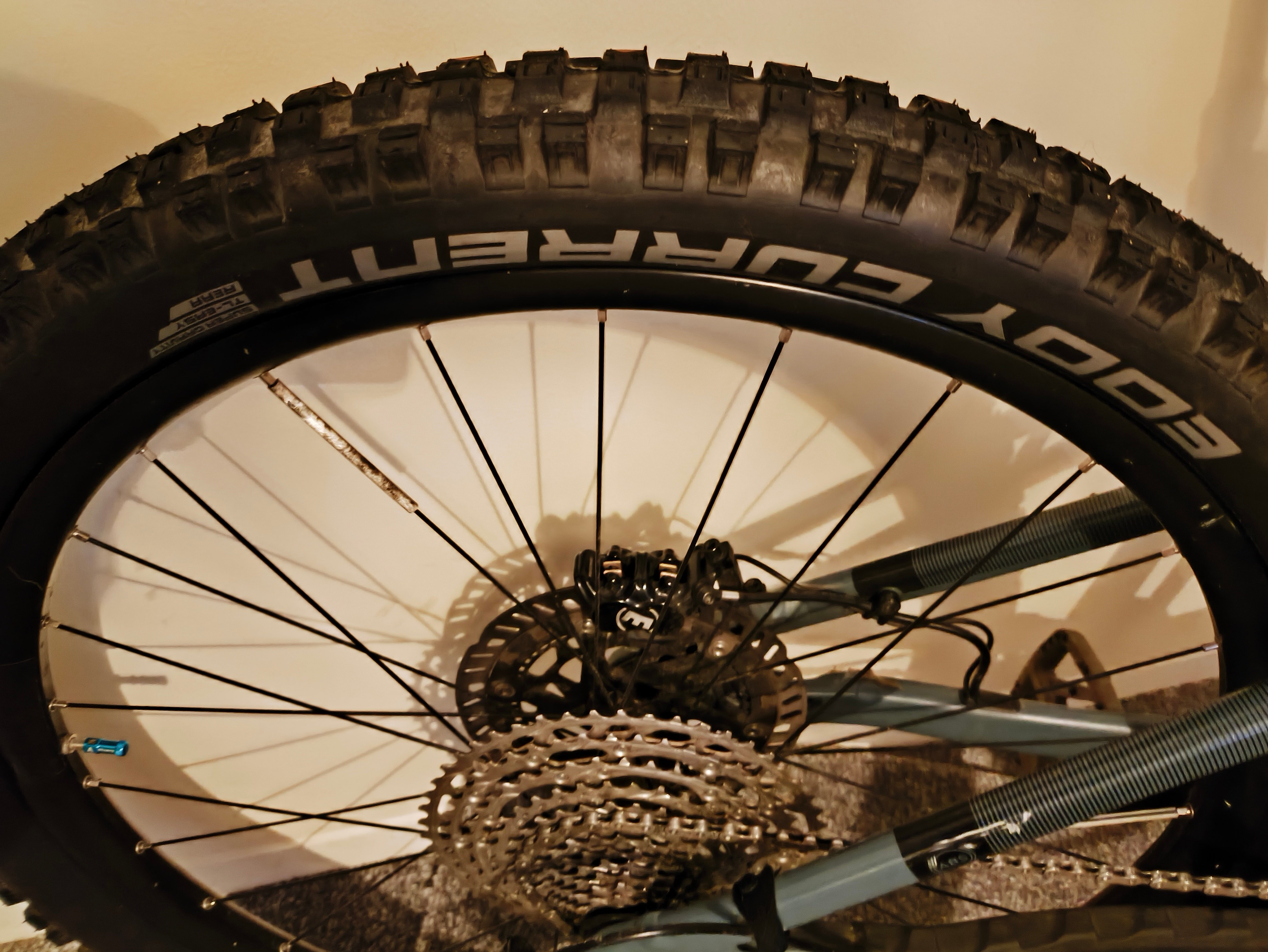

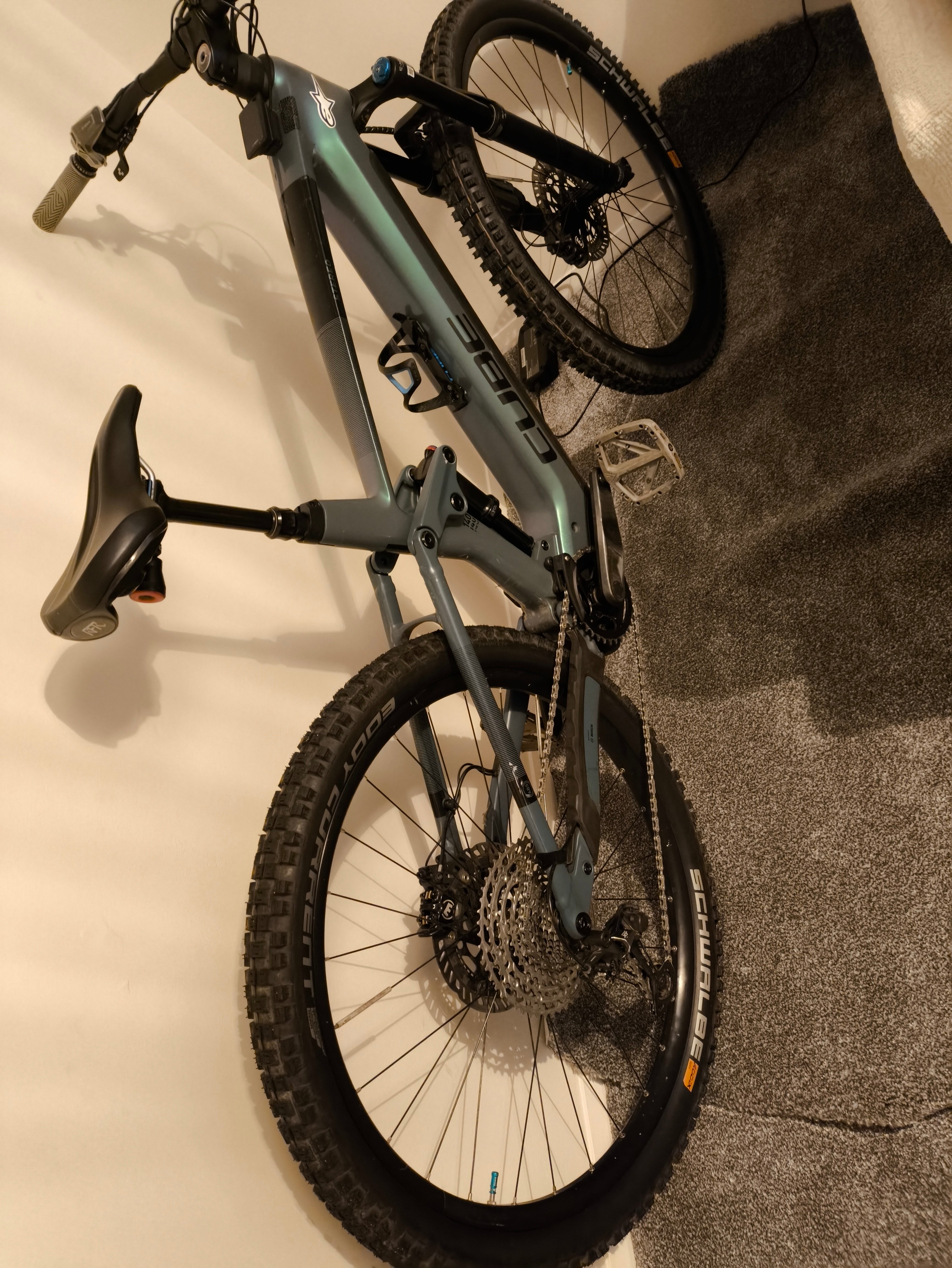

Hi, I've just fitted a pair of eddy currents (29 x 2.60) on my cube. Didn't have any issues fitting them ( did have hans dampf's on before that as they were what the bike came with) I use wat
er / washing up liquid on the tire beads and they slip on no problem at all. Had first ride on them today and they are alot more grippy on the rocks and roots I've got up here in moray Scotland. Just my view but I've never had an issue with any schwalbe tyres.
