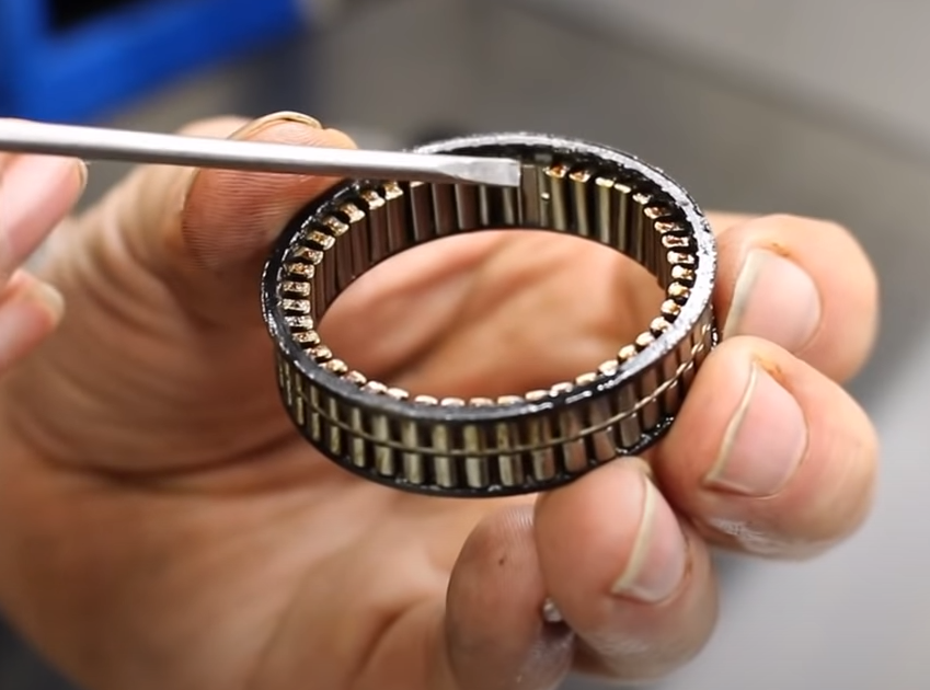

Oh ok, Is that the part you are talking about ? >
I had little knowings about bearings so I gathered some information about the sprag bearings in the Brose engines on different sources and found that "Performance Line Bearing" articles and videos is a very usefull source to understand the potential faillures of Brose Motors.
They dismantled so many Brose motors and the sprag clutch is a very common source of faillure according to them.
Given the fact that the bearing housing is made of plastic, a tooth can rotate inside the housing and cause the EXACT noise/problem that i have on my bike.
A sprag bearing involved in this kind of faillure (Not my motor, on this one, a tooth has rotated inside the housing)
That is the sprag clutch I'm sorry I was miss spelling it and calling it a bearing it's neither. The picture shows the defective pawl (at least I got "Pawl" correct). I've lost several drive belts until they beefed them up. What's outrageous is that Specialized is selling (millions?) of bikes with a glaring defect?

Update (Problem FIXED)
I picked up my Levo today after 3 weeks of immobilization, the bike is now perfectly quiet as it should be. It doesn't matter the terrain or what I'm doing on the pedals.
So it's confirmed it was coming from the engine (sprag clutch/bearings probably)
To be clear about the conclusion of the story :
- The motor remplacement was free (under warranty)
- The problem troubleshooting was free (covered by the warranty as well)
- The new motor feels more "solid" or tighter on the pedals and is quieter than the one I had before even when It was new. (it's like there's less gap between parts)
- In the past I occasionaly had some light rattle noises coming form the engine on very harsh terrains (even when my "old motor" was new), it's now completly gone.
So either my engine always had a fault that got worse over time and it took me some time to realize. Either Specialized gradually improves the motors on the production line over feedback. Both are possible :)
I'm back to riding (y)
(ohh one last thing: the LBS changed my wheel circumference to 2000 to get me closer to the US speed limiter, that feels SOOO much better on flat sections...)
Thanks to everyone here for the support & replies :whistle:
