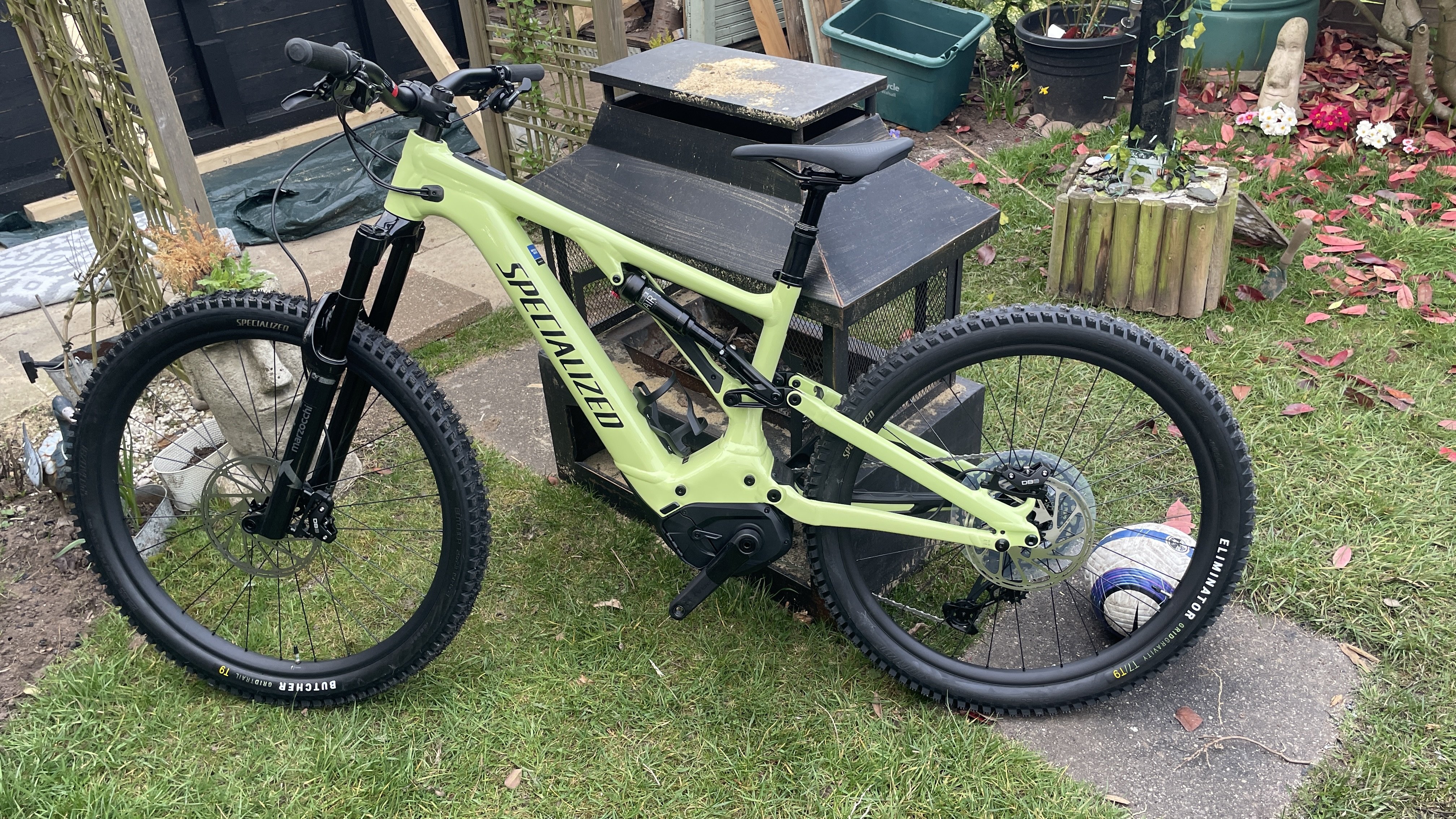

Hi all, yesterday I got my brand new levo 2024, find it very bouncy on the rear shock even when dialling the shock all the way in both directions? Are they very bouncy any way as Im used to locking out rear on firm ground When pedalling hard.

I still don't know what Bike you have, there are 2 alloy levos and none of them has a Air Bomber (marzocchi).
But Just Go there:

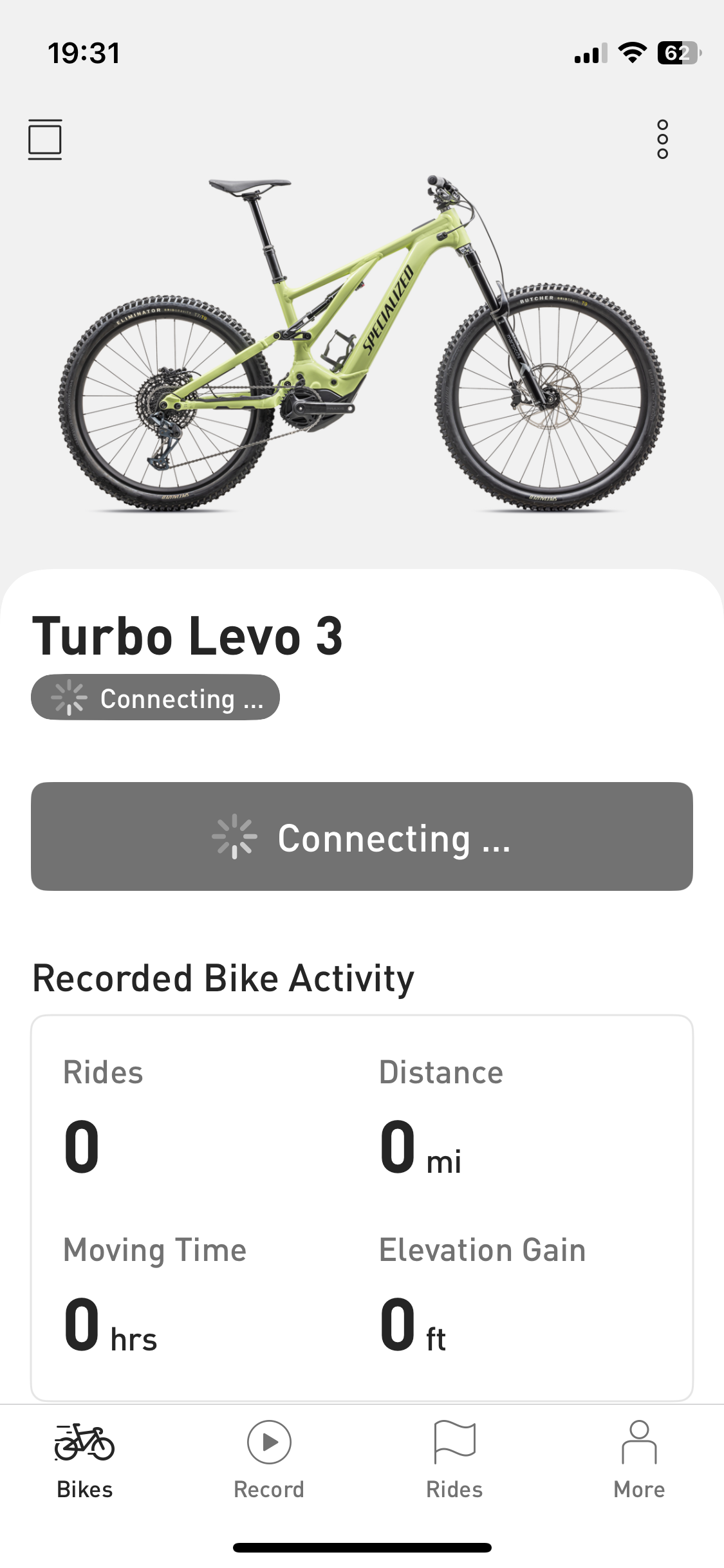

Not to sure it’s a turbo Levo 3 with Marzocchi rear shock as standard and Marzocchi Z2 forks as standard
