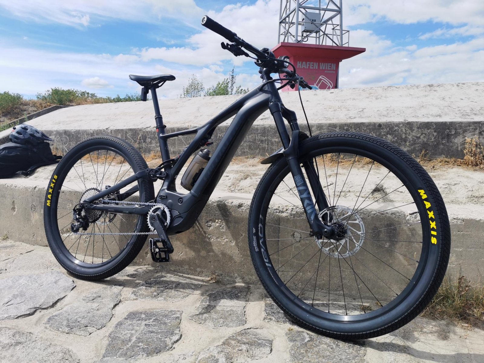

About a year ago I bought a set of Maxxis Grifter in 29x2.5 on discount for the sole purpuse of getting the 100 Mile Badge on Garmin Connect, it was a fun day but never put them on since...
