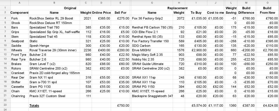

I bought a base model and upgraded. I needed to sell the parts to fund the new parts. They all sold quickly. Here's a spreadsheet copy of what took off, sold for and went on.

You did very well to get £275 for the Sektors!
So the cost was £4824 + the base bike (£4k RRP) so you paid £8824 less whatever discount you got on the bike RRP?
