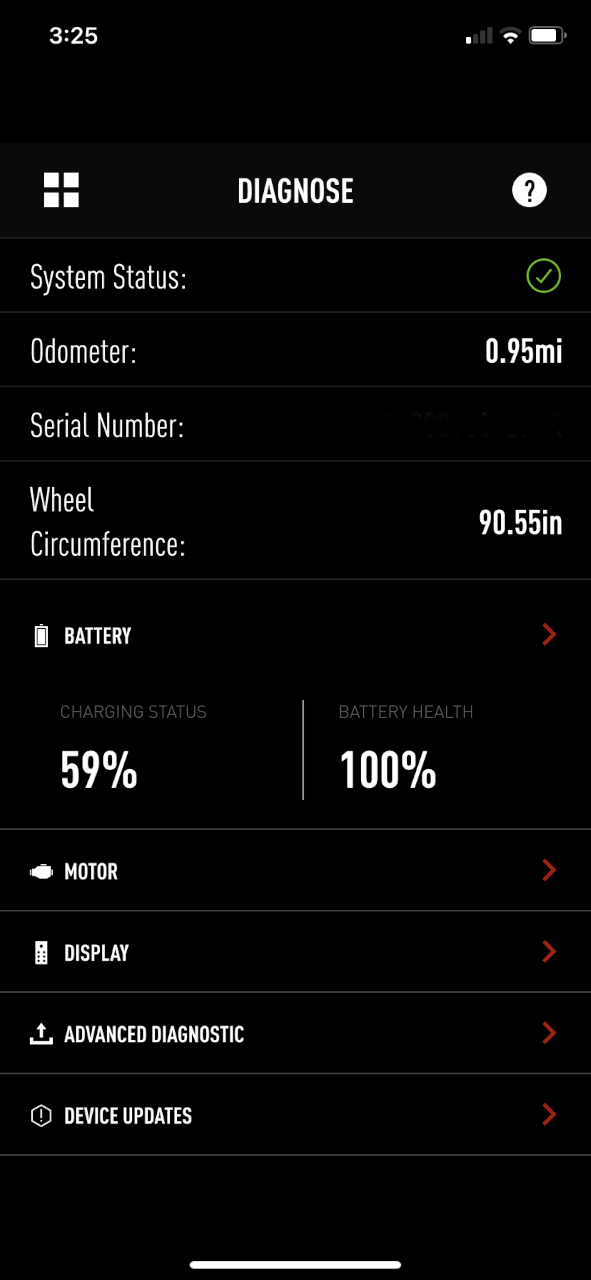

Just an update. Got the new motor! Reads 0.95mi! $25 warranty processing fee by LBS. Specialized stands behind these again! Very impressed. Very happy.
I have the latest motor firmware 7.4.2 which is supposed to help with belt life by eliminating torque spikes and smoothing power.
I also wonder if this new warranty motor is updated somehow? I don't know if anyone has been able to validate whether they are giving us warranty motors that have been redesigned to go longer? I'd be curious if anyone knows.
I also dialed mine back on response and a max power of 95% to maybe help as well. We'll see if I get more miles out of this one and by then I'll be close to the end or out of warranty. If it goes after that I'll have to see if Spec will cut me a deal on one, or send it in for a reman to Precision in the UK or crack it open myself and try to replace the belt maybe. IDK, I'll cross that bridge when I get there. Or, I'll sell this one and buy a new one before that time comes.
