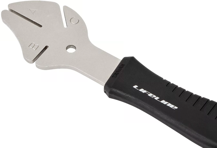

I have gone through 3 to 4 bent rotors now since I have had my Turbo Levo 2020. The rate of failure is increasing. Are E Bike specific rotors actually required ? I've been replacing them with regular ones
Absolutely not...loads of ways you can bend a rotor on and off the trails...I bend mine somewhat on a regular basis on the rough terrain I ride...I just bend it back with a wee rotor bending tool, there are a couple of brands you can choose from depending on price.
