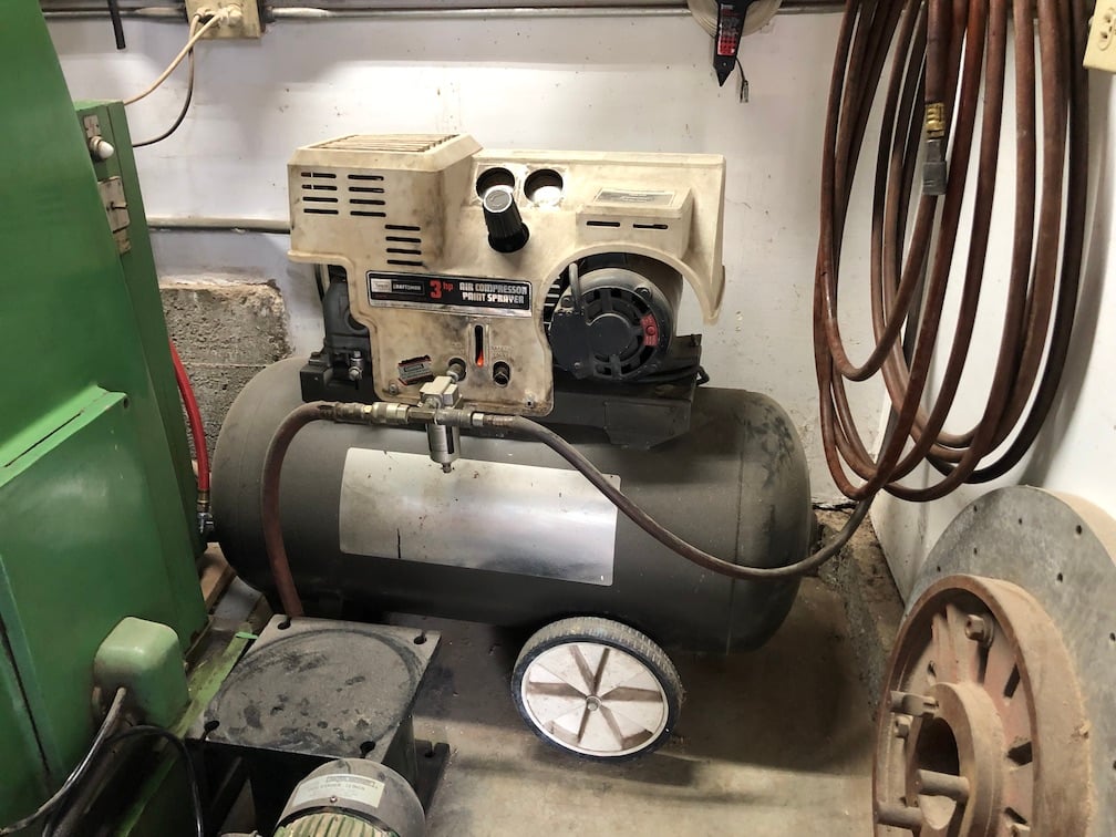

That reminds me of the olden days when riding in the desert. My "inflator" was an old Freon bottle. Refrigerant still comes in the same style bottles, and the bursting pressure is a little higher than a plastic soda bottle. But for doing work at home, I use a real compressor with a real tank. Even the Chinese ones are not too expensive. Or you can buy a good one and use it for the next forty years.

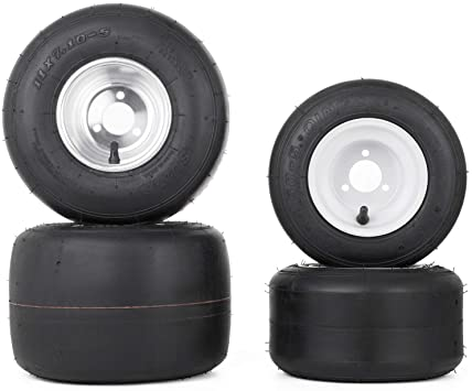

I used to race 100cc go karts a long time ago. You needed washing up liquid and a pretty good technique to get these little beasties on:
I've never had problems with any bike tyre!
