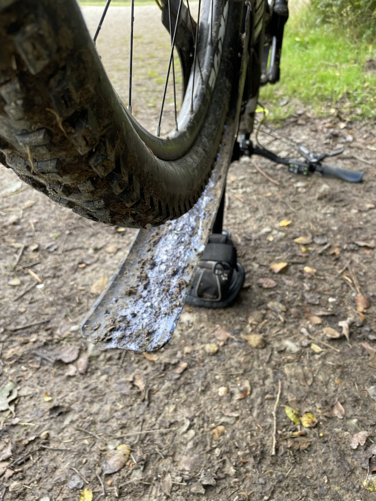

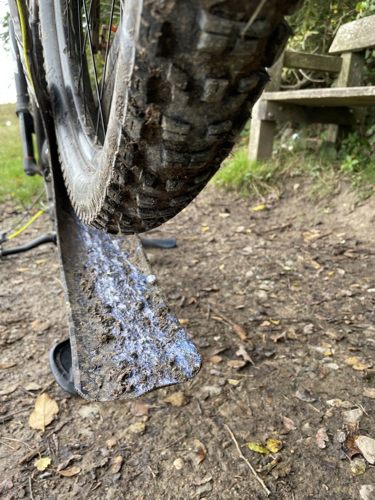

Tubeless is meant to be easy. 2 punctures, and both won’t seal! I’ve used stansdart in both and they both fly out. Think I’ll go back to Tannus armor, never had a problem with them.

My last unsealable puncture happened two days ago on an almost new EXO+ assegia. I somehow managed to hole out through the bead 🤬, and sidewall simultaneously. It looked like somebody milking a cow, it was spraying so bad.

I've just had my first experience of a loss of tubeless pressure.
Bought the bike 2nd hand from lbs who'd supplied it new to original owner.
Asked them if it was tubeless, they assured me it was tubeless ready but had tubes. I was happy with this as I know how to handle tubes ( 50 years experience - no idea of tubeless) . Asked them to Slime it ready for me to collect the following day. They assured me they had when I collected it.
Had the bike about 3 weeks, getting out on it once a week.
Last week noticed loss of pressure in front tyre. Inflated, went for ride, all fine.
This week, preparing to go out, noticed similar loss of pressure. Checked tread for thorns etc, nothing. Checked valve locking nut, got a hissing from the base of it and clear liquid shooting out. Twisted until stopped but slight hissing as i moved valve. Thought valve torn from tube so decided to change tube. Undid locking nut, touched valve which promptly dropped into the tyre!!!
Tyre glued to rim - suspect it is tubeless after all - having a wtf?? moment.
LBS having wheel in to sort out this afternoon. I want tube and slime, although the tannus solution looks favourable.
