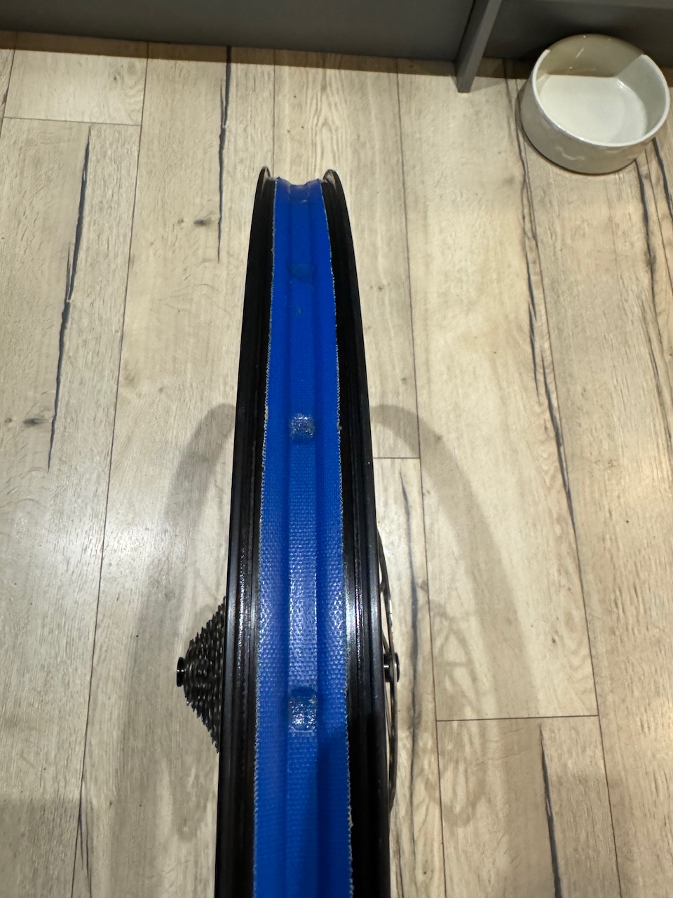

It’s been on a few days now and I’ve done 15-20 miles on it and all is ok. But I’m now starting on the rear wheel and can’t seem to get the muc off tape to follow the contour of the rim. The bike mechanic has just used what looks like blue gaffa tape? I’ve read mixed reviews on using gorilla tape but I do already have loads of it! Is there a better tape that’s more malleable? Here’s the rear when I first pulled it apart. Looks cheap and doesn’t cover the entire rim but it’s held up all this time!

That's too narrow to get a long lasting seal.
I use wider gaffer type tape and fit one edge against the edge of the rim whilst cutting the overhanging side edges so the tape can go round the rim. Then Stanley knife the cut side of the tape into the edge.
It sounds complicated but easy enough once you get what I am trying to explain 🤔
You could even leave the blue tape on and go over it as it looks like a good fit only not wide enough.

The blue tape has been on there 2 years. This rear one hadn’t even gone flat, just re doing it anyway. I didn’t take any photos of the new muc off tape on the front but it’s 30mm tape on a 30mm rim. I have some 50mm gorilla tape but you can buy it 25mm and my mtb’s have 25mm rims. Is gorilla tape going to do the job just as well as any rim tape?

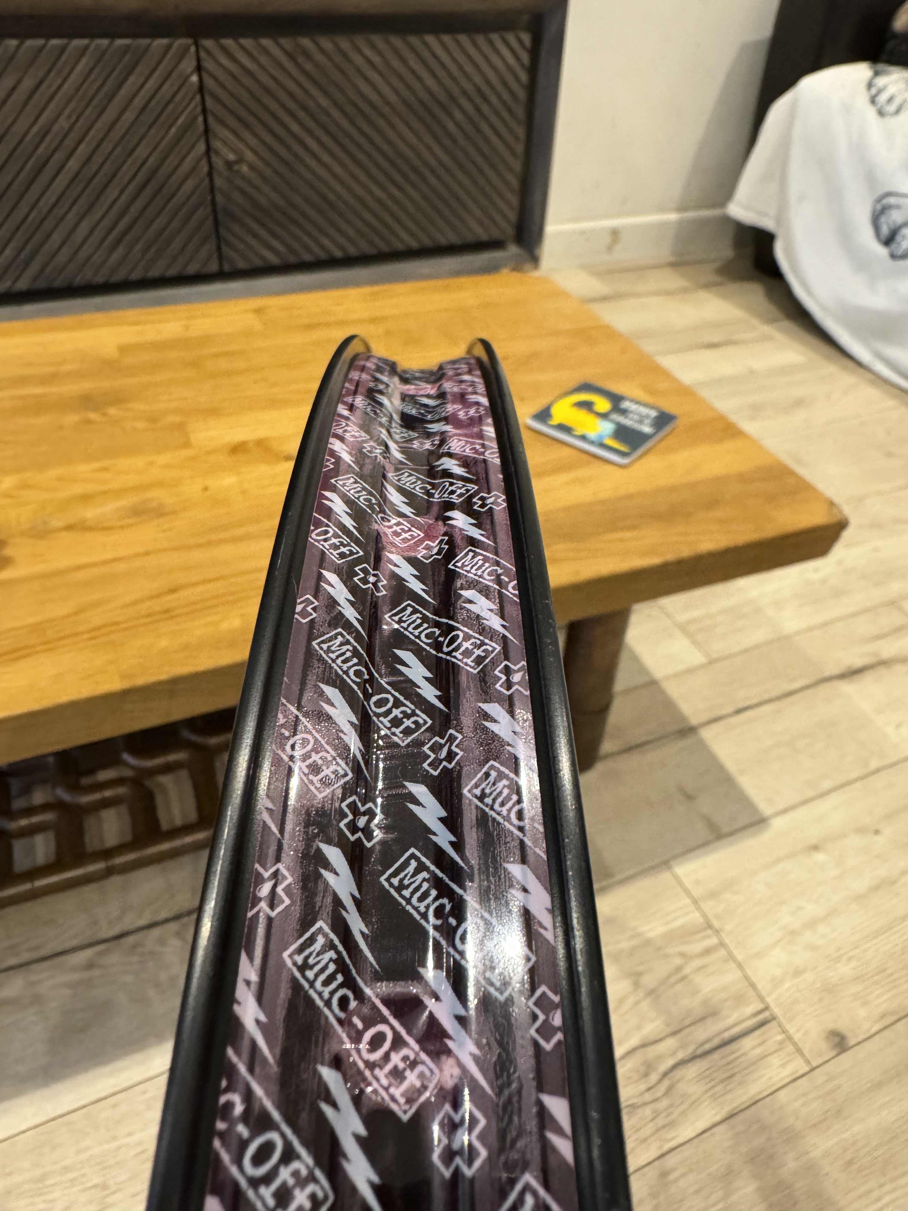

So I got it down this time. Took a hell of a lot longer!
Got into my groove about half way round. Laying it down taut and working into the edge of the well with my thumb nail one side at a time, going from spoke to spoke. Then going over the centre with a microfibre and finally go around the edges once it’s all on. There’s a few tiny air bubbles but hopefully they’ll work their way out with some pressure in tyre.
I’ll be interested to see if this holds out any longer than the front, which was so much quicker just stretching really tight and spanning the well.

That looks like a nice job that you should be able to rely upon. I wouldn't have a lot of confidence in the front, as you described it. Personally, I never "retape" a rim unless there is a compelling need to do so. The blue looked fine, and it sounds as if it held up well for a couple years.

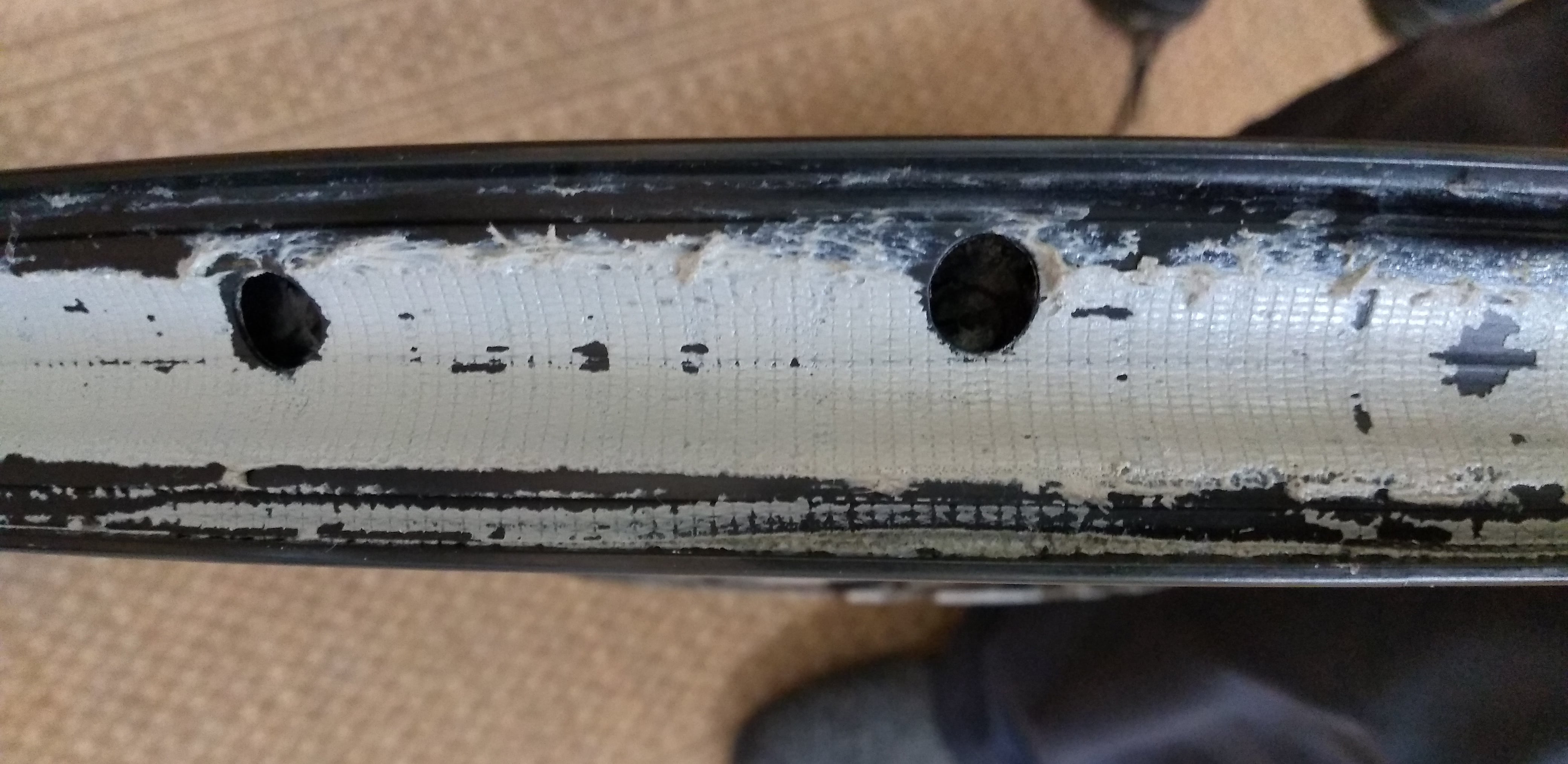

I used to swear by Gorilla tape and recommended it to all and sundry. Easy to apply, looks great and very effective, what's not to like!
That is until I could not get my tyres off! The latex sealant in the tyres had reacted with the Gorilla Tape adhesive and glued the tyre to the rim! It took two experienced guys at the LBS to remove the tyres, and it took them ages to do it. It left them with aching hands, despite using special kit. They left me with rims that were covered in a thick layer of GT adhesive and it was very troublesome to get off. The adhesive would stick to anything that touched it. I had tried all the solvents that I had in the garage, all without effect. I phoned the GT maker in the USA and they refused to tell me what solvent to use, despite them no doubt using something very effective on their production line.
To cut a long story short, take the rims outside and soak a rag in petrol and rub away at the GT residue. After 30 secs or so it suddenly softens and can be wiped off. See before and after pics.

I had the same problem with the residue tape on the first one. Took a good hour to clean. With the second I was much more careful to peel it back on itself and it came off quite clean. I think it helped that the edges weren’t rolled up like the first one.
