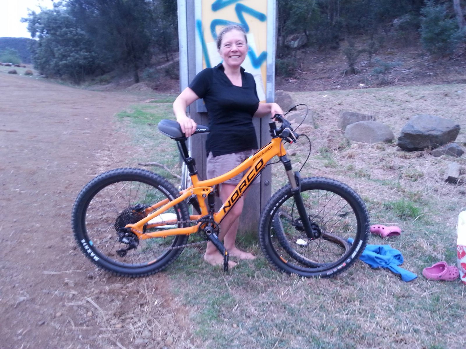

My partner is 4'11". She wasn't really a bike person - had one but she was never at one with it and therefore didn't really feel the passion. I put my researcher's hat on years ago and concluded a good 24" bike. At the time a good 24" was rare. Kids bikes were usually budget bikes. Found a good hardtail and she is all over that bike front to back and side to side - she works it. That bike has since been set up for urban duties with schwalbe table top tyres. In the last few years some great dual sus 24" bikes have been showing up, although some of them are not very well thought out (160mm suspension :eek: etc). She has a burly dual sus with maxxis minion dhf 2.4 tyres - not long on the market. Everything is pretty much to scale for a small person - crank arms, suspension etc. Likewise she is all over that. Because the bikes are the right size for her, they are set up properly. What happens with small people is they end up on a bike with the handle bars too high because they won't go lower - a restriction imposed by the larger wheels. Also, you only need 100mm suspension which is stacks for a small person. I think the gearing is generally too high on mtb bikes, so the gearing should be fine. The photo below was early days - getting the cockpit etc right. It's has a different seat, fork stem is cut to size and a longer dropper. She can get her bum hovering over the rear tyre like the rest of us now. Unfortunately there is nothing like this that I'm aware of in emtb yet - but it will happen. Good luck.

One other option, considering the changes that you're considering :oops: - sell and buy something closer to the mark? Although this is still a few necessary changes too. Giant has a new emtb ht with 26" wheels. I don't think it is well thought out, especially considering it is aimed at youth. It isn't geared anywhere near low enough unless you live where the hills are mild. It has an 80mm fork - forks at 80mm really are cheap junk. If it was for my partner I'd go high volume 2.4 on the rear, high volume 2.3 (both minions) on the front. Good xc 100mm forks - this will bring geo back in line with the taller rear tyre and they will be night and day difference. And a seat dropper - if your mum is older she will appreciate it just getting on and off. I'd have to change the gearing too to 32 front 48 rear - that's for here where it is steep and technical.
Oh, haibike have a similar thing too which would be my pick if I lived across the pond. 24'' wheels, better gearing (smaller chain ring, smaller rear wheel), but could still go lower. I'd still replace tyres, fork and get a seat dropper. It comes with schwalbe table top tyres - a great tyre for commuting and light off road. You can get a minion dhf 2.4 for the rear (high volume, good roller) and a dhr 2.3 (for consistent lean - it doesn't have that "no man's land" that freaks newbies out) for the front. Those tyres would give you as much confidence on fire roads as you could get from tyres. The dhr with open blocks would handle steering in the gravel about the best of what's available for 24".
Geez, things are looking good for smaller riders, another 24" ht; the best yet! I'd put a smaller tyre on the front still (DHR 2.3;), and keep the original front as a replacement spare for the rear. Over biked; 140mm fork, 180mm brakes, and it comes with a dropper! 10 speed but could still go lower; a 32 on the front would help a bit. This would be the best match for your dad's bike and minimal changes (chain ring and a tyre). Also, being over tyred and over braked will make it easier to control with less effort. From my own experience with my partner - she would be all over a smaller bike. You can only do so much with a bigger frame and bigger wheels. I did try that initially for a few years (xs bike with 26" wheels), but when we got the smaller bikes everything changed for my partner. For example, she rides down steps now when riding urban - she never would have considered that before mainly because she couldn't get her bum down low and back enough (frame too long and too tall).
