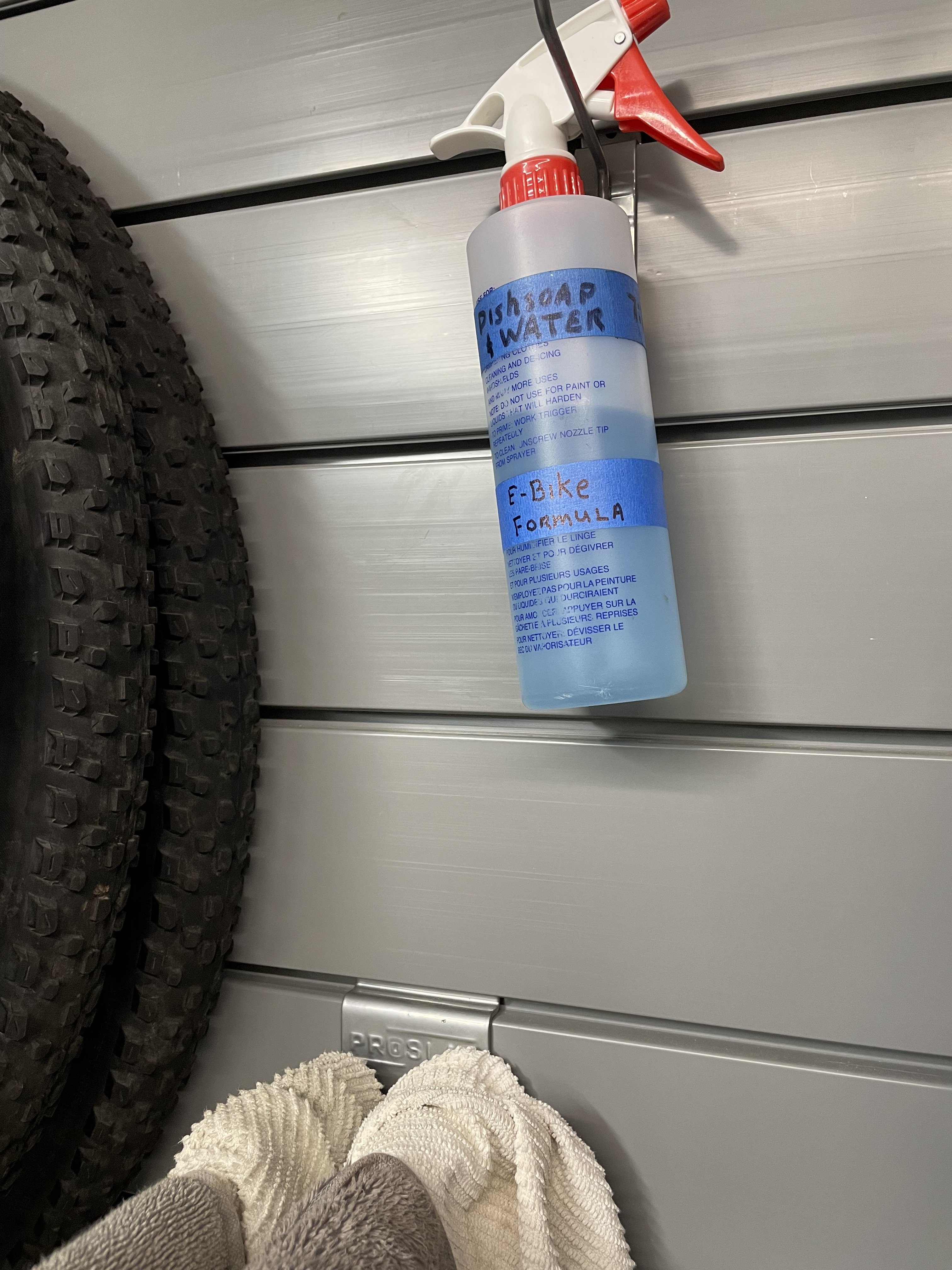

A spray bottle with a dishsoap/ water mixture may help. IMG_6191.jpeg
The original Bontrager wheels can be problematic. If air bubbles are occurring on the rim then the plastic rim seal could have a very small hole in it. I have found that any amount or type of sealant will not stop this slow leak. I eventually used proper rim tape and applied it myself. Problem solved.

A spray bottle with a dishsoap/ water mixture may help. View attachment 125821
Thx Stihldog. I'll give the wheels a spray. I know I can locate the leaks myself but I shouldn't have to if I bring it to a qualified company owned Trek shop! I wanted them to convert to tubeless and then I can do it myself there after. I've read these Bontrager rims can be problematic, so I figured let them do it the first time incase they also need to be taped.

When I first got my Rail it came with tubeless ready Bontrager rims and tires. Suitable for my use at the time but I soon wore out the tire. I installed a set of Pirelli tires (f/r) suitable for the terrain. The rear tire needed a slight psi top up each time I rode(daily in the mountain). There was an extremely slow leak in the tire but sometimes I could ride for three days before I had to add psi.
I wore out that tire soon and eventually switched to Maxxis Assigia. The slight air loss persisted. I then decided to go on a search for the source of the problem. Armed with the special “e-bike” soap and water formula I removed the wheel and methodically sprayed every inch or possible source … and watched carefully.
There it was. Extremely small bubbles at the rim drain hole. Easily missed if the soap/water formula was not perfectly applied. I couldn’t understand why the air wasn’t escaping through the spoke nipples or valve. There had to be a few reasons for this, and I eventually found it.
Bontrager wheels were using a plastic rim ring rather than rim tape. Bontrager’s sealant likely sealed well but the plastic rim ring had one very small tear where a spoke hole is. Almost impossible to see and behaved like a flap with different psi or sealant. Any air that was able to escape through this ver small tear would exit slowly through the rim drain hole.
My solution; I used a proper width rim tape. Carefully applied. I mostly use air to breathe now. 😉 🧘
