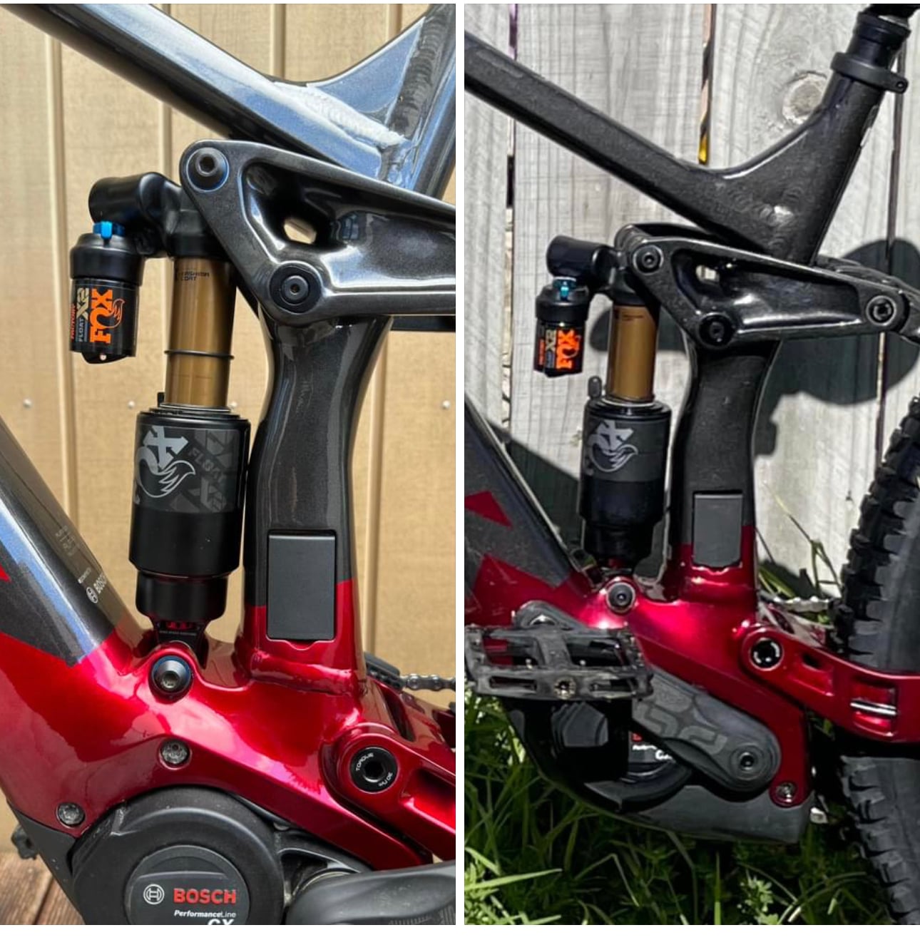

Hi Guys,
My frame cracked weeks ago and was able to receive a warranty frame. I got a Large Trek Rail 7 btw. The LBS transferred all my components to the new frame but for some reason my Fox X2 which used to fit with plenty of space from the frame is suddenly hitting the new frame and there is not enough clearance anymore.
I returned it to my LBS (Evocycles NZ) and they tried to find what’s happening with the new frame and they said the issue is with the frame and they will be happy to just attached my stock shock (Not Fox X2) as that fits with no issue and there is a big chance Trek will not send a new frame. Basically just move on and accept it.
That does not make sense to me as the new frame should have the same measurements and should have the same clearance. I few millimetre closer but still with clearance would be fine with me but this thing has no clearance at all and I’m getting the impression that they just want me to accept that. I didn’t agree with it so they will contact Trek again.
Has anyone experienced this as well? And anyone from Trek in this forum that I can reach out to?
Picture for reference, New frame on the left and Old frame on the right. Notice the clearance.

Not an ideal situation @GlassKnee and I'd be pretty unhappy if I were in your place, but as @JP-NZ says the difference is in the rocker...if evo can't or won't give you the rocker from your original frame it should be possible to source one as a spare part, obviously an unwelcome extra expense but if you really want to run the X2....

Different, longer, shock. Aircan sticker in not the same.
Lbs has probably accidentally mixed someone elses shock there.
OR
The picture on the left is taken with a potato/zoomed in so much the sticker craphics blend to an even gray mess. Which then would mean there is a slight variance in manufacturing tolerances and the seat tube location is Off by few mm.
If the shock just slightly kisses the seat tube when fully extended, i would not give a damn, but if it touches properly and extend after touching and starts bending, then it will not probably last long.
You can figure out how much it can touch by taking the shock and trying to bend it and then you see how much play there is in the shock bushings by default (seals keep it centered)

I hope you get it sorted but i can see Trek saying that you have a non standard shock and its your problem for fitting it,
Harsh but i would bet thats the way this will go.
13,998
20,749
Only going by the pictures, but on the "new frame" picture the shock appears to be extended further than the "old frame" image.
As the shock is connected to a pivot/linkage, then the more extended the shock, the closer the shock will move to the frame.

Hey Guys,
Quick update, Evocycles(NZ) tried to replace the rocker with the old frame and still same results.
Rear shock is still 230x57.5. Same rear shock in my old frame and was not swapped with someone else’s shock.
Hits the frame in high or low setting. This does not make sense as it restricts me with the rear shock they provided while everyone with a large trail will be able to change theirs.

It might just be my eyes playing tricks on me but it looks like that area near the shock can is beefier than than the old one. Maybe they beefed up that area in the newer frames since that’s where they’re all cracking.

@GlassKnee have you checked if the mino link configuration is the same across both bikes? It could have been in the high position on your old bike and now the new frame is in the stock, low postion?

They have made changes in the geometrie. Seat tube have a slightly diffrent angel. Messure the frames and see.
Its a produktion tollerance change.. But anyhow, your clearens with the old frame is not enought eider.
And X2 is not realy meant to be on an E bike. Also I guess you retuned the damper buildup as the link ratio does not match with any of the stock X2 tunes.
Go for a flot X E prepared or a rockshox

That linkage is DEFINITELY at a different angle and orientation in those two pictures. Figure that out, and you have your solution.
