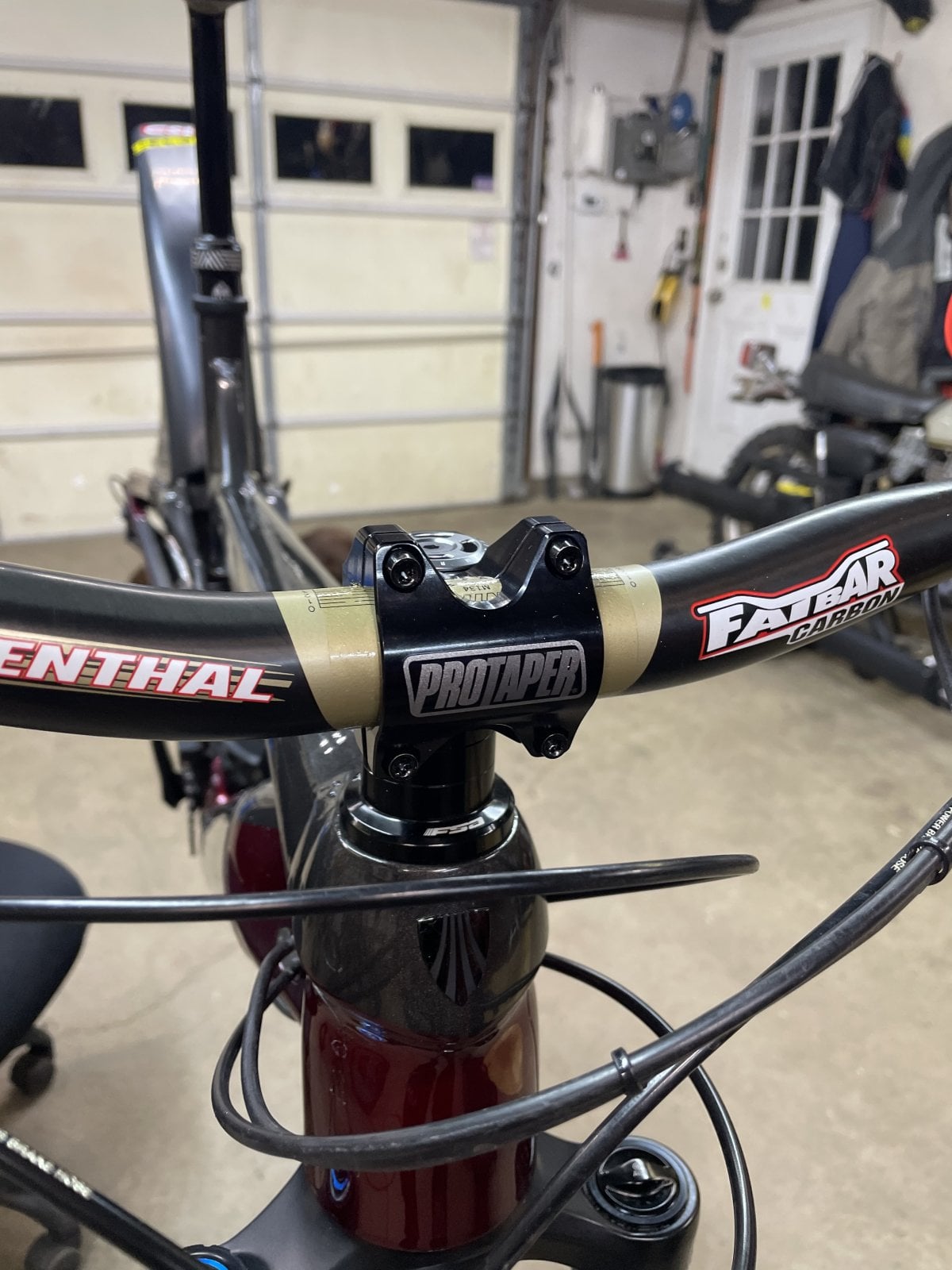

60/50/30 then settled on a 40. Xl rail 7

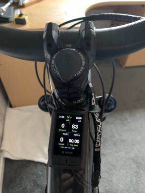

My XL came with a 60mm stem. Changed to OneUp bars and 50mm stem.
Took a bit of getting used to, but overall I do prefer it now. I probably wouldn’t go much shorter though.
On the first ride out it felt like i was hanging over the back a bit more when standing though berms, i do enjoy the feeling of siting a bit more upright when pedaling though.

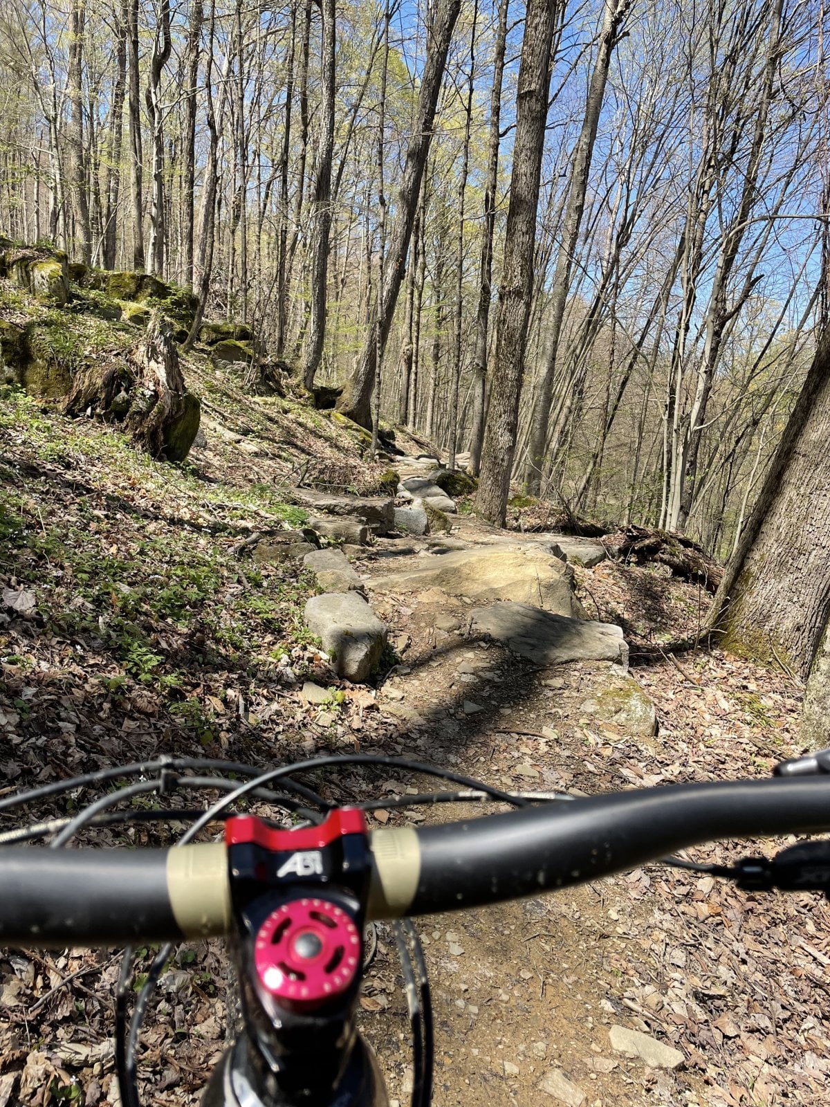

Has anyone put a much shorter stem on their Trek Rail. E.g. 35mm or less? How did it affect the handling?
I went from the stock 50mm on my L Rail 9.8 to a 32mm and love it. At 5' 10" I might be better suited for a medium, but the shorter stem makes the bike feel perfect, now. Haven't noticed much difference on the climbs and I have more control and flexibility while descending. Plus, I like the way it looks.

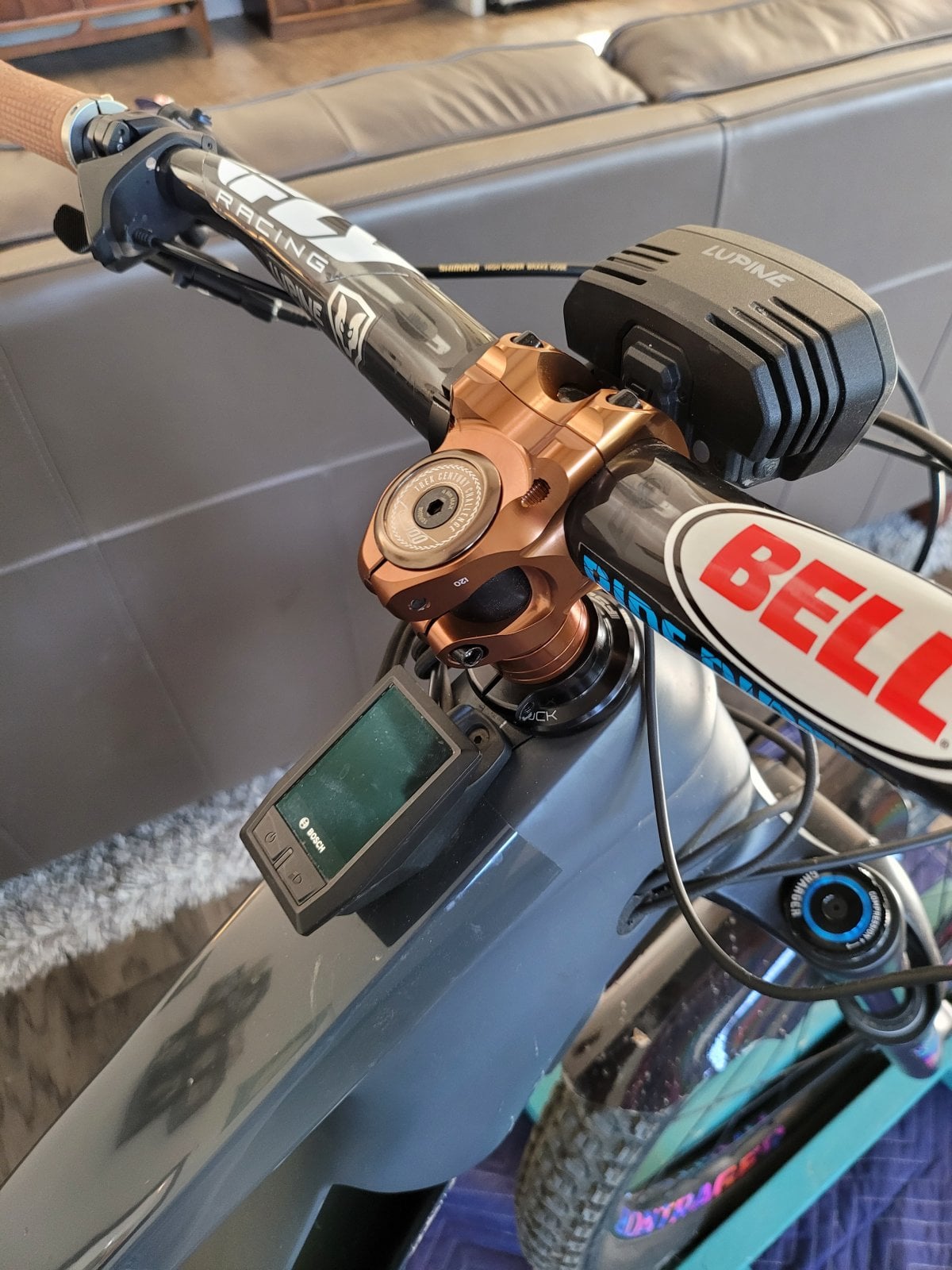

Is that the turbine r stem? What spacers are those?
