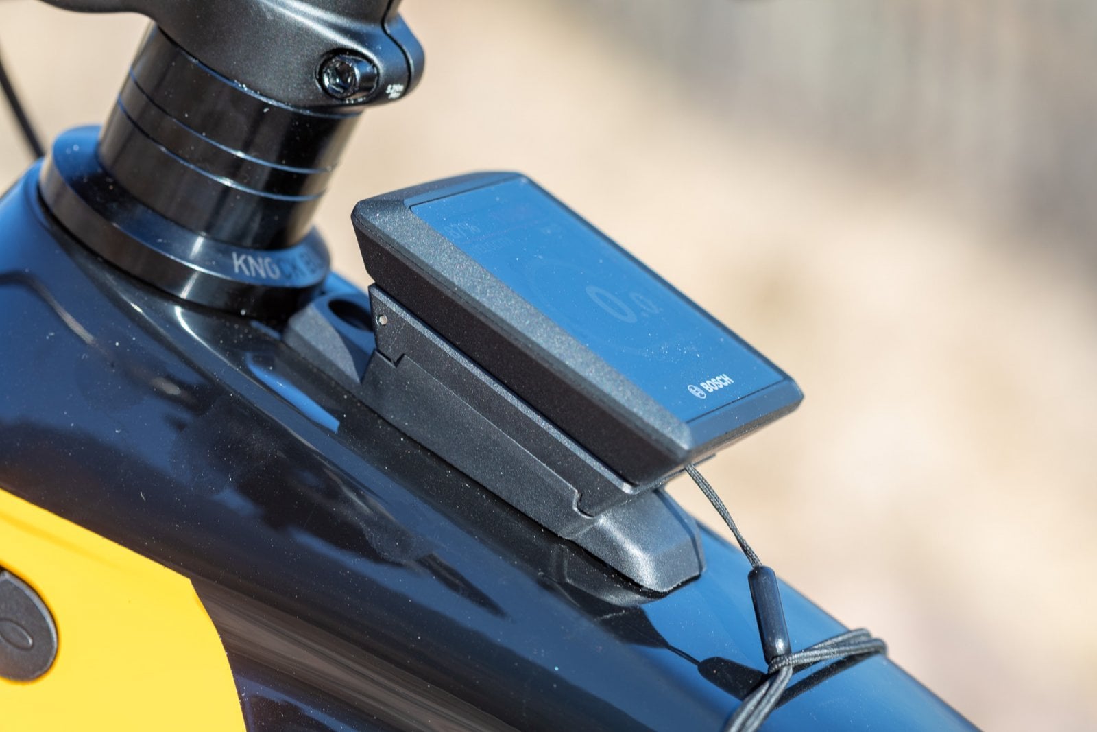

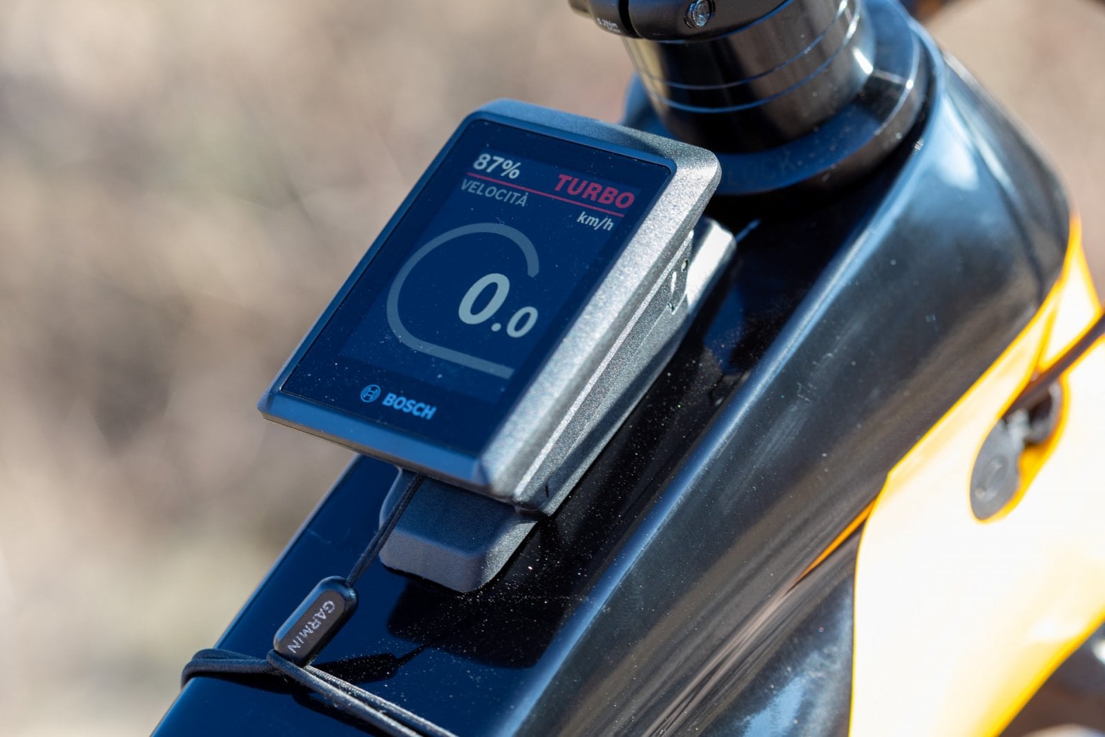

I was talking to a gentleman on the trail who mentioned he'd done the upgrade. He recommended getting a camera strap for the LCD display to keep it from flying off into the bushes, as its just a magnet holding it on.

There's also a place in the back for a small screw, it won't come off at all then.
Also to note the new LOCK security feature when setup wont work until the KIOX is removed from the bike. Like when locking it away. Take the KIOX off the bike with this security feature and the bike will not work, it locks the motor. (fitting another KIOX docent bypass it either).
A lanyard to is also advised when out on the trail, just in case though ;-)
