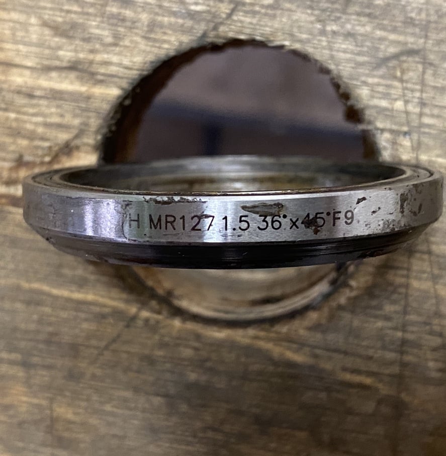

After 1200km and mainly stored and washed outside the headset bearings of my Trek Rail has come to an almost end. The lower bearing doesn't seem to have any protection from weather. When I bought the bike I opened all bearings and filled them good quality grease.
I think I'll clean the headset bearings and put new grease when I service the front forks.
Will update the bearing details here for future use. Here's just an example picture outside the lower bearing
UPPER
TH MR122 1 1/8" 36'x45' R9
41mm x 30,2mm x 6,5mm
TREK OEM-CODE W531676 11,99 EUR
BOTTOM
TH MR127 1,5" 36'x45' F9
45mm x 38mm x 6,5mm
TREK OEM-CODE W532843 13,99 EUR

I updated the sizes to the first post.
I just relubed it went riding. The local Trek dealer was able to order them if needed but I'll change them later when I service the fork.
The problem here is, that the OEM front fork was Rockshox Gold 35RL and it has much more coverage for the lower bearing than my current Cane Creek Helm MK1 coil.

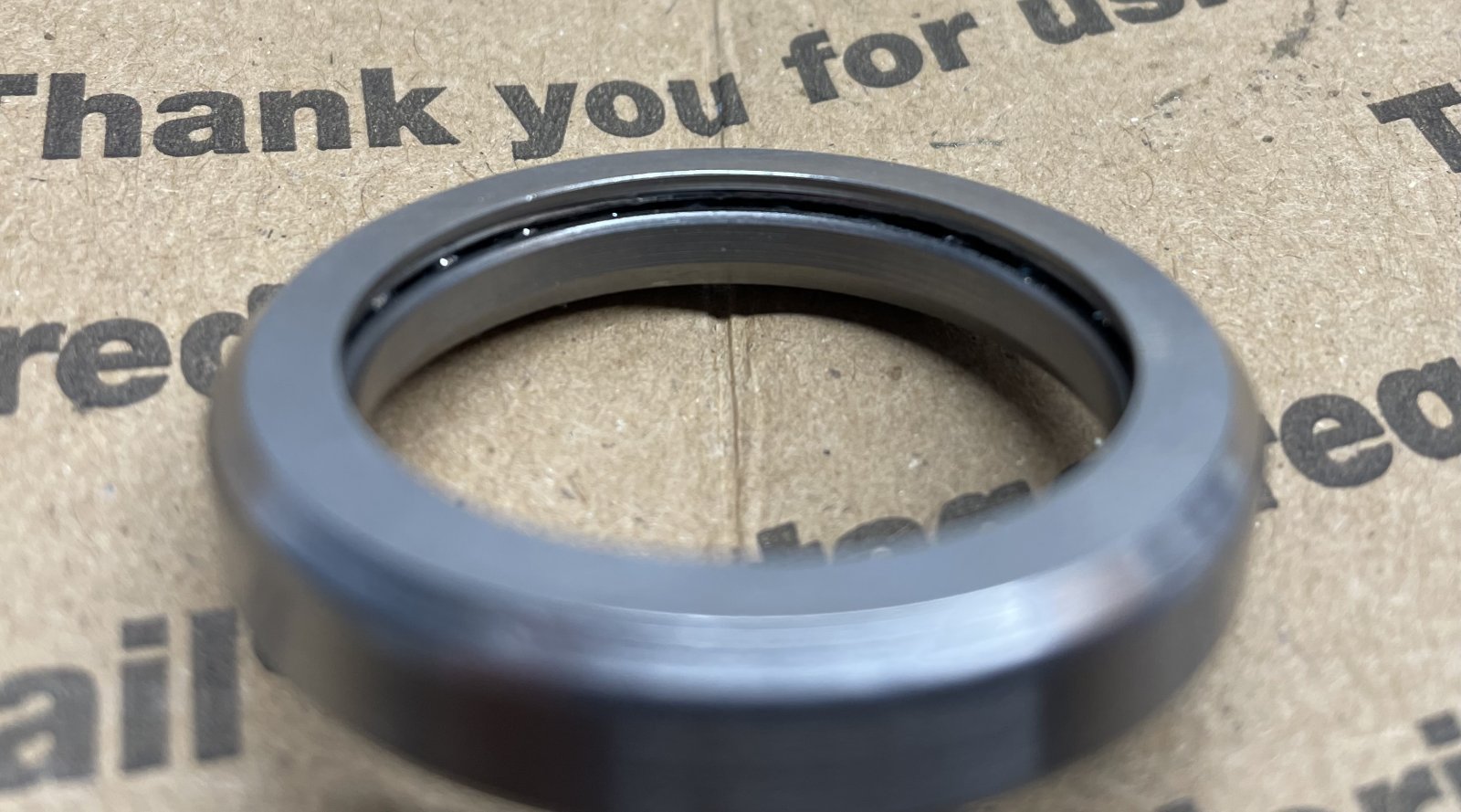

I checked my headset recently, they look like sealed bearings to me...
There is a seal but the stock bearing is not totally sealed.
In the pic below, the individual balls are just slightly visible.
This is why I suggest packing grease into the ID of each bearing. Or, replace the bearings with something like Cane Creek Hellbender.
