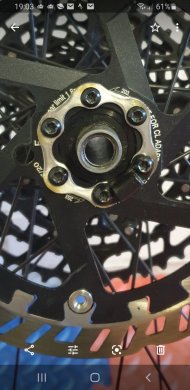

Silverdaz888
Dec 27, 2020
York, Yorkshire
Had exactly the same issue when I fitted Magura rotors to my 5. Had to do this little hack using a old rotor and reusing the original steel bolts instead of the alloy ones supplied with the new rotors.
