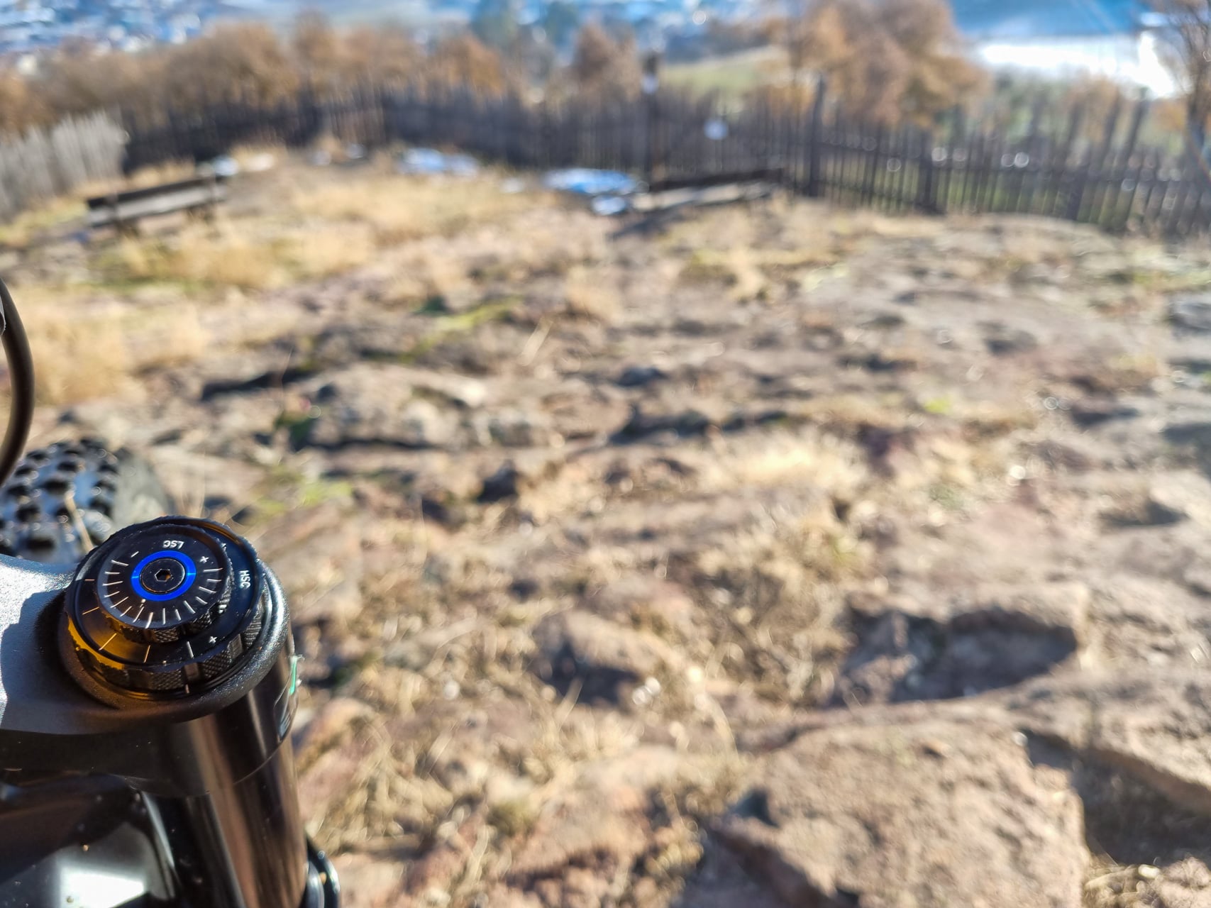

I did today the first test ride unfortunately on trails not in perfect conditions (snow, wet leaves, etc.)
I don't know if before I had a bad fork, or maybe if it's a placebo effect, but now it seems another Zeb!! Plush as butter!! It remembers me when 10 yrs ago I changed my orrible Fox Talas with a Pike, same level of upgrade!
I'm very light (52Kg naked... maybe 53 in these days of italian Panettone and sparkling spumante!), so I have only problem to find sensivity on small bumps and low speed because I cannot go down too much with air pressure (the manufacturer of Vorssprung told me they did special setups of very light women, because forks are built for average ~70 kg rider). But now even with more pressure (I had to go up 6 or 7 psi) as before I pass over roots and small rocks like a cushion.
Maybe I will try with a token (now I'm without) to see how it change, even if the mid support is still good with zero.
The only doubt is that it "eats" a lot of travel (1 cm ore more) when stationary and sometimes I found it with sag close to 10% without me being on the bike (basically it doesn't fully re-extend). Can it be a bad assembly of my shop?
If it was a drawback to have it so plush, I would keep it like this without problems, only having known it beforehand I would have bought the 170 shaft instead of the original 160.
Even my carbon rims, thanks to the buttercups, seem less harsh to me, but here maybe it's really placebo!!
However delighted and a nice gift from Santa! Merry Christmas to all.
