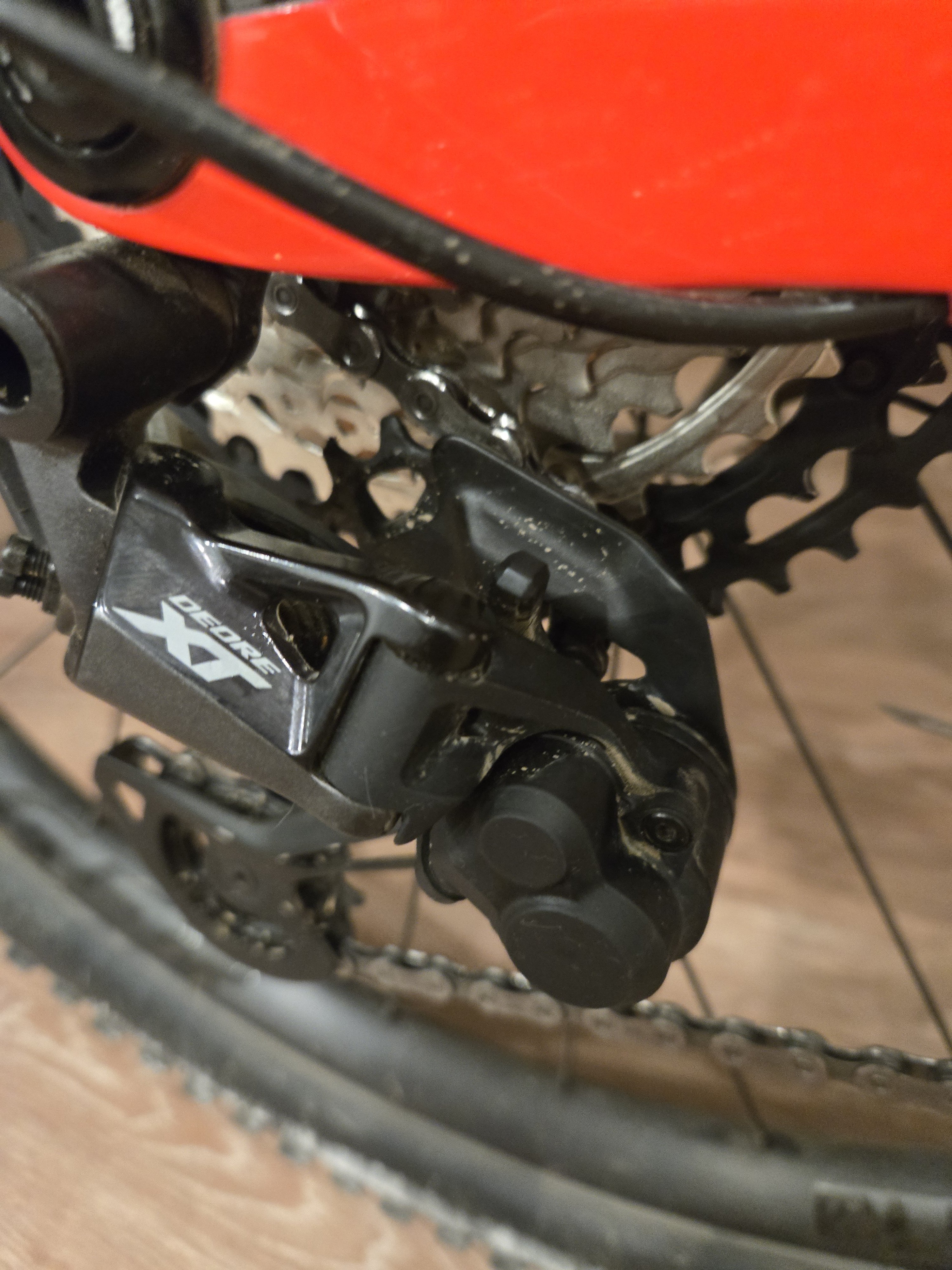

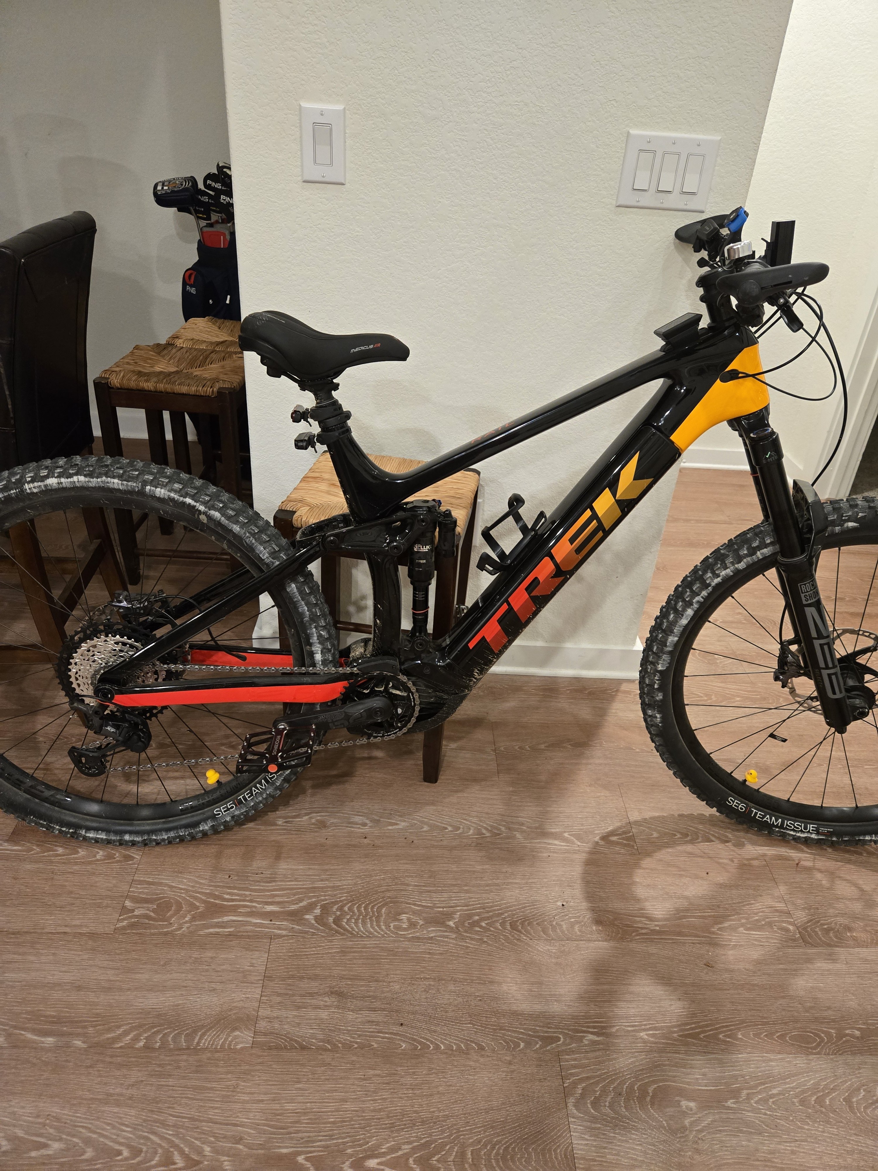

Bought my Trek Rail 9.8 XT in July, and have put about 160 miles on it so far. During this time I've had two problems: persistent creaking noises from the motor area, and now some slipping in the transmission. After a couple weeks at the bike shop, the creaking noise seems resolved (LBS said he removed and reinstalled the motor and noise went away), so this post is focused on the slip.
Symptom: on my last two rides, 30+ minutes into the ride the transmission would occasionally skip and make a loud clunk I could feel and hear. I haven't been able to see it in action, but I think the most likely explanation is chain slippage. Here's what I know:
  1. I've confirmed it happens in the top three gears (smallest sprockets). Not sure if it happens in any lower gears, but don't think so.
  2. It seems to happen most often in the smallest sprocket.
  3. The sprockets themselves all look fine, but Shimano sprockets have sorta funky tooth shapes, so it's possible I'm missing something.
  4. I generally can't reproduce it when I try. For example when riding around the street in front of my house.
  5. Shimano XT 8100, less than 175 miles on everything.
  6. I haven't checked the chain for wear, but that seems unlikely given mileage. My chain wear tool should arrive soon and I'll double-check.
  7. The bike shifts fine. In fact, better than any prior bike I've owned. No phantom shifts, no clicking as it hunts for the next gear, nothing.
  8. The slippage/skipping occurs when I'm pedaling relatively hard and not shifting.
  9. I do almost all my riding in Tour (eMTB-lite) and eMTB modes. Pretty much never use Turbo.
  10. I'm a careful shifter, and try to never shift under load.
Any suggestions on causes and ways to debug? Are there potential explanations other than chain slip? Something in the hub?
Another thread suggested the B adjustment screw as a potential cause of chain slip, but that screw is already backed out all the way, and appears to be adjusted correctly according to Shimano instructions. I also noticed the clutch switch was "off"; I don't know if that could causes slippage but based on descriptions of this switch, it seems kind of unlikely.
I might add that I reported this problem to my bike shop when I took it in for the motor creaking, and their tech said he "adjusted the derailleur", but on yesterday's ride the problem occurred again. In addition to the clutch switch being left off, I also noticed today that the derailleur cable attachment wasn't clamped correctly (the cable was not routed through the U-shaped guide), so I'm not super confident with my LBS.

Hanger alignment
B-tension screw
As mentioned above, I did check the B-tension screw, and it is adjusted correctly according to Shimano docs: the largest sprocket teeth are lined up with the derailleur markers.
I've only checked the hanger alignment visually, but it sure looks perfectly aligned to me. And since the bike is just a couple months old with no crashes or spills, and it shifts great with no noises or hunting, a misaligned hanger seems like a long-shot. But I'll try to double-check, anyway, next time I have a chance.
Reading more about the Shimano Shadow PLUS clutch mechanism, I'm hopeful that maybe part of my problem was having that switched off. I mean, the chain shouldn't be slipping even without it activated, but maybe having it on will keep the chain tensioned enough to avoid the problem.

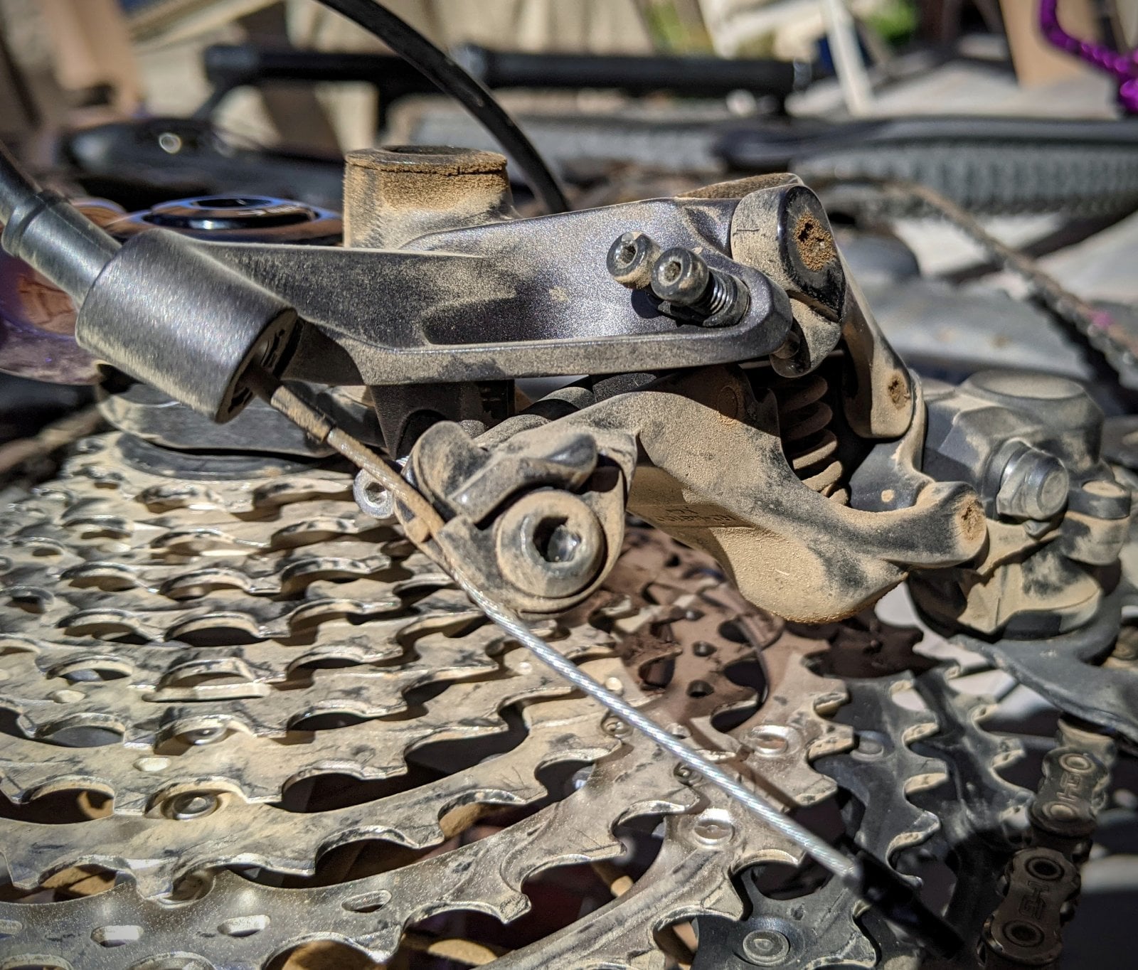

Derailleur hanger needs to be straight. They never are. New hanger, new bike doesn't matter. It needs checked.
edit. You can't look at a hanger and "see" if it's strait.

+1 for a proper hanger check, I bought the Park hanger alignment tool a few years back as it’s almost always not straight if there’s a gear issue.
