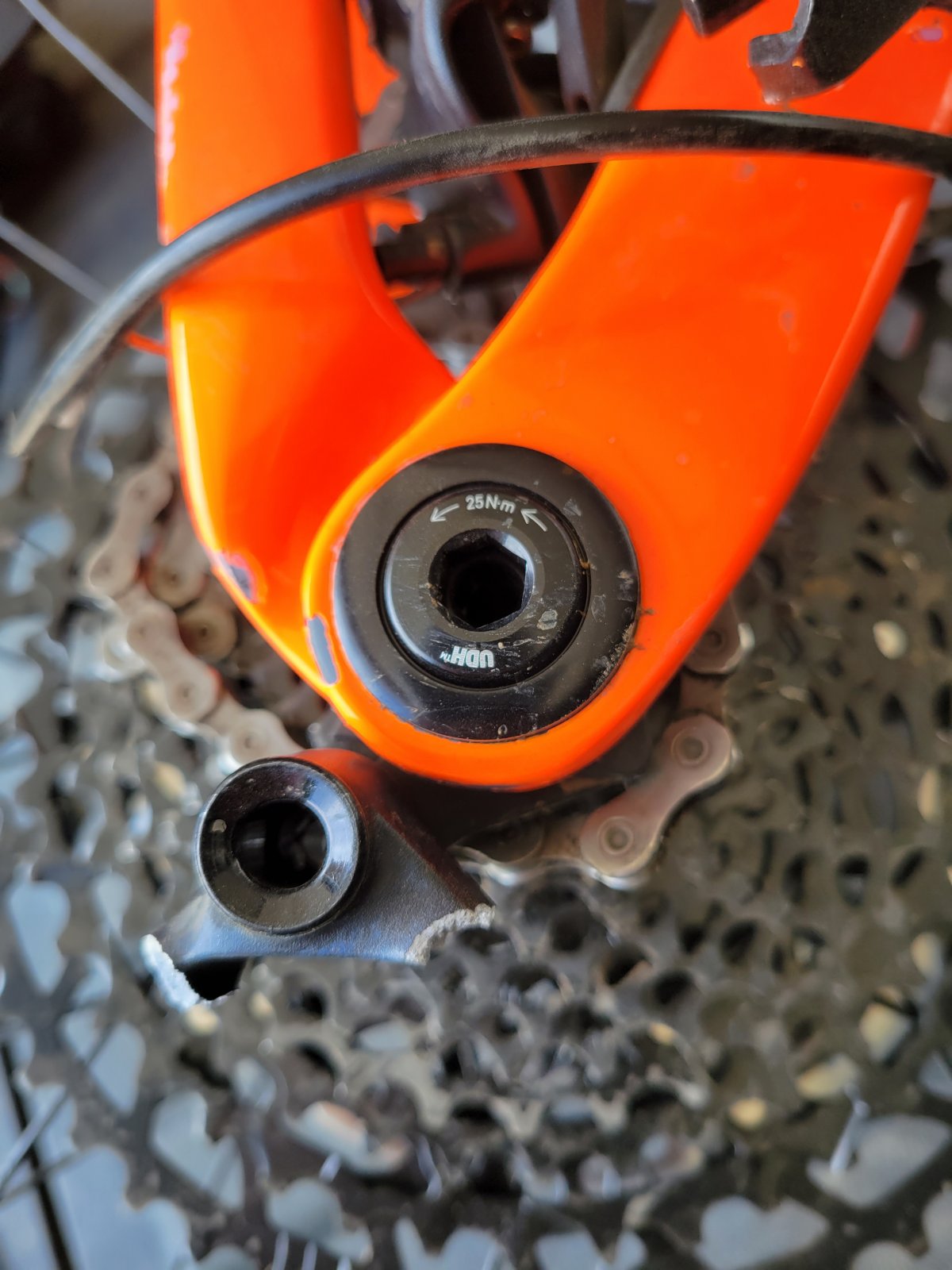

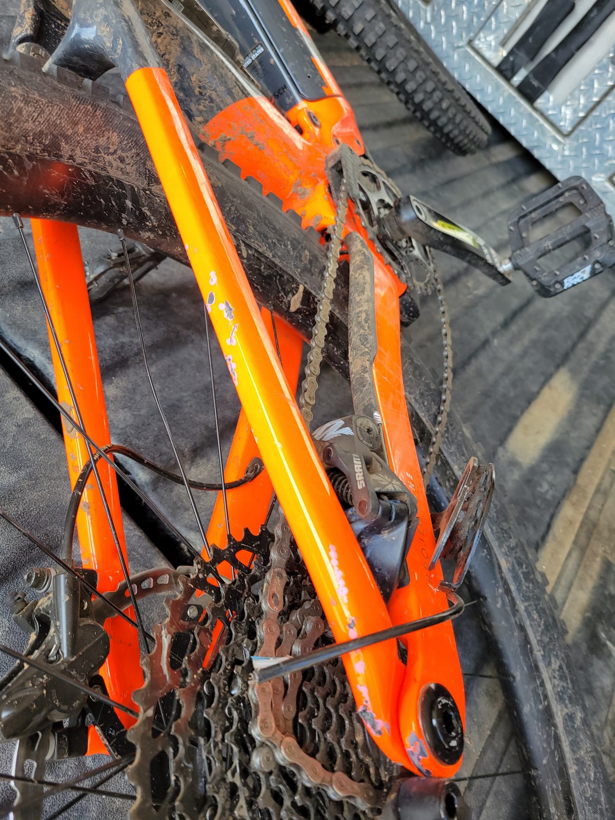

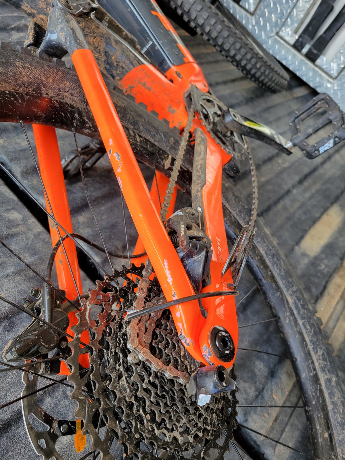

I have an interesting issue with my new 9.7 in that my NX deraillemur disintegrated in the first 100 miles. I was riding last weekend, no rock strikes but went through some brush. No issues for almost 5 miles and then the clutch failed and the locking pin fell apart. I was 7 miles from my truck so I limped it back most of the way but on a downhill section just coasting, the chain or something caught and ripped the whole derailleur off. Question, is the GX or X01 a stronger unit? This was really a disappointment. The carbon fiber is pretty trashed and the strike at the back is troubling for longevity. I have a warranty claim going but wonder if now is the time to go Shimano XTR?

Thats interesting. Did you see if something got stuck in the derailleur when after you went through the bush? I did 300 miles on the NX that came with the rail before I swapped to the GX AXS.

I expect all derailleurs to fail around the same force.
I suggest you carry a multi tool with a chain tool and quick link in future. If you get some initial derailleur damage, you remove the derailleur, shorten the chain, and make the bike single speed.

No there was nothing stuck in the derailleur after running through the sage brush. Obviously it weakened something. Good news is that sram is standing behind its product. They have authorized a free upgrade to the GX. Waiting to hear on replacing the lower control arm damage but Trek is pushing hard for sram to cover.

Probably a good idea. I have been riding these trails for ten years on my Giant NRS with XTR derailleur without an issue but obviously have a lot more torque with the emtb. Need to change my thought process a little.

Dang I think you just unlucky there. I don’t think this is a strength issue, it’s a probability problem
