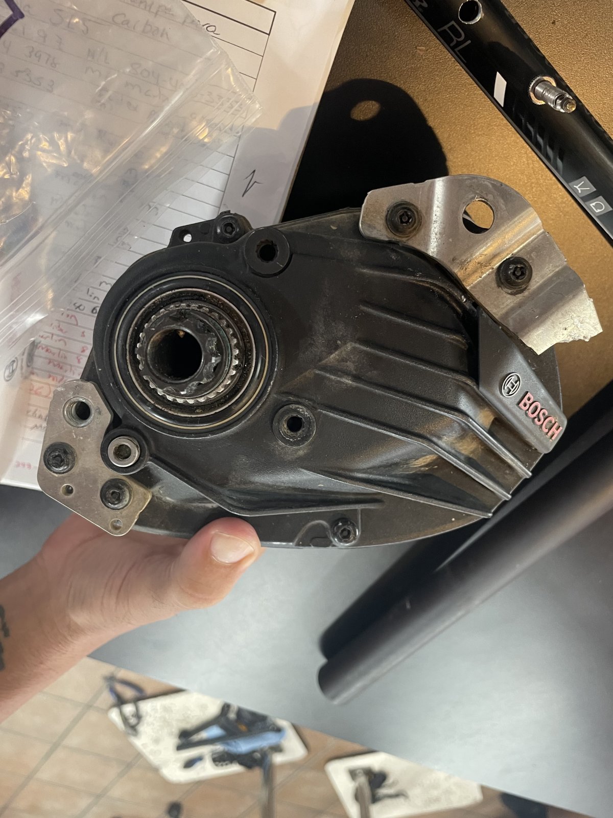

A new motor was covered under warranty. It takes 4 months to have the bike running again.
The photo shows the broken bracket.
The motor was on back order from Bosch.

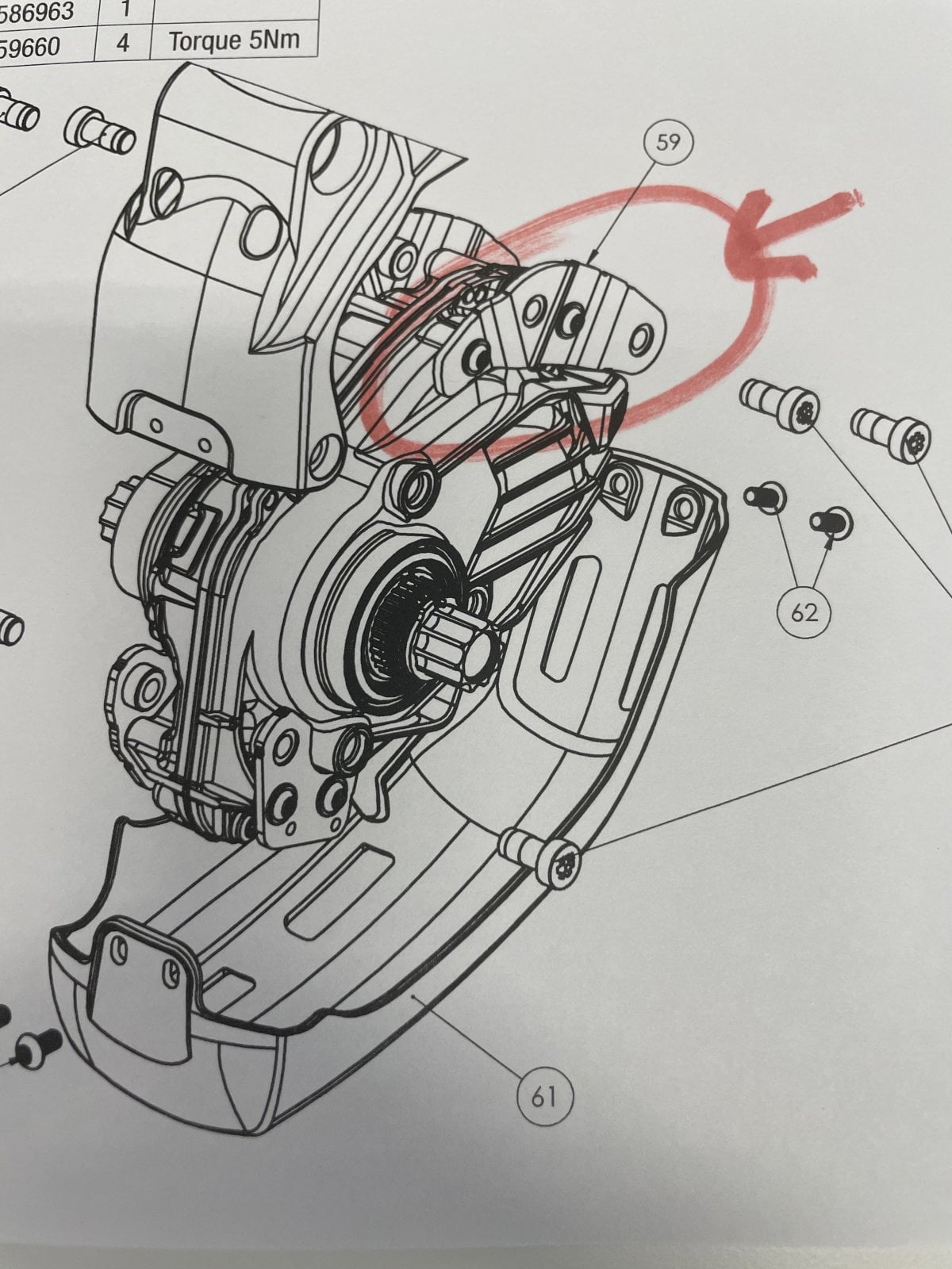

I need the bolts prat number that hold those plates on or at least the size pitch etc. two of mine sheared right off I just discovered.
Did you remove the motor from the frame?
If you are having problems with the screws that hold the motor to the frame maybe the problem is the nuts that are part of the plates and they get loose.

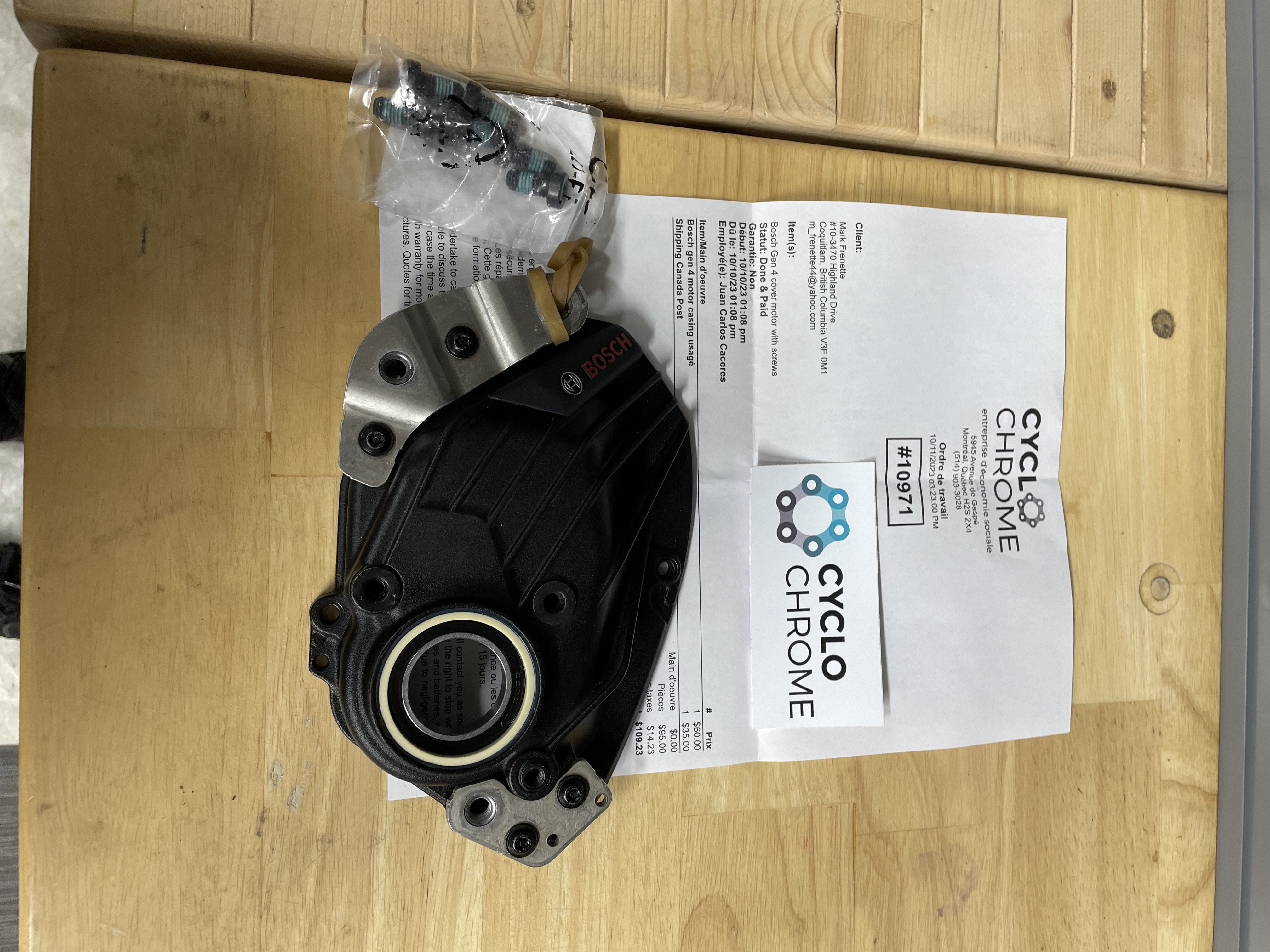

With our warranty’s starting to run out some repair centres are popping up on both sides of the pond.
A replacement motor can be expensive. For my neighbour the only option, at the time, was for him was to replace the Bosch CX motor after some bracket screws had sheathed off. (Drive-side). Removing the broken bolts/screws from the magnesium casing was impossible without damaging the threads. The slight movement of the bracket had also caused the small mounting holes to become oval. @Bearing Man helped me navigate thru the logistics of repairs and delivery.
Apparently is easy for anyone living in the EU. He provided the name of a service centre in Gaspe, Quebec Canada. Cyclo Chrome. Their response to my emails were fast and delivery took a few days (week?). After following a few instructions I was able to assemble a spare motor.
At this time I also realized the importance of a bearing seal kit for the Bosch motor.
The final price was very reasonable. I’ve forwarded this information to a few other riders whose Bosch motors have failed after the warranty has expired. I’m not sure if there is a service centre in the US.
