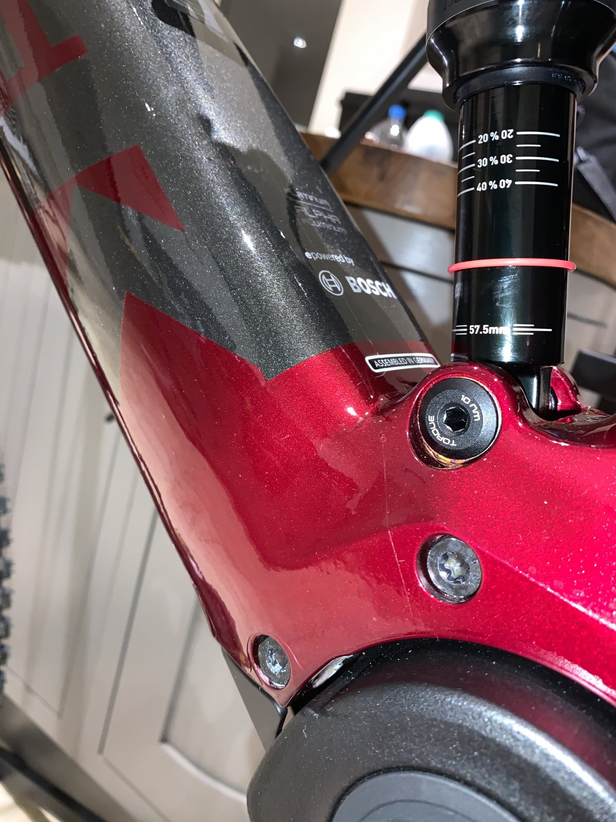

I invisiframed my Rail as soon as I got it, it’s surprisingly easy if you just follow the instructions, even around the suspension parts and strangely therapeutic if you’ve got a spare few hours. You can hardly tell it’s on unless you know where you’re looking.
