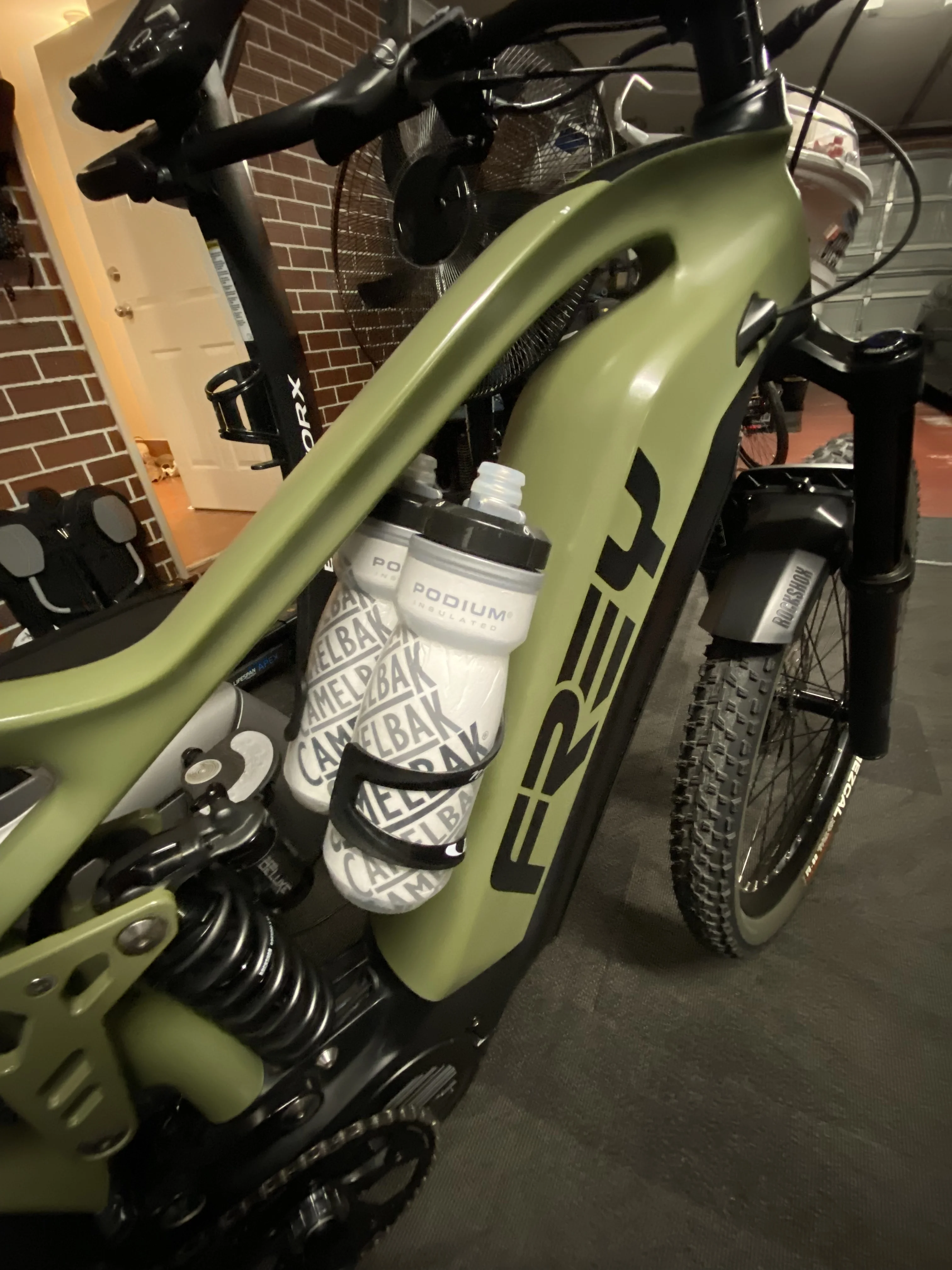

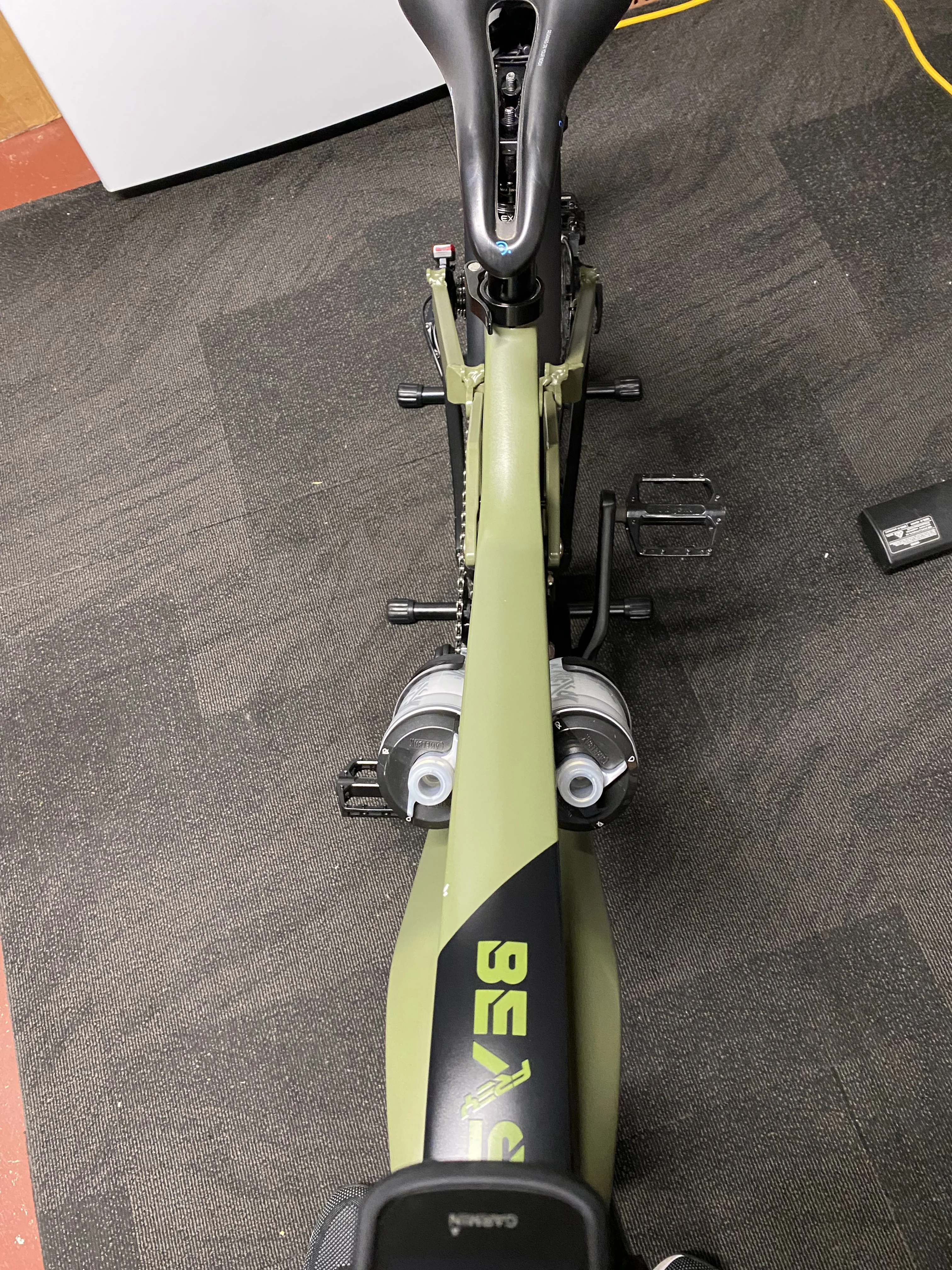

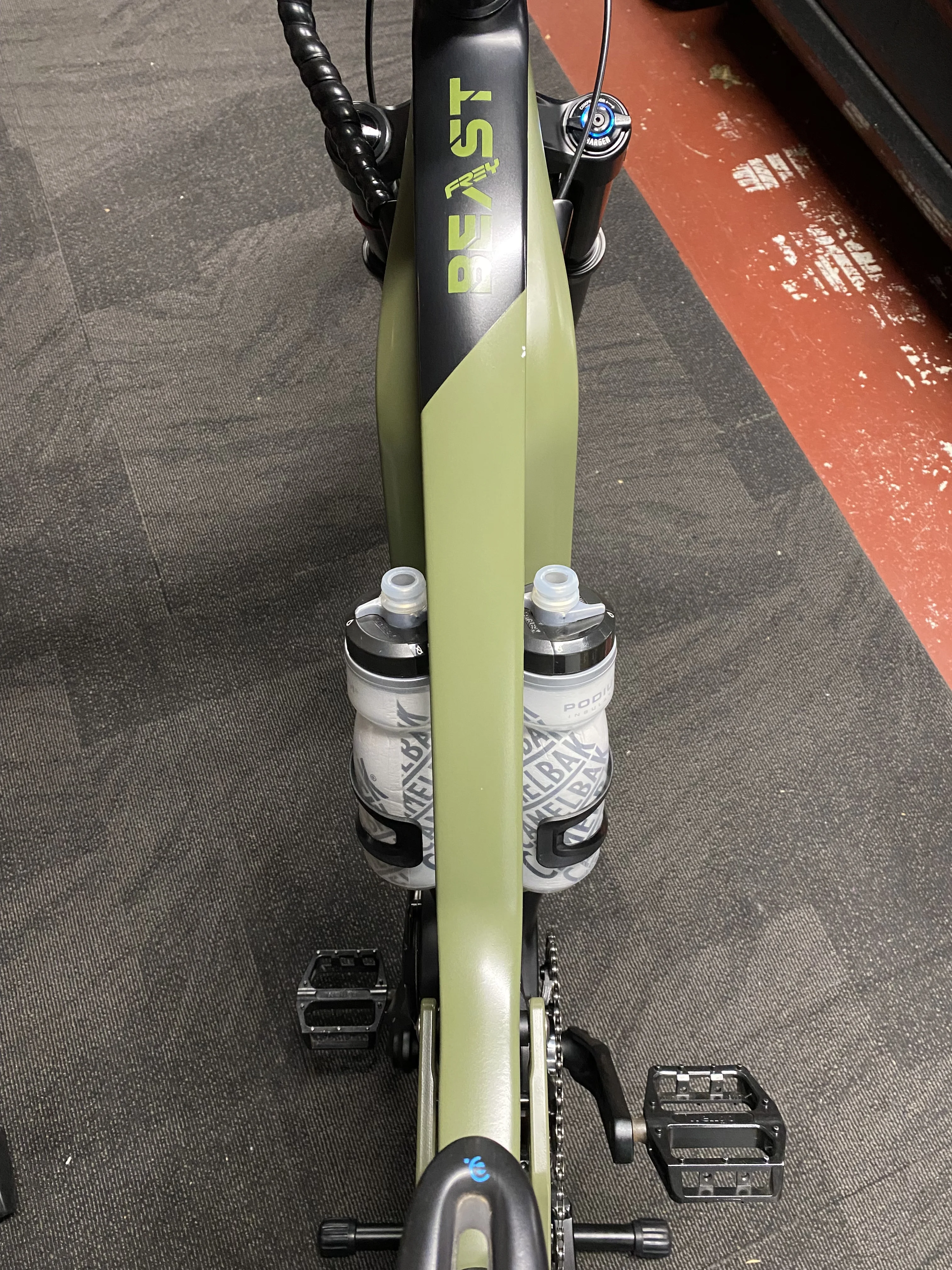

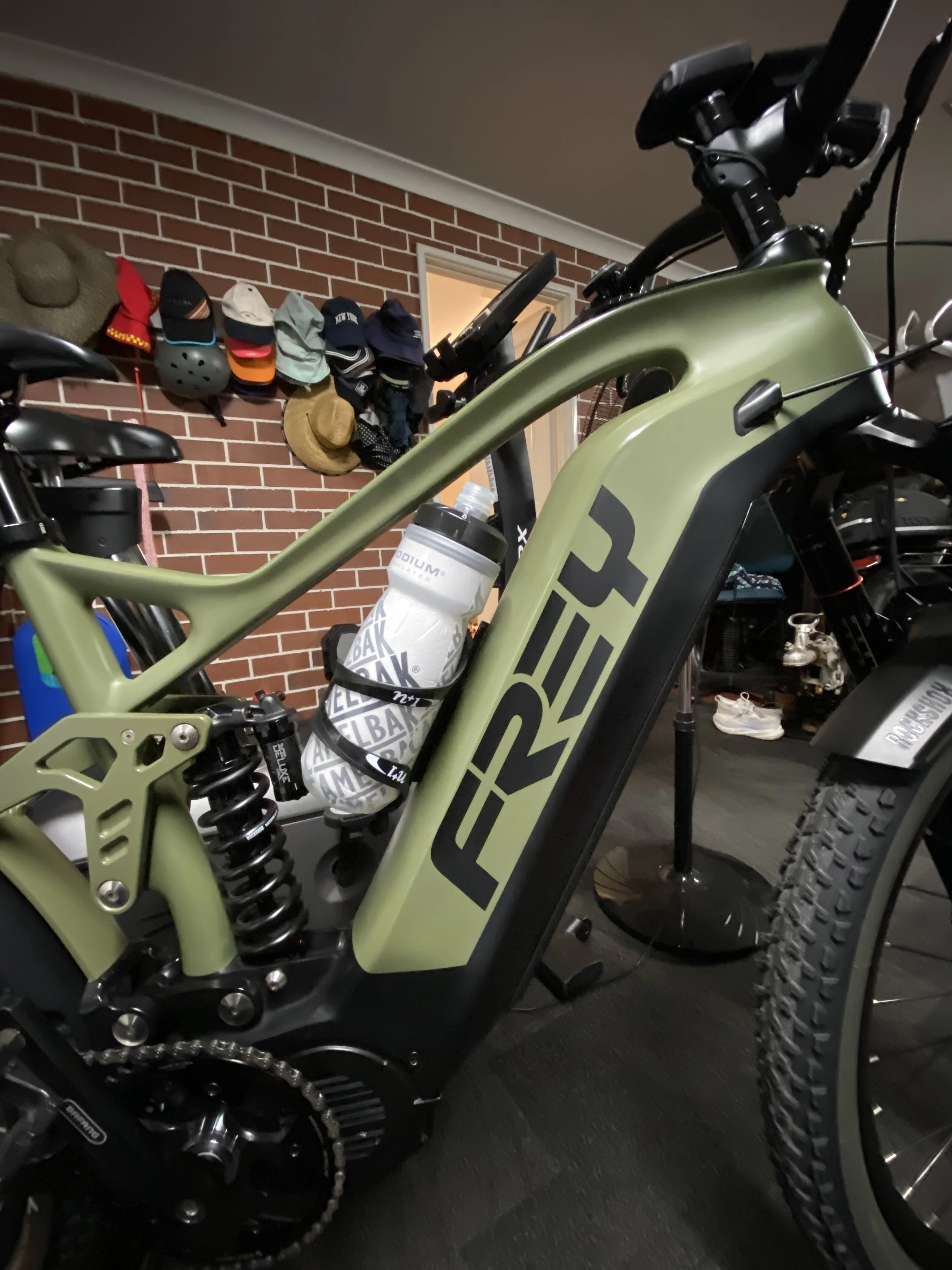

Installed the Wolf Tooth double bottle cage adapter and base for a more permanent solution. Pro’s obviously double bottles,, adjustable base means you can slide the adapter up and down to suit your bottles and frame, can also fit the 710 ml water bottles and easier access to bottles. Con’s knees rub on the bottles when standing on the pedals on steeper climbs. If you don’t pedal when standing up steep inclines then no disadvantage.
Probably use the double cage for events and the single cage otherwise.
Pics for attention with 620 ml water bottles in the cages.
Installed the Wolf Tooth double bottle cage adapter and base for a more permanent solution. Pro’s obviously double bottles,, adjustable base means you can slide the adapter up and down to suit your bottles and frame, can also fit the 710 ml water bottles and easier access to bottles. Con’s knees rub...
@juggernaut - that's a proper real-world review right there, cheers for closing the loop with pics.
The adjustable base is genuinely the killer feature on that system - being able to slide the whole lot up or down to clear the shock reservoir, cables, or just find the sweet spot for a 710ml bottle is exactly what makes it worth the money over a fixed adapter.
The knee-rub on steep standing climbs is a known trade-off with any double cage setup in the front triangle - there's just not a lot of room between your legs and the bottles when you're grinding something punishing out of the saddle. Given the kind of terrain you've been putting the Frey Beast through (90km gravel efforts with 2,000m+ of climbing is not a quiet Tuesday), it sounds like for most riding it's a non-issue and only bites on the genuinely brutal stuff.
The fact that it'll swallow 710ml bottles is a meaningful win for longer days - that extra capacity adds up over a big ride.
Good to see it all in place and working. Hopefully @skcrip gets some use out of the install pics - they're exactly what was needed to make the decision.
