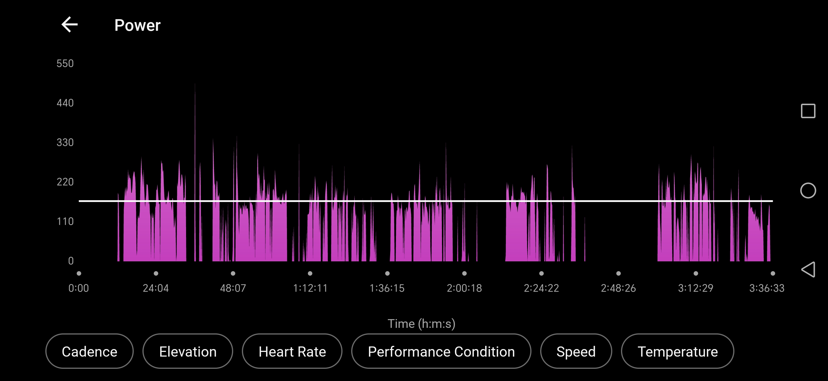

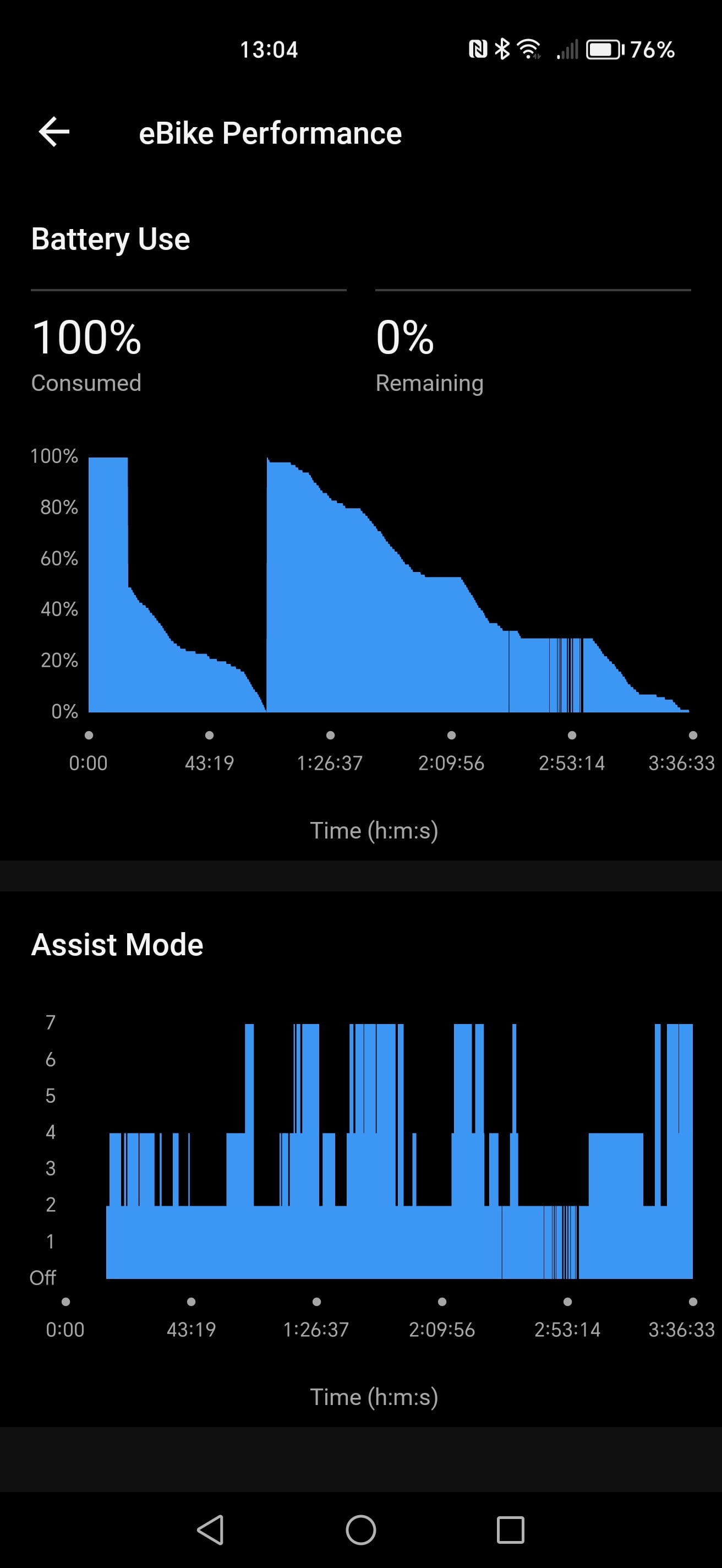

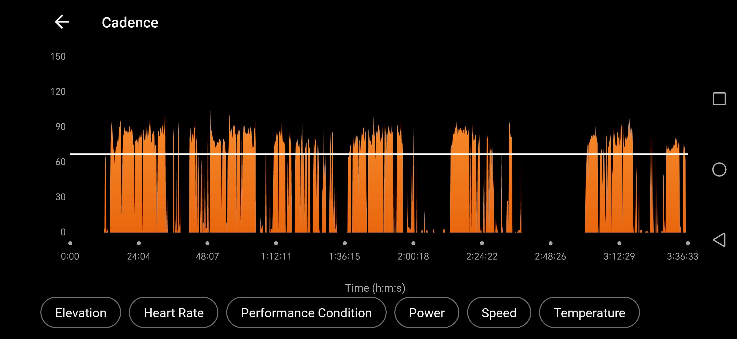

being able to use Strava or Komoot or whatever to store cadence, power, etc. and see it all in the app
You know with the EXe you can already do most of this using a garmin bike computer?
I guess it also works with other ant+/ble devices too, but I've only tried it with my garmin fenix 6 watch.
You pair the watch to the bike, ie the watch sees the bike as a series of sensors, it sees cadence, rider power, battery state of charge, then when you record a ride using your watch it all gets uploaded to garmin connect and you can see the data, for example see below.
And then if you have strava paired with garmin connect, the ride and all the data gets sent to strava.
Battery state of charge and assist mode
Rider power

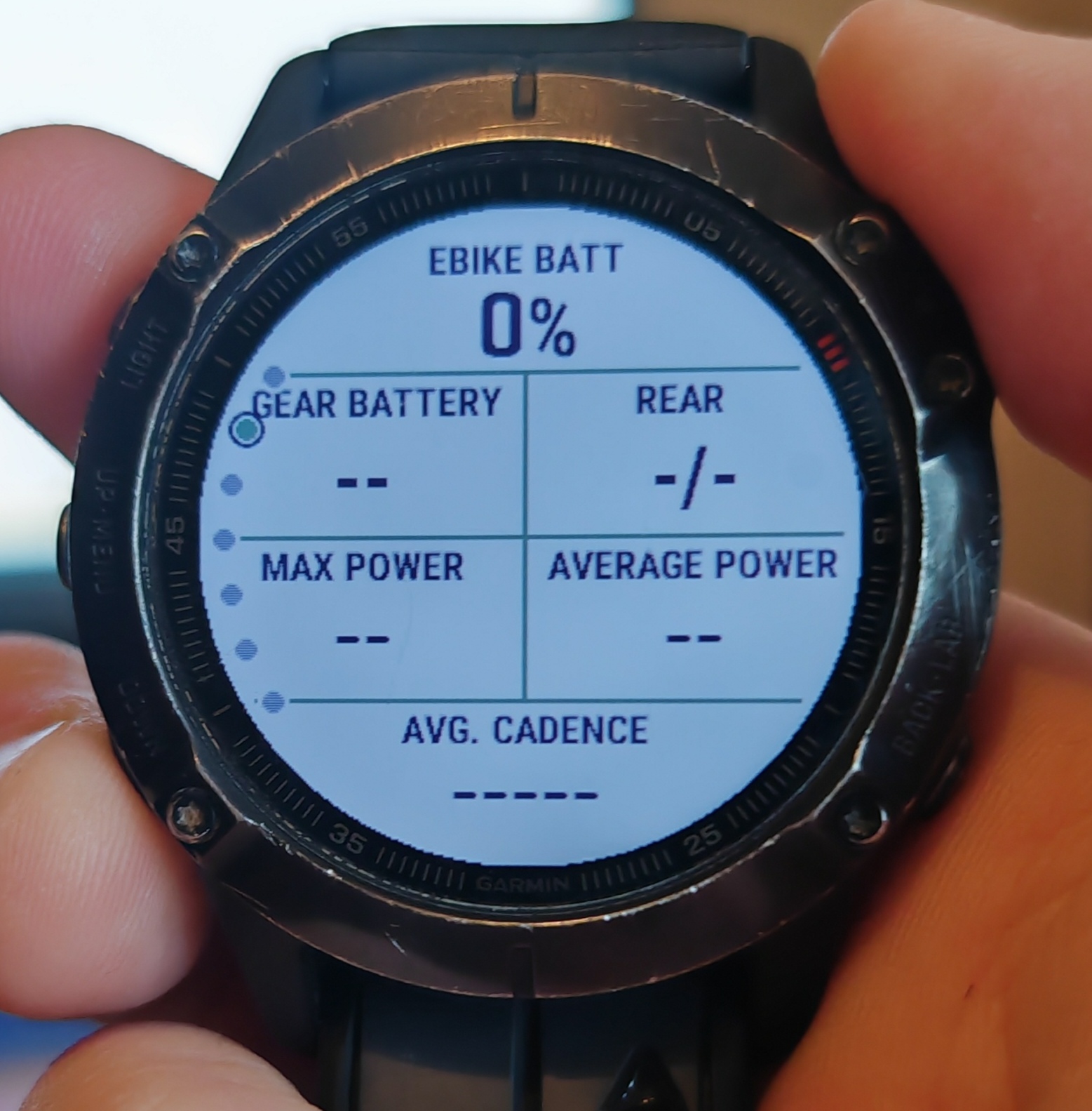

This is one of the screens I have showing on my watch when riding, it shows the ebike battery level, the sram axs derailuer battery level, the gear of the derailuer , my max power (as determined by the tq motor), my avg power, and my average cadence (as determined by the tq motor)
