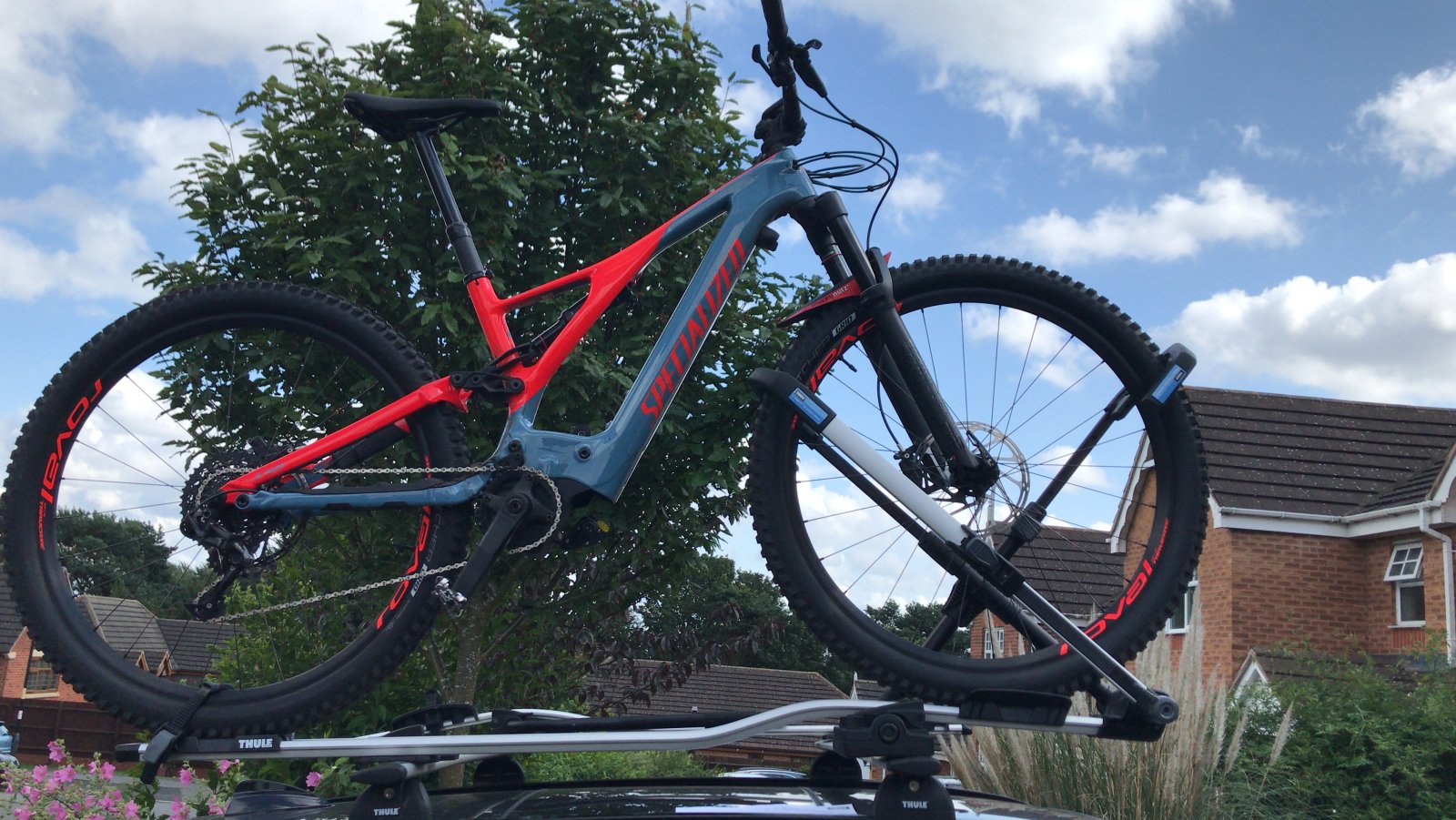

I bought a BMW roof bars and bike rack of eBay for a couple of hundred quid, I’ve been using it for the last few years, works well for me ?
*the battery comes off every time the bike is on the roof

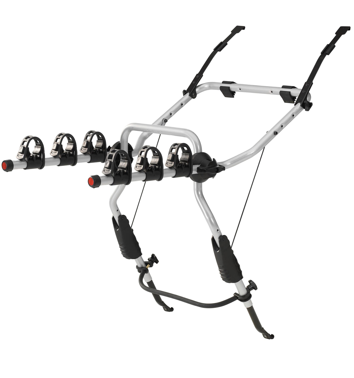

My neighbour had a boot rack and he puts 4 Halfords cheapo bikes on it. Combined that weighs way more than a single ebike.

Boot racks aren't the most secure and the shape of many modern FS bikes means they don't hang well. You also can't access the boot with them fitted.

I have a 2019 levo large and a 1 series BMW which isn’t the best combination but I brought a Thule clip on rear rack, I’ve had three normal bikes on and use it with just my levo on most weekends. Never had any issues!!
