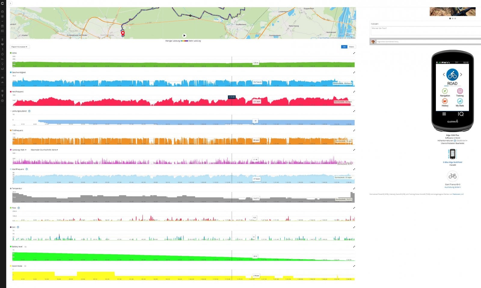

GeoBoris
Jan 29, 2021
13
30
France - Alsace
I'm connecting my Garmin Edge to the Trance too. Works perfectly!
As already mentioned, you can get: sbattery %, power mode, cadence, speed and power (watts) from the bike.
I've shared a logging with all that data for you here:
