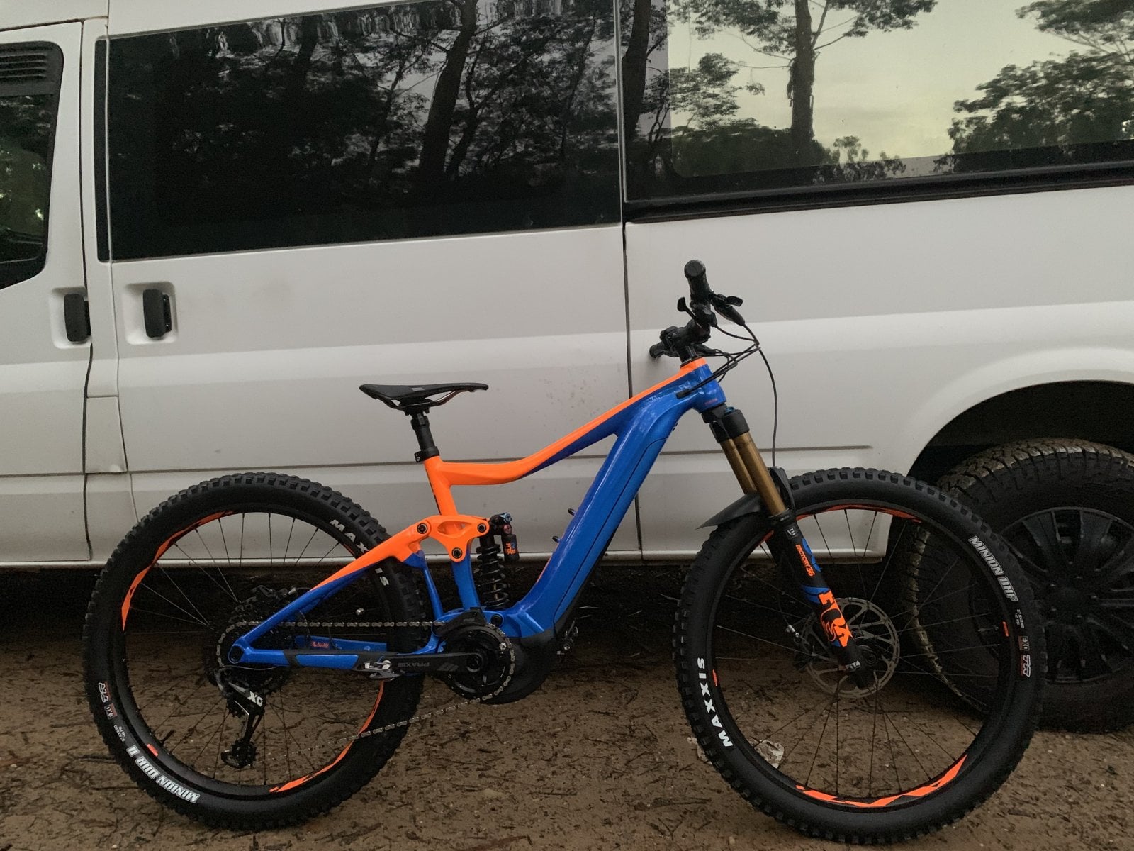

Picked up my new sx
Just amazing looking in real life ??
After some basic / base rear suspension settings, rebound/compression high/low
Never had a coil or so much adjustment in a shock
Any tried and tested info would be great thanks
I understand some fine tunning will be needed for personal riding style
