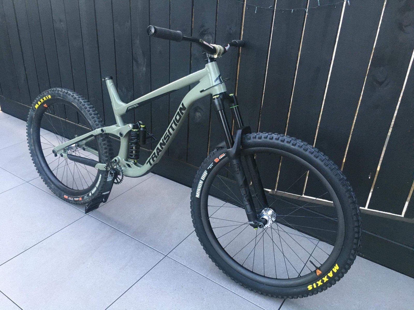

I've built a mullet bike recently (WIP pic below) and I'm glad I kept the crown height increase down to +10mm, doesn't sound like a lot, but it is on the trail. The original bike was 160mm rear and 170 front on 27.5 wheels. When I went mullet, I went for a 160mm fork.
The trance may let you get away with an extra 20mm crown height but 40mm will be whack.

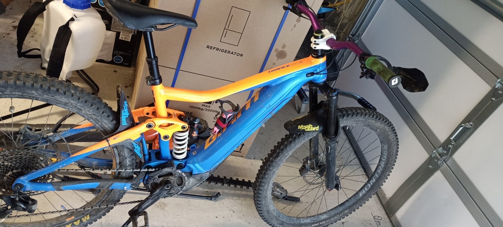

Iharpel1 - hi there. I'm pretty new to this forum site but am interested how you got on Mulleting the SX Pro? I too have done this (29"/160mm) and love it.

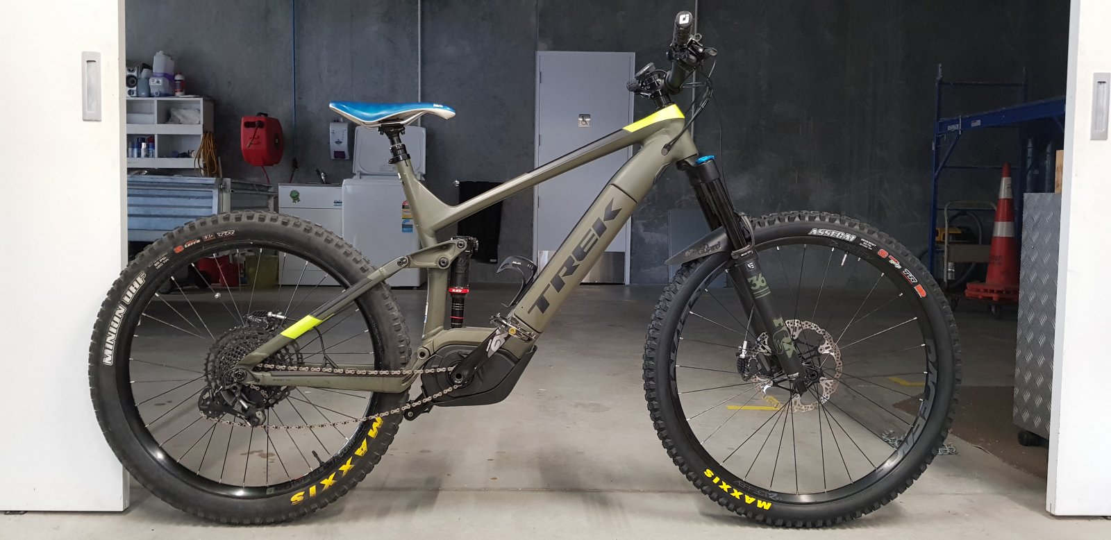

Nukeproof 50mm riser bar, 160mm 29" front end (Trek Slash), Cane Creek Progressive Coil (450>600lb). 160mm Cranks
Therefore:
- 29" fork : more or less +20mm (compared to original 27.5" fork)
- 29" wheel : more or less +20mm (compared to original 27.5" wheel)
- 50mm riser bar : +30mm (compared to original 20mm rise bar)
It is not too much? ?
Uphill the front wheel does not raise up?

I have dropped bars 8mm with spacers on top, as it was a bit lively on STEEP 4wd tracks & sneaky climbs up dh trails when sessioning features?
