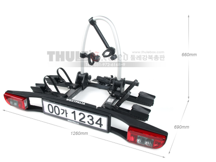

I'm trying to work out what bike rack will work the sommet. The rack I really fancy is the Westfalia BC60/70/80/Bikelander as it folds up really neatly, but I'm not sure if the arms will actually be able to clamp onto the sommet anywhere as the hoop looks pretty low:
It looks the inner clamp would be right around the seattube/shock area, which looks mighty congested, I can't see there's a lot to clamp onto there?

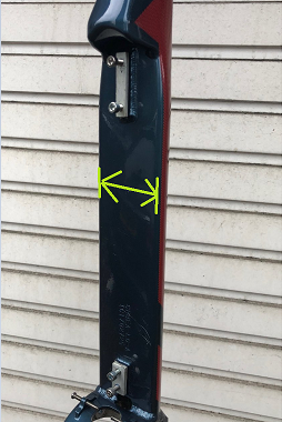

The other option seems to be clamping the downtube where the battery goes (with the battery off obviously), but I'm not sure if the clamps will open wide enough for that (they say the limit is a downtube diameter of 80mm)? Could someone possibly stick a tape measure across the down tube under the battery and tell me how wide it is (green arrow dimension below)?

Those clamps can be moved around to wherever they suit best. E.g. move it up to the topbar.
I have a similar rack from Thule. I used to have a cheap no name thing, so I am thoriughly enjoying the build quality and convenience of the Thule rack.

I have a Thule 933. It also folds and has the lower attachment bracket. I attach two eBikes via the downtube. I do not need to remove the batteries. My bikes are Meridas with the external Shimano batteries.

Brilliant, many thanks both. The Westfalia rack is supposed to be good for tube diameters up to 80mm so it sounds like it could work.
