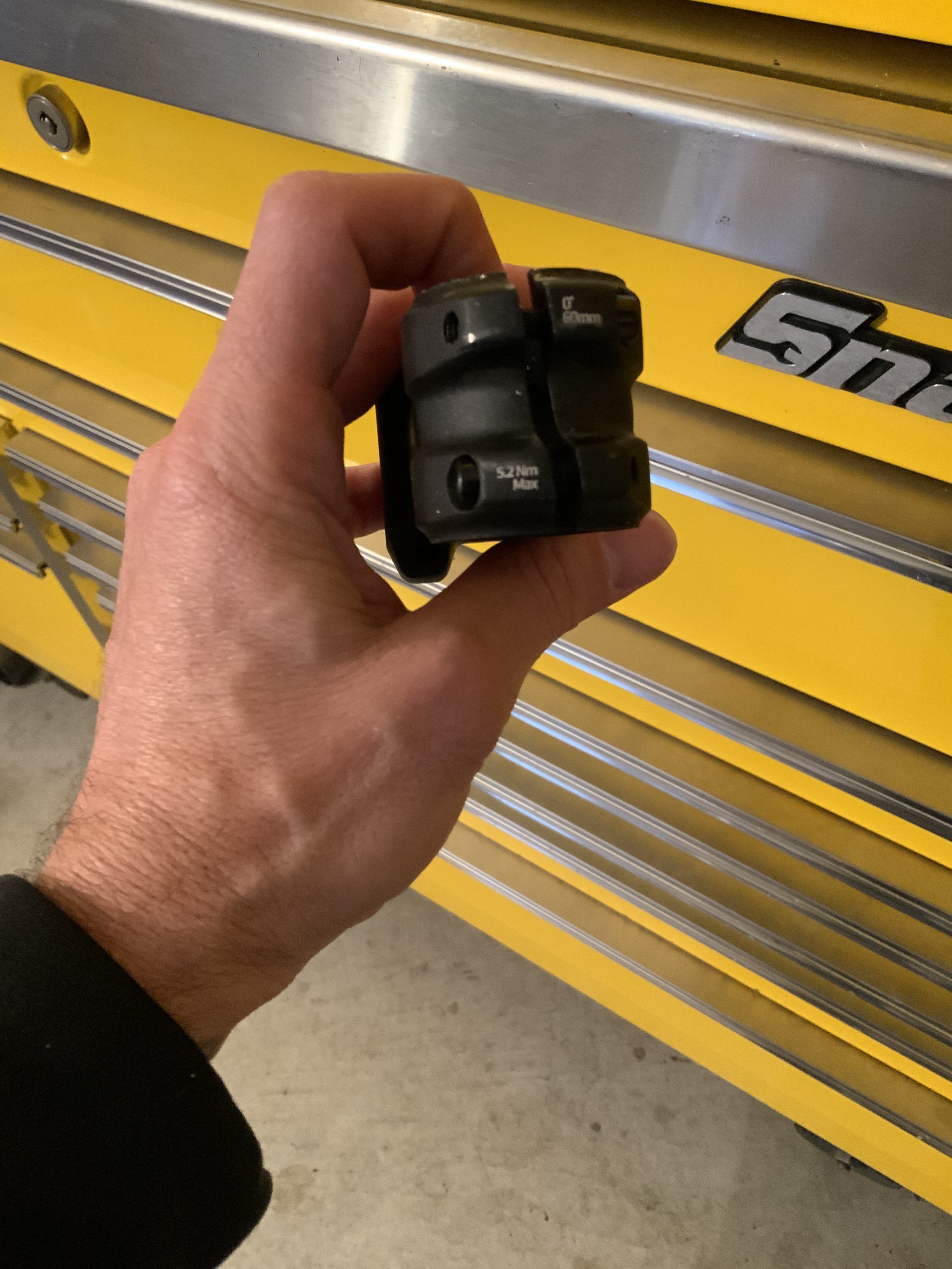

Looks like 5.2NM max

Steerer tube, 4nm. Ensure there is no lateral movement. Then tighten the stem bolts to 5nm (or whatever the manufacturer of that stem recommends) and align the bar. That’s how I do it.
Use a point on your fork to help centre /position your bar.
Btw I’m not a bike mechanic.
