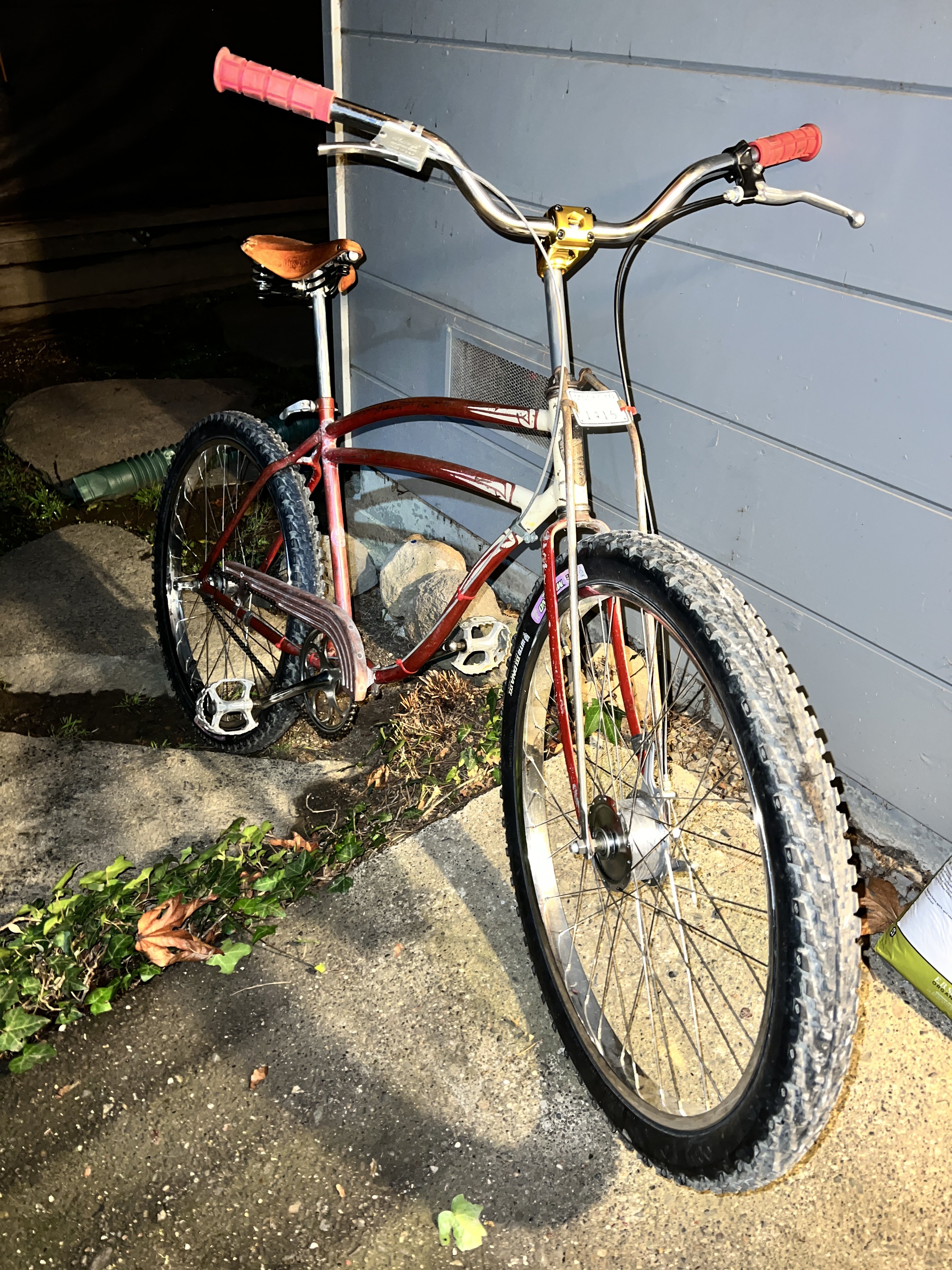

I have one of my klunkers, stepson has another. ‘40 schwinn excelsior, ‘70s araya steel rims, ‘50s bendix 2-speed in back (manual not kickback!) “modern” wtb mutanoraptors, Magura brake lever for the atom drum brake in front. Feels so tiny compared to my three 29ers.
