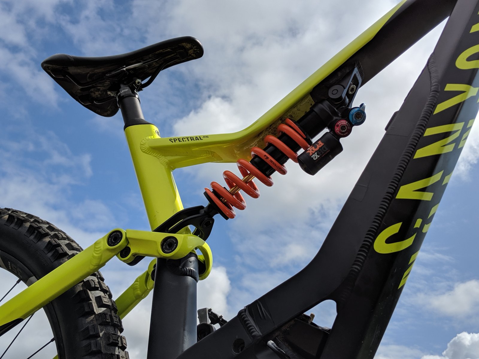

Mine is a large, i’ve put a fox dpx2 on which was very good and now have the dhx2 which is amazing as i do a lot of dh stuff and very rough natural rocky stuff. If i was just doing single track and trail centres i’d go for the dpx2.
Not tried them on a medium

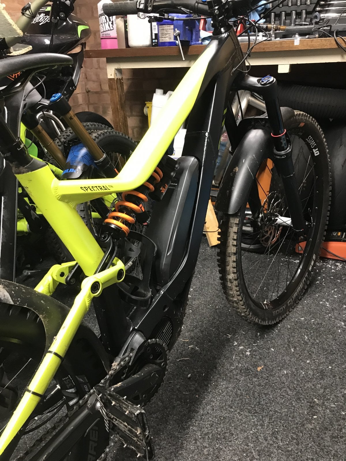

My bike came with a DHX2. Its my first ever coil shock and im blown away by it. Small bump compliance is awesome. Worth the slight weight penalty over an air shock for such a plush ride. About 85kg kitted and running the 450lb spring.

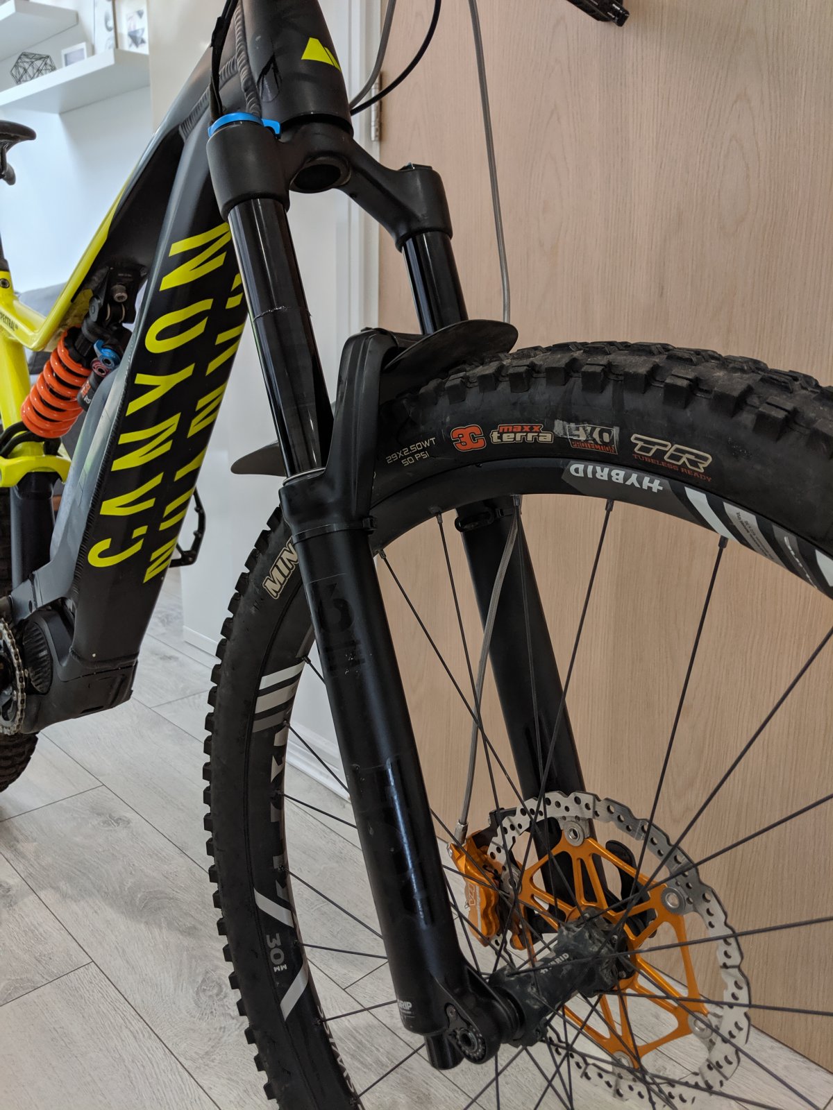

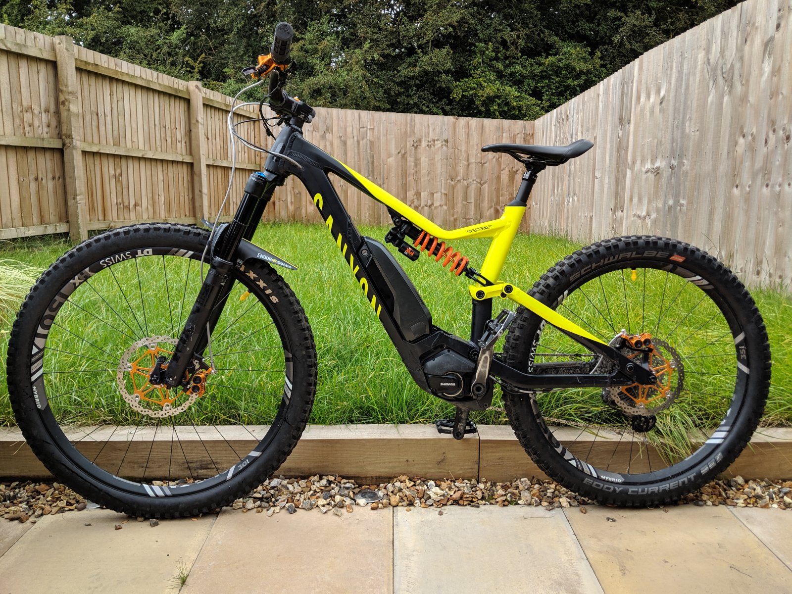

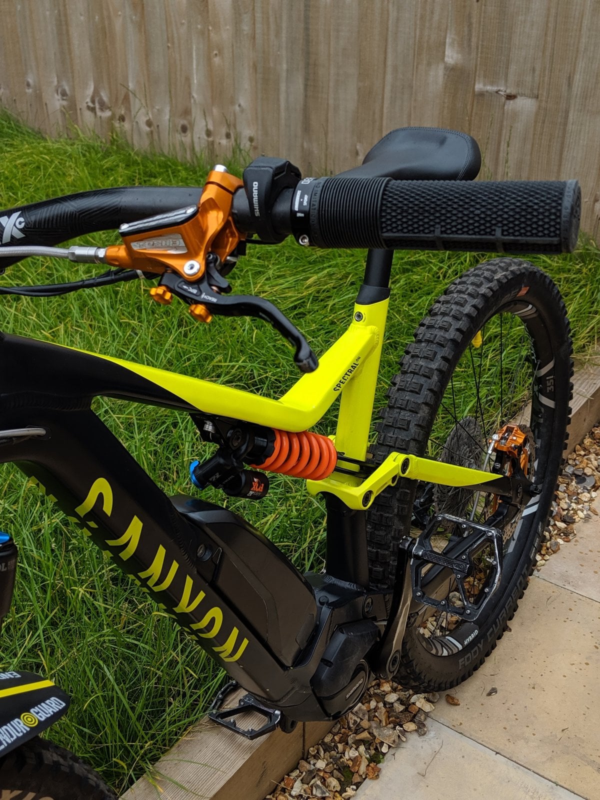

Tadaaaaaa! :) Looks the business, feels pretty good initially and I'm booked in for Bike Park Wales weekend after next to put it to the test

Liverpool
Looks really good.
Did you also go for 320x65 and what mounting hardware is needed?
230!!! Lol 230 x 65. The shop where I got the coil leisure lakes mounted it for me. They used the bottom bushings out of my original shock it seems and put new ones in the top because they had them lying around.
They also price matched Silverfish which had 20% off so I got a really good deal.

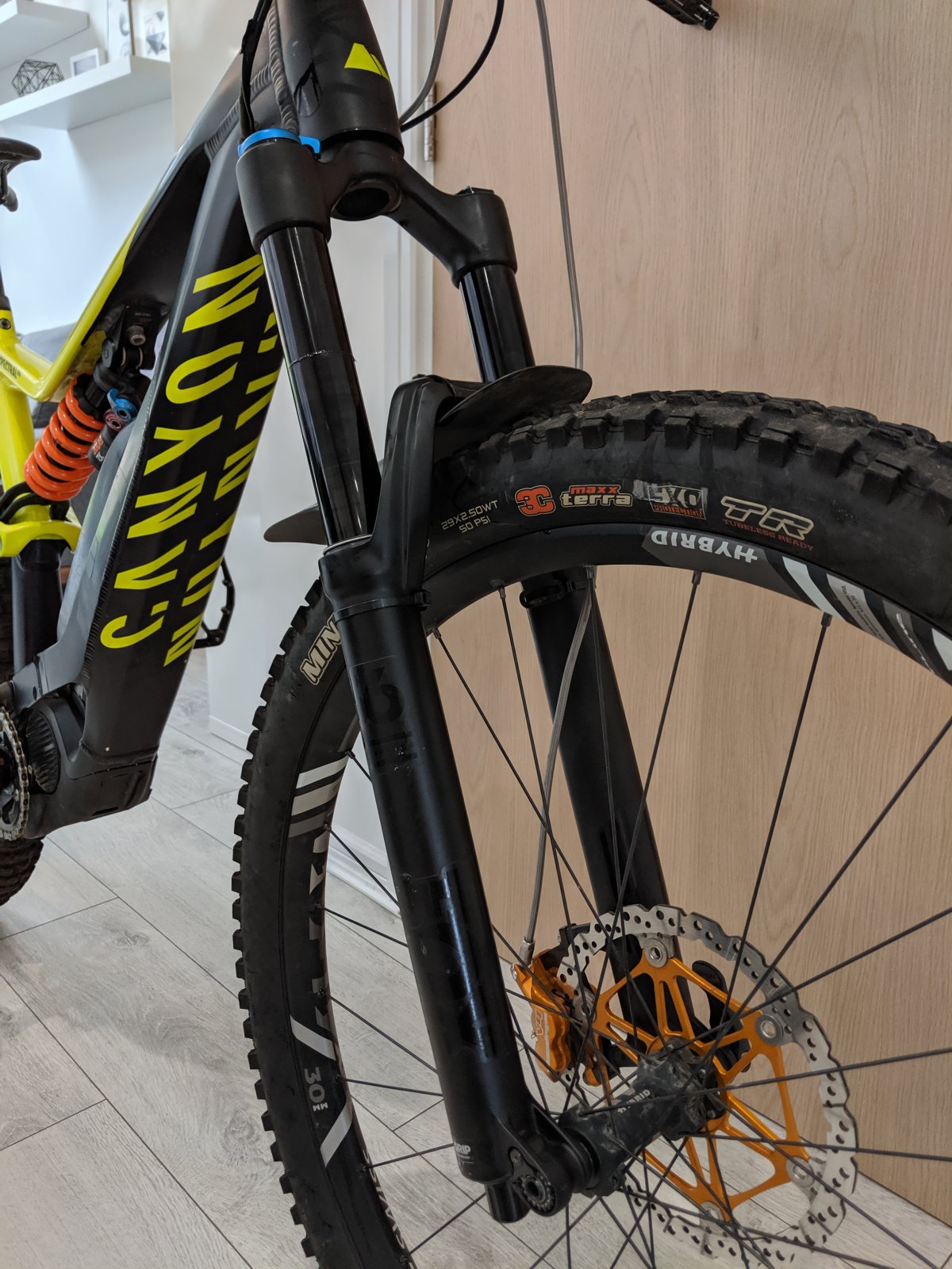

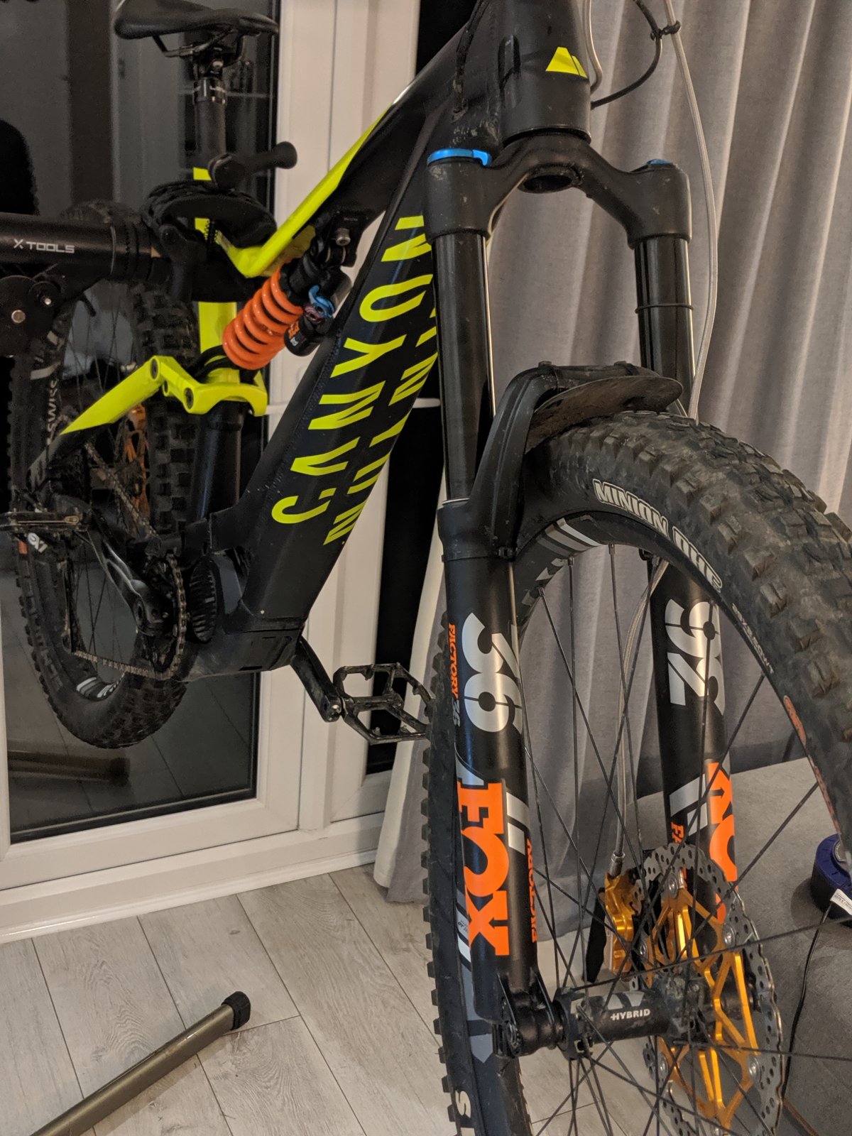

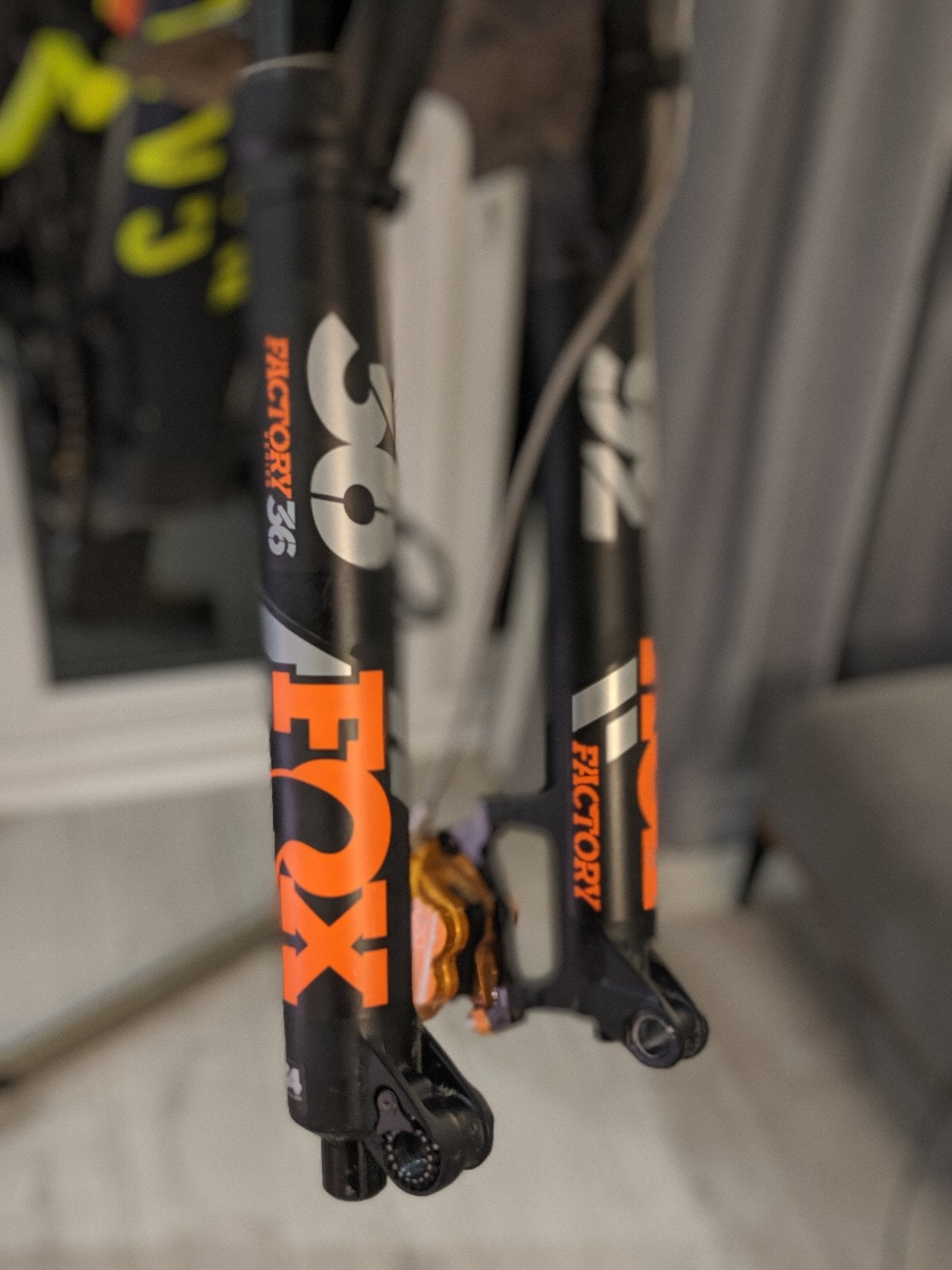

Awesome - you got some updated pics with the new fork decals installed?
Haven't done it yet ? my missus was on holiday when I first got them and had her hairdryer with her. So I couldn't get the old ones off ?.
I may get chance to do it this week if the weather stays dry
When I did my fork, I used some low tack masking tape to mark the top and bottom edges of the original graphics, which made it easy to Line up the new ones
Cheers for the tip. My decals have come with alignment stickers so I'm hoping it will be easy... Famous last words

For those interested, I fitted a dvo jade coil to my size medium spectral on. It involves a custom made adaptor. If needed, I might be able to provide it.
