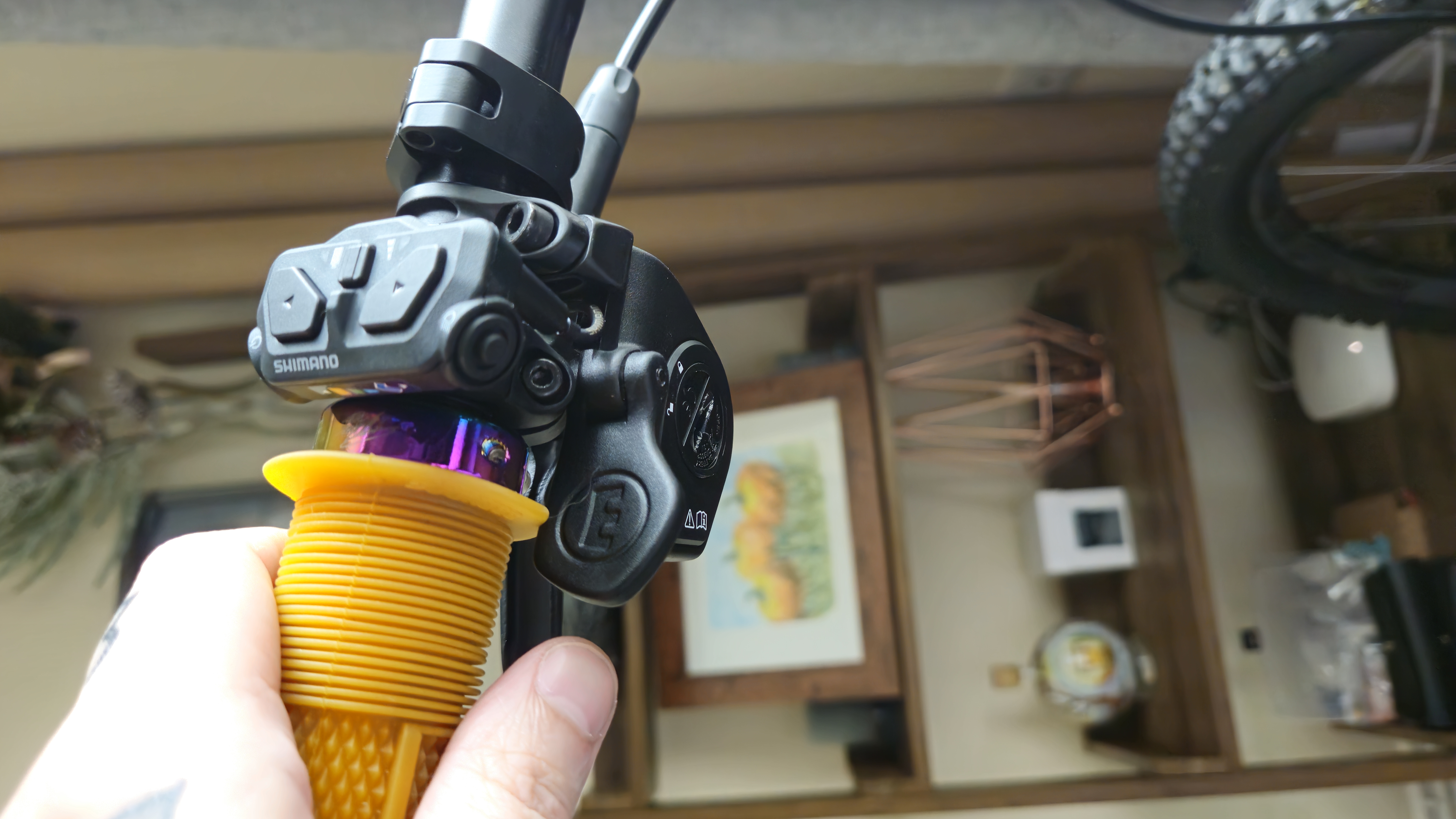

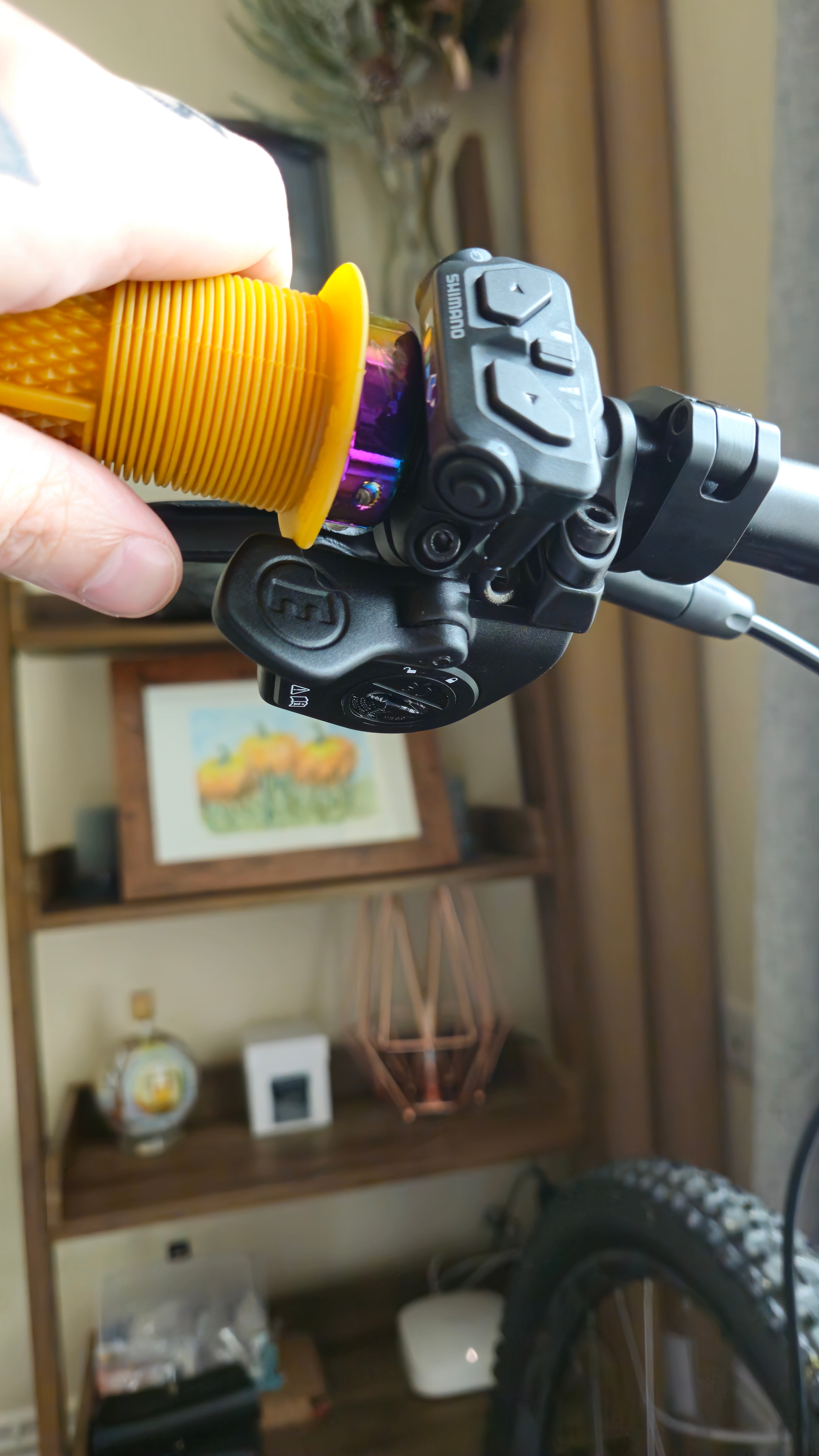

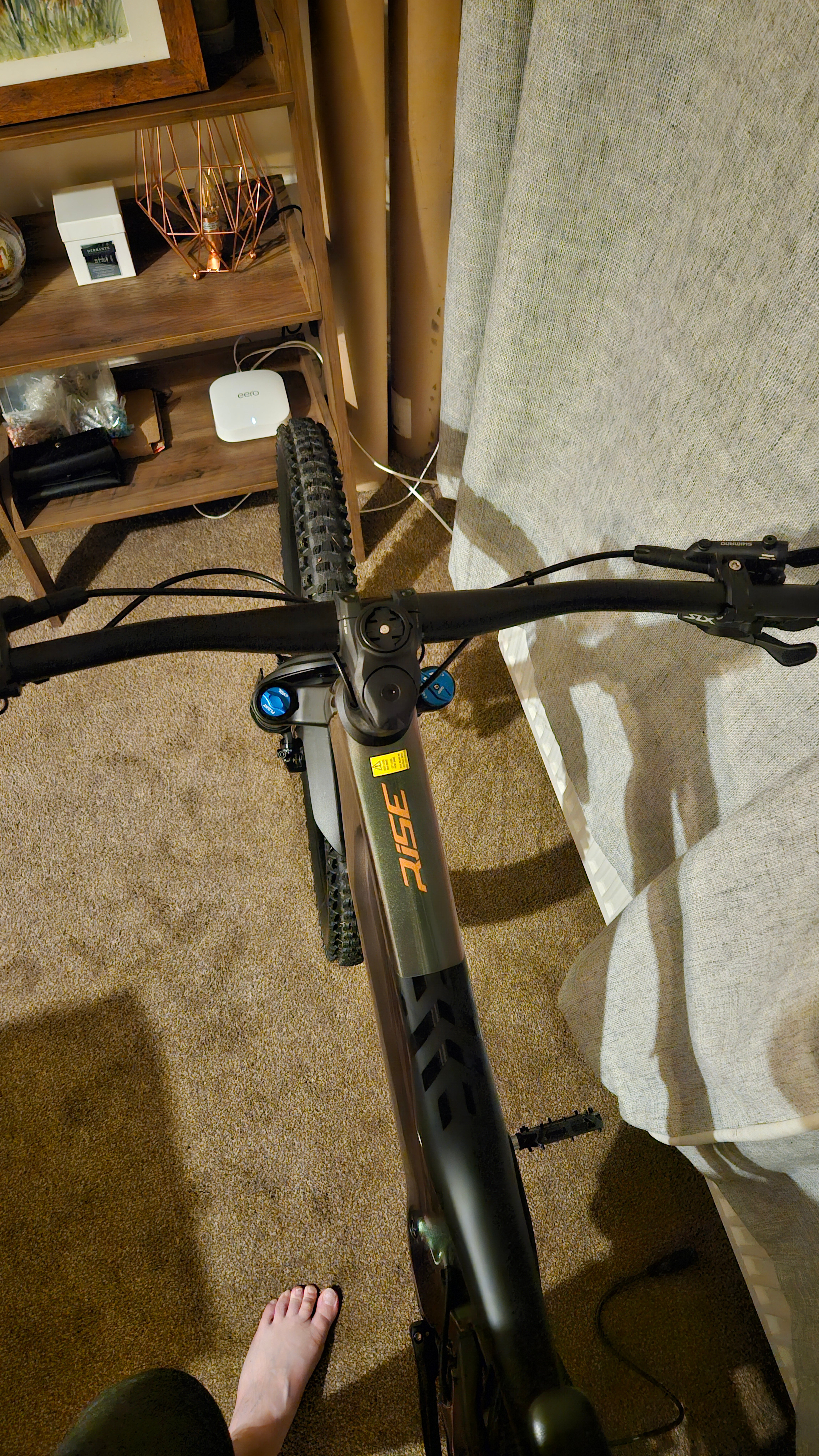

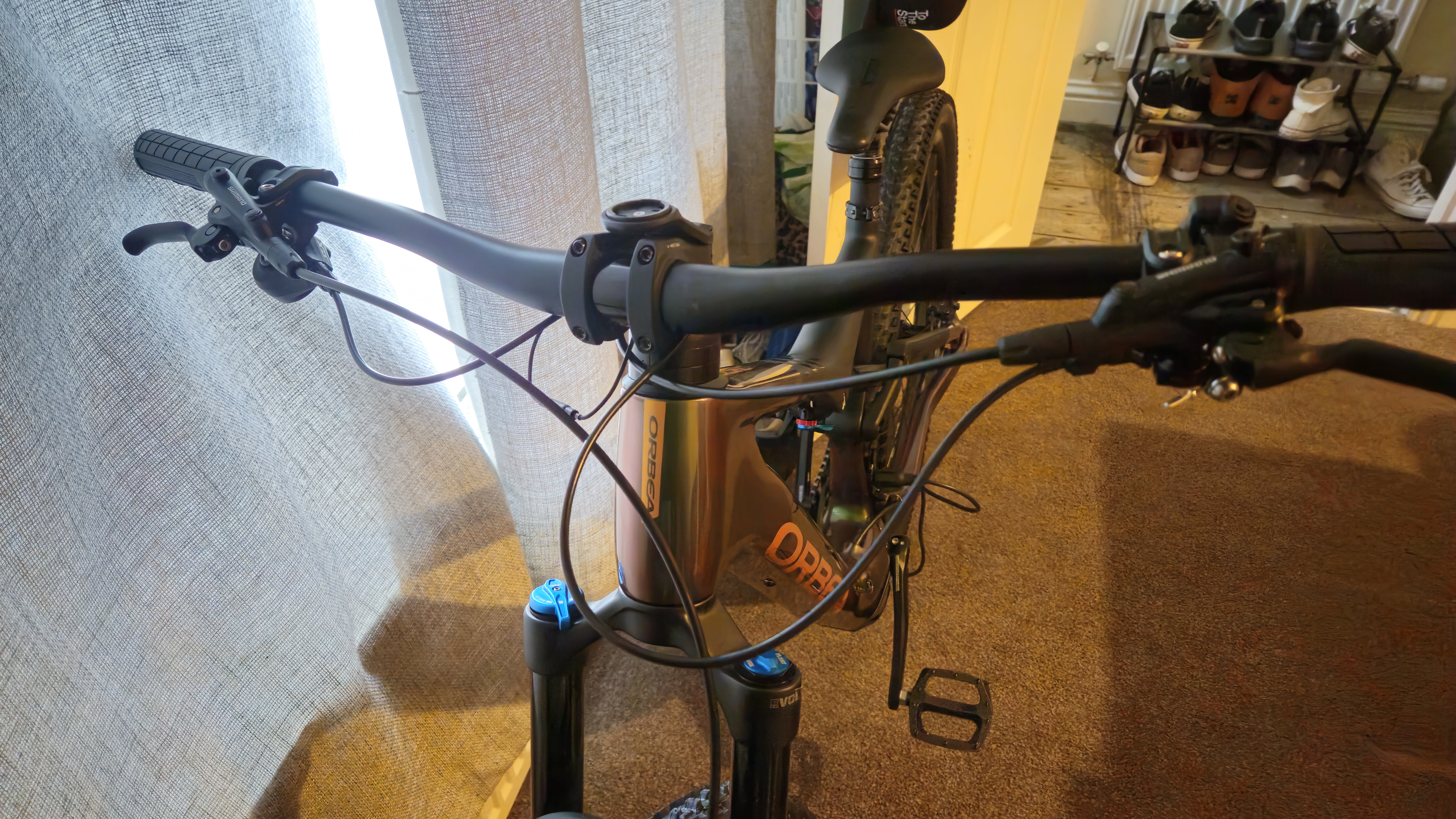

Hi folks! I'm new to this forum. I'm by no means new to mountain biking or EMTBs however I've just received my new Orbea rise m20 2023. I couldn't resist the price these days of a brand new one and really fancied something lighter than my full fat nukeproof megawatt. But I'm after a bit of guidance regarding the mess that is the cockpit it came with. I'm in the UK so rear brake left and back brake right. The cables for everything just seem an absolute mess from the factory. Can any UK riders put some pics up of their cockpit if you've managed to get it looking clean? I feel like with how mine has came that there's going to be a lot of rubbing, hoses clanking on the the bars and frame. The cable that connects the controller just seems to dangle around in no man's land and the dropper cable seems way too long. Pictures I've seen, which tend to be the oppisite brake setup look extremely clean. It's by no means awful, could just do with a bit of tidying up. I've attached some pics of mine. Thanks folk I look forward to hearing from you all!
View attachment 20240524_083310.jpg View attachment 20240524_083306.jpg View attachment 20240524_083256.jpg View attachment 20240524_083251.jpg

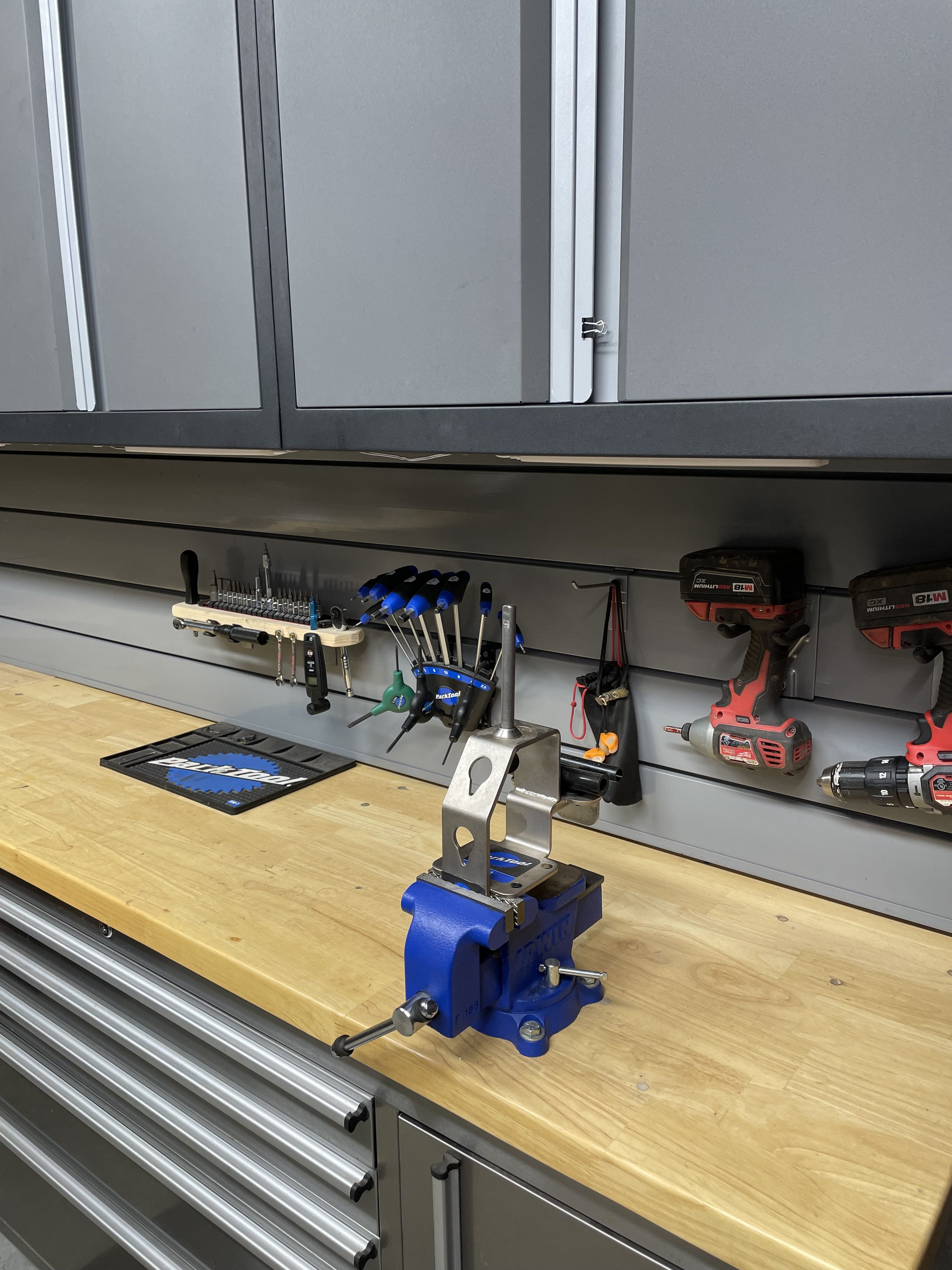

My work bench.

Could you re-route the cables so they’re going into their more traditional side when entering the headset? Is part of your problem that they just flipped the brakes left to right without rerouting? I despise headset routing and have considered re-routing my lines to go along the top of the downtube with those sticky cable fasteners. Easy access and maintenance. Next go axs for derailleur and shifter leaving only the dropper through the headset. I don’t think I can go axs there - it seems like a solution in search of a problem.

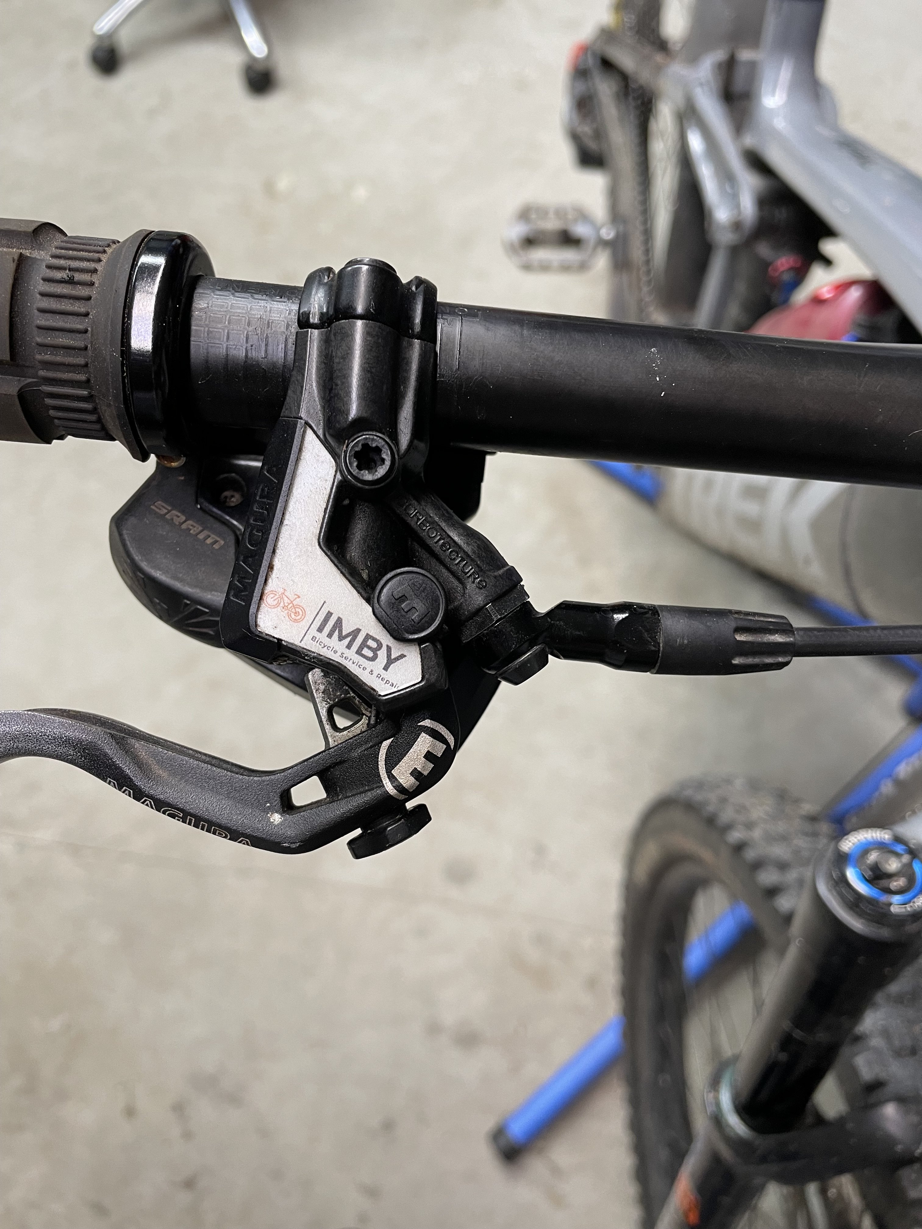

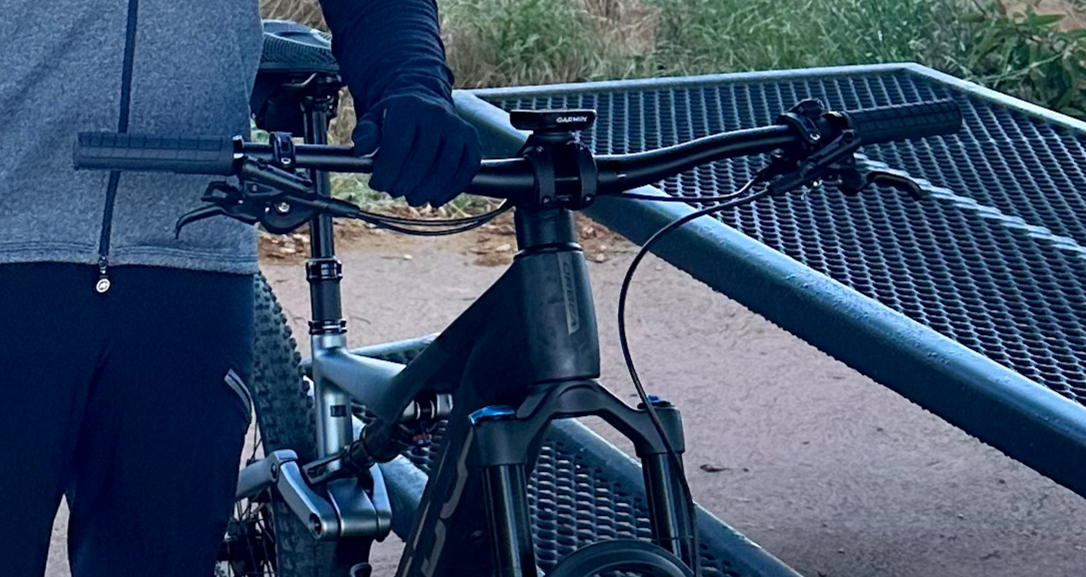

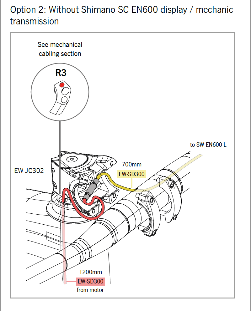

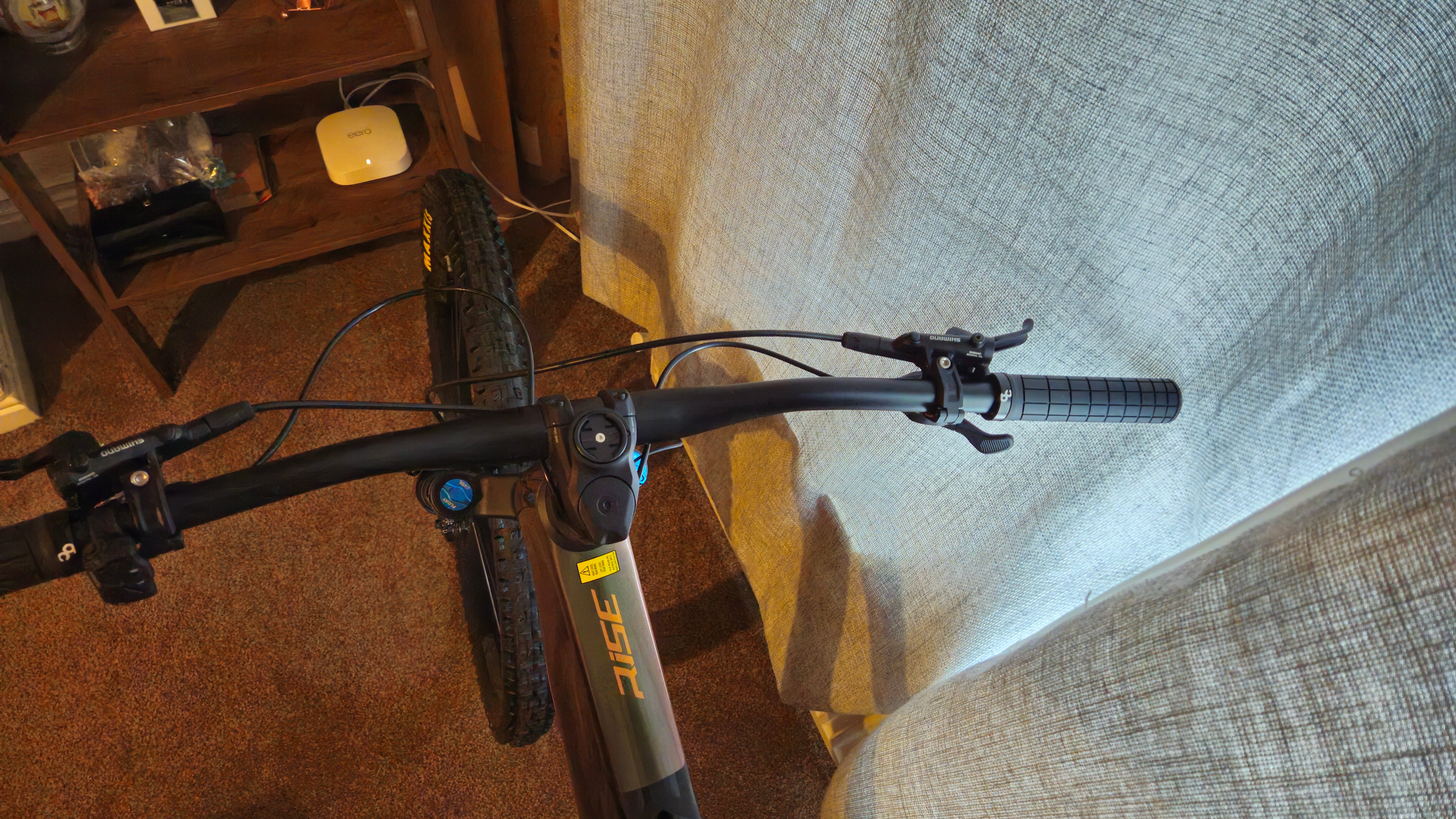

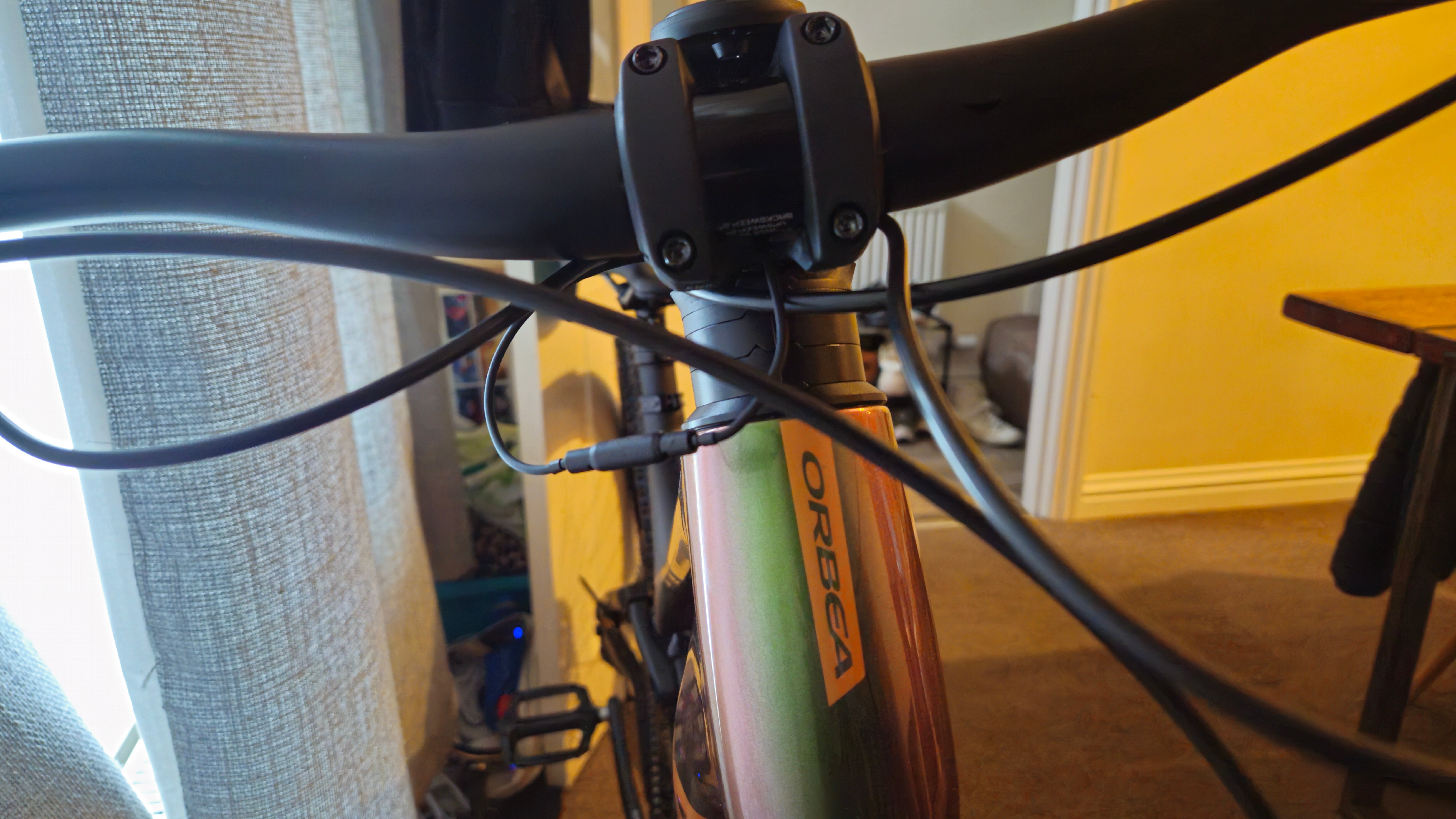

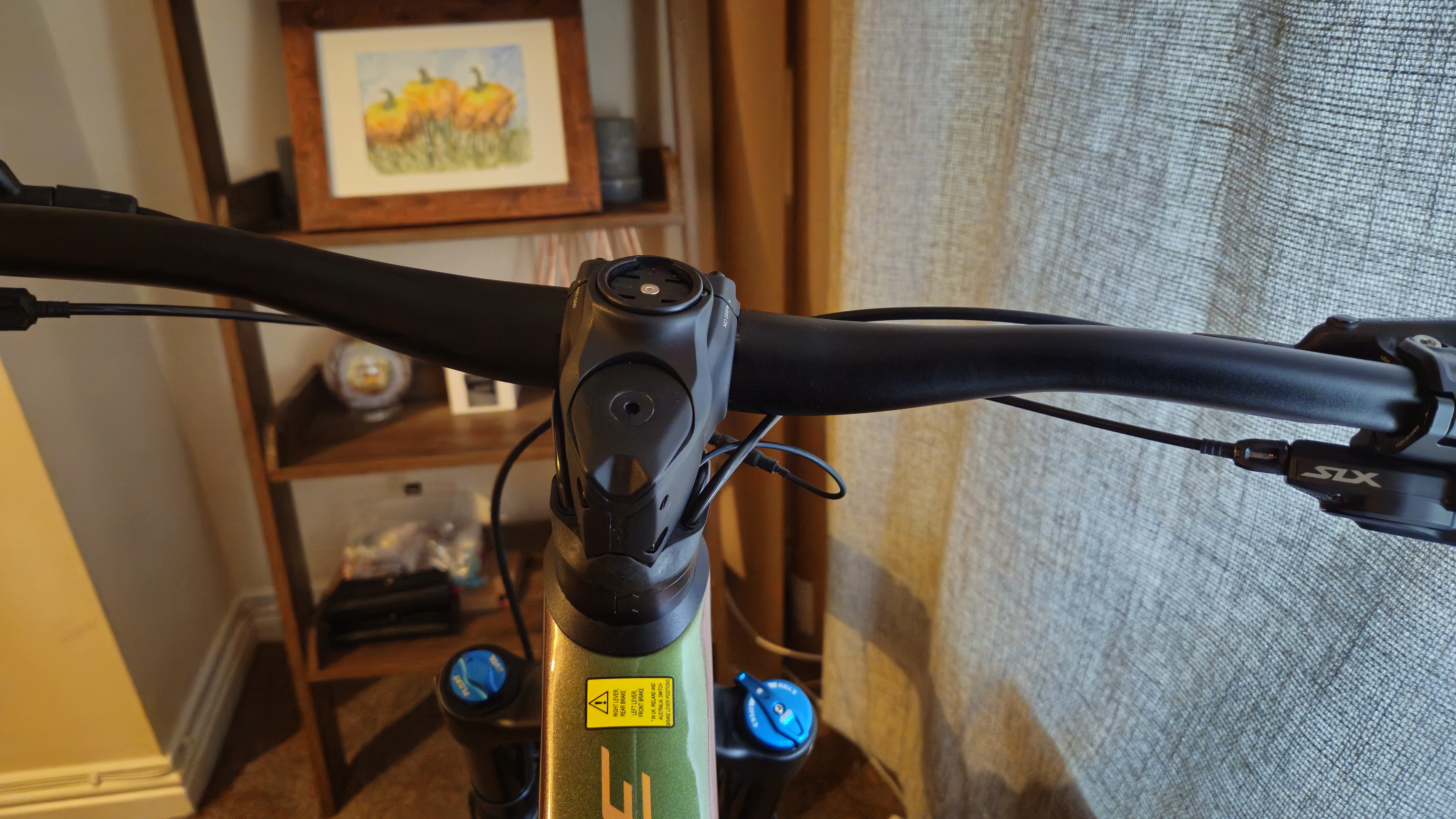

I just got one of these a few weeks ago. I'm in the US, so brakes are set up opposite, but I don't think that makes too much difference. I found that you can easily push the cables/hoses further into headset so the extra length is hidden inside the frame. Doing this and matching the length/curve of your dropper cable to your rear brake hose will make a big difference.
The Di2 connector is supposed to be inside your stem, so if you remove the handlebar and put it where it's supposed to be that'll make a difference. On mine there's only a small section of wire visible (and it's hardly visible). If you go to the Orbea website you can download their "blue paper" on the bike and find diagrams showing this.
I've attached a couple of pictures of mine and a screenshot from the blue paper.

Thanks all for the replies and suggestions! I won't be dropping money on wireless shifters and droppers just yet, but it certainly been burning in the back of my mind. I'm getting out of bed right now to head downstairs and sort the controller cable out as per that diagram and I'm going to try and push the dropper cable further into the frame, failing that I've got cutters and will sort that out another day. Thanks again. Very simple solutions that didn't cross my mind.
View attachment 140958 View attachment 140959 View attachment 140960
Just wondering... did yours come with the tool that slots into the linkage? Doesn't seem that mine did 😕

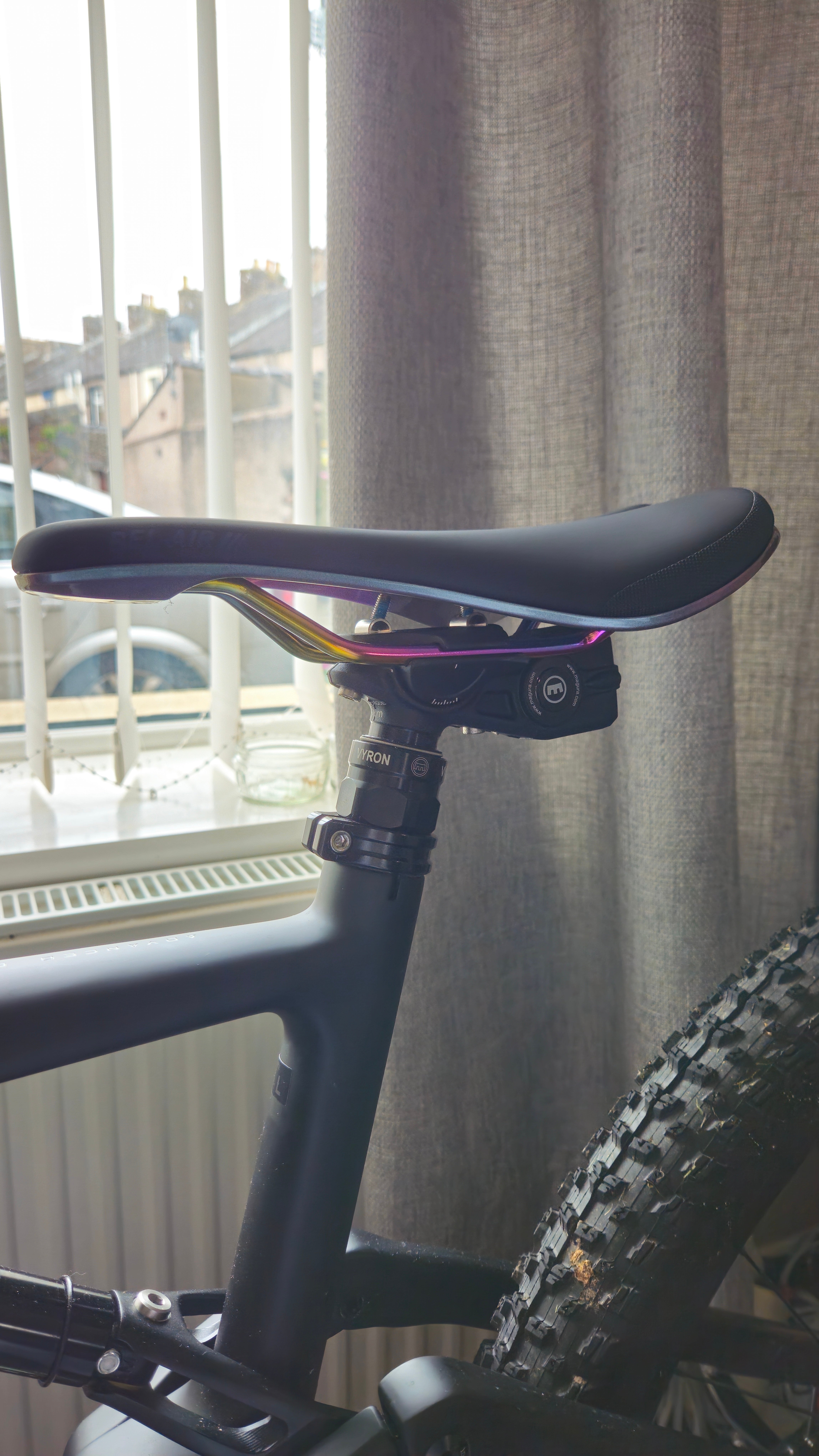

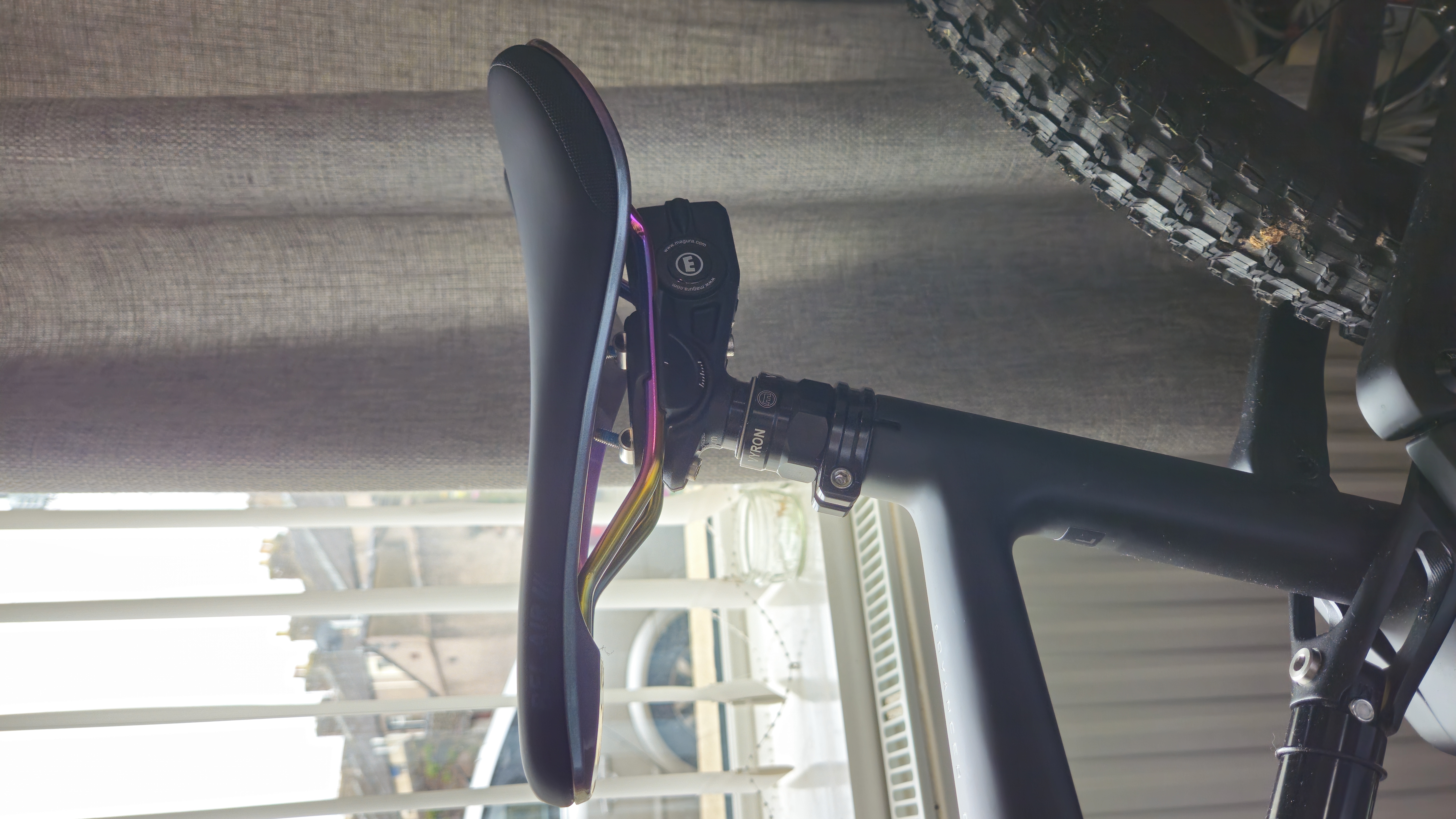

So. I messed up trying to shorten the dropper cable. I was going to anyways...but I got myself a wireless dropper instead of faffing on with the absolute nightmare that internal routing is... Magura, for the price point and I'm more than happy with it! Treat myself to a new saddle too. Behold the beauty!

Nice! And some bling as well. You're halfway there...

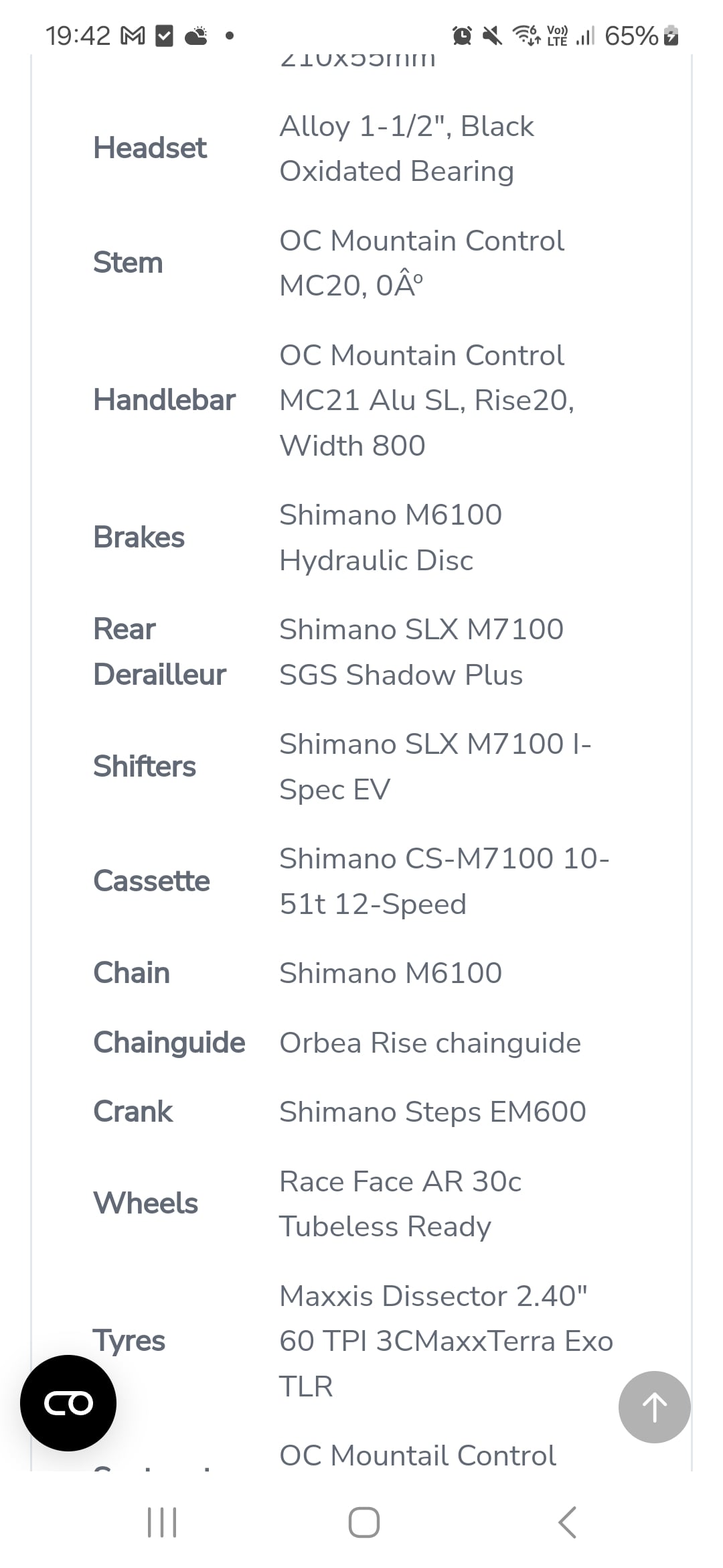

I'm back! I'm definitely thinking about adding the sram axs to my bike. My question is, can I simply just fit the derailleur and shifter without changing anything else on my drive train. I've attached a screenshot of the components currently on the bike. I've seen videos of people running it with shimano chain and cassette but I'm not sure if my cassette would fall under that bracket as ive seen none mentioning it... I've also added a kmc 12 speed oil slick chain for a bit of extra bling. I'm now pretty much 100% happy with the bike. The axs ain't necessary but it's something I'll likely wanna go with. And if its as easy as just firing them onto the existing drivetrain then f**k it! Might aswell.

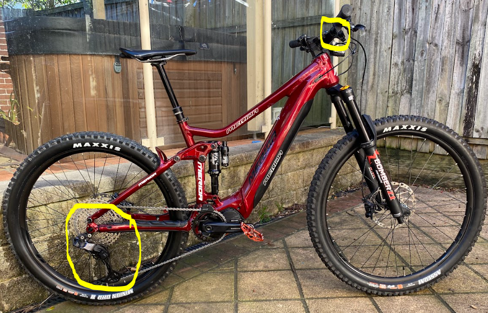

I did it to my 2023 Merida e160, with a EP6 motor. There is a whole thread on how to do it. I used that thread to get mine converted. It's cheaper than putting the Sram AXS, and keeps everything Shimano. You'll also get FREE SHIFT with the Di2 setup. Which means you can change gear when coasting.

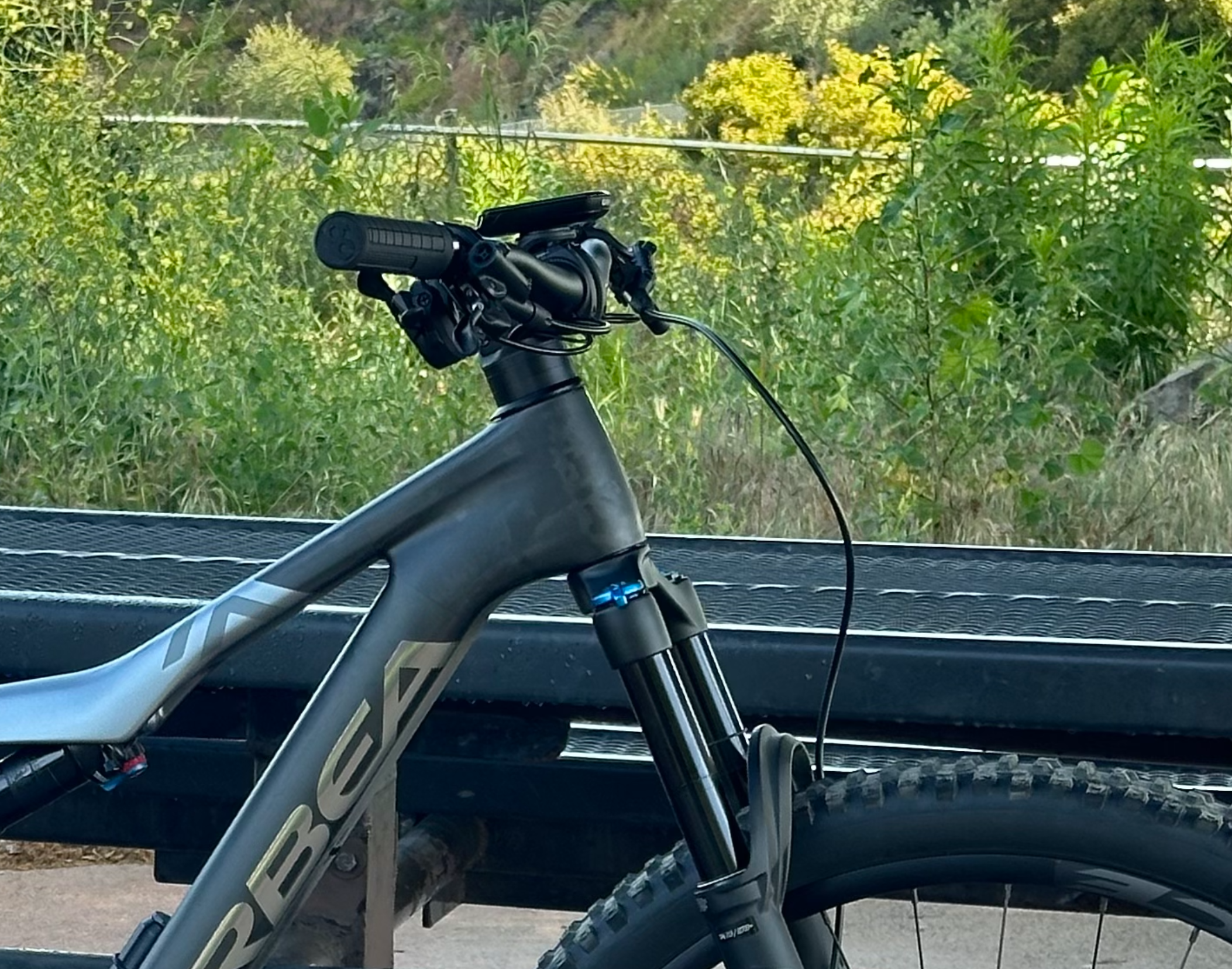

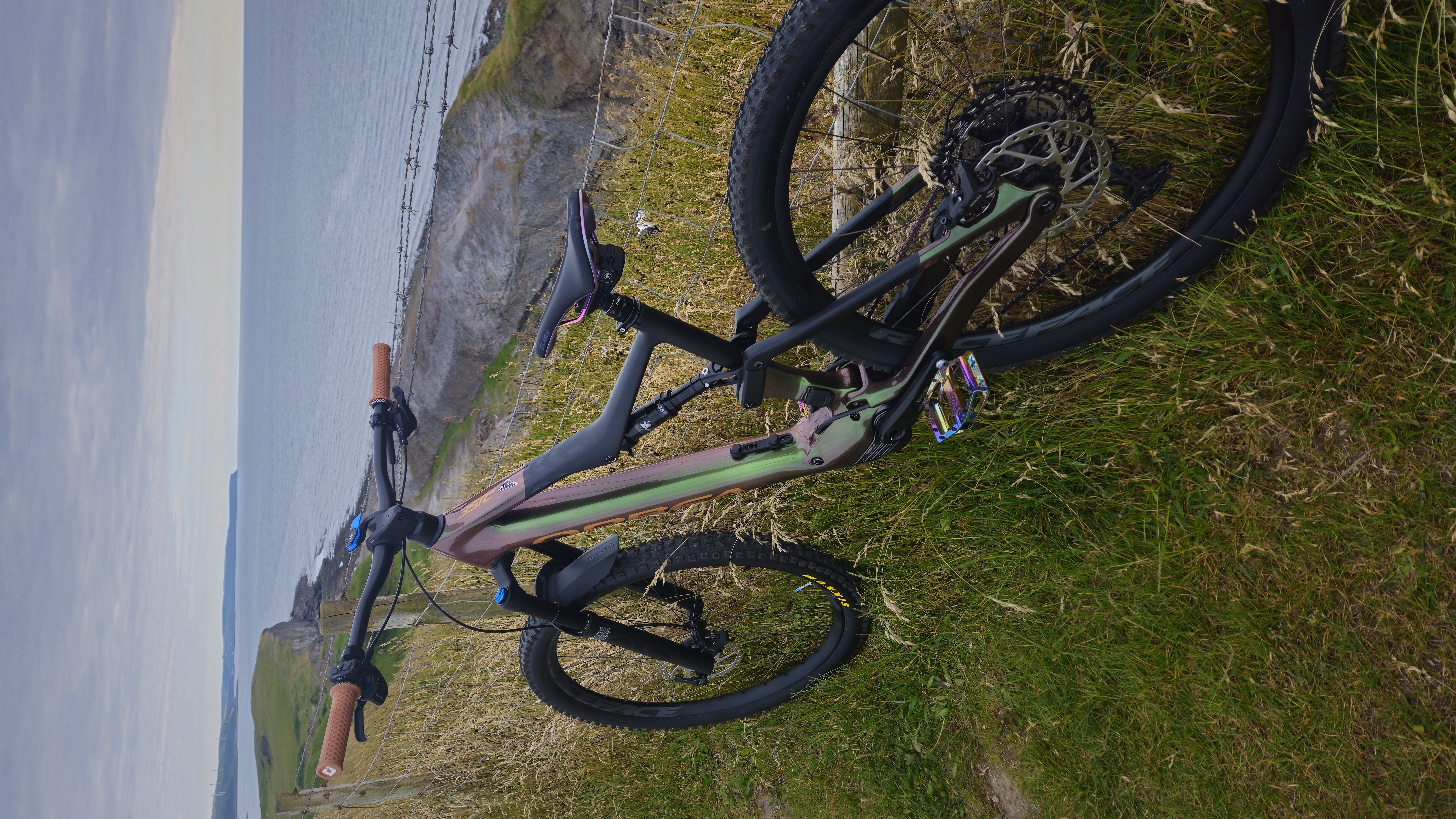

Got a nice pic of the steed today. Got some 150mm fox float factory forks coming tomorrow then I think all boxes are ticked for me. Decided to leave wireless shifting for now, will upgrade in the future. Only one niggle remaining, and I'm assuming it's obnoxiously loud rattling from the internal routing. Anyone else getting that?
