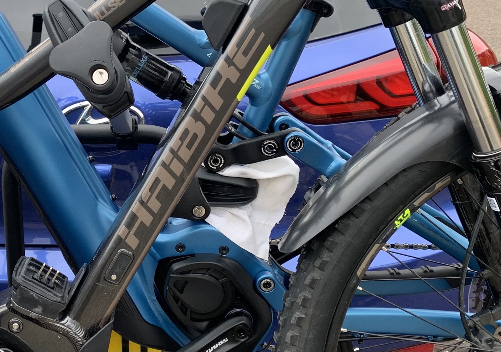

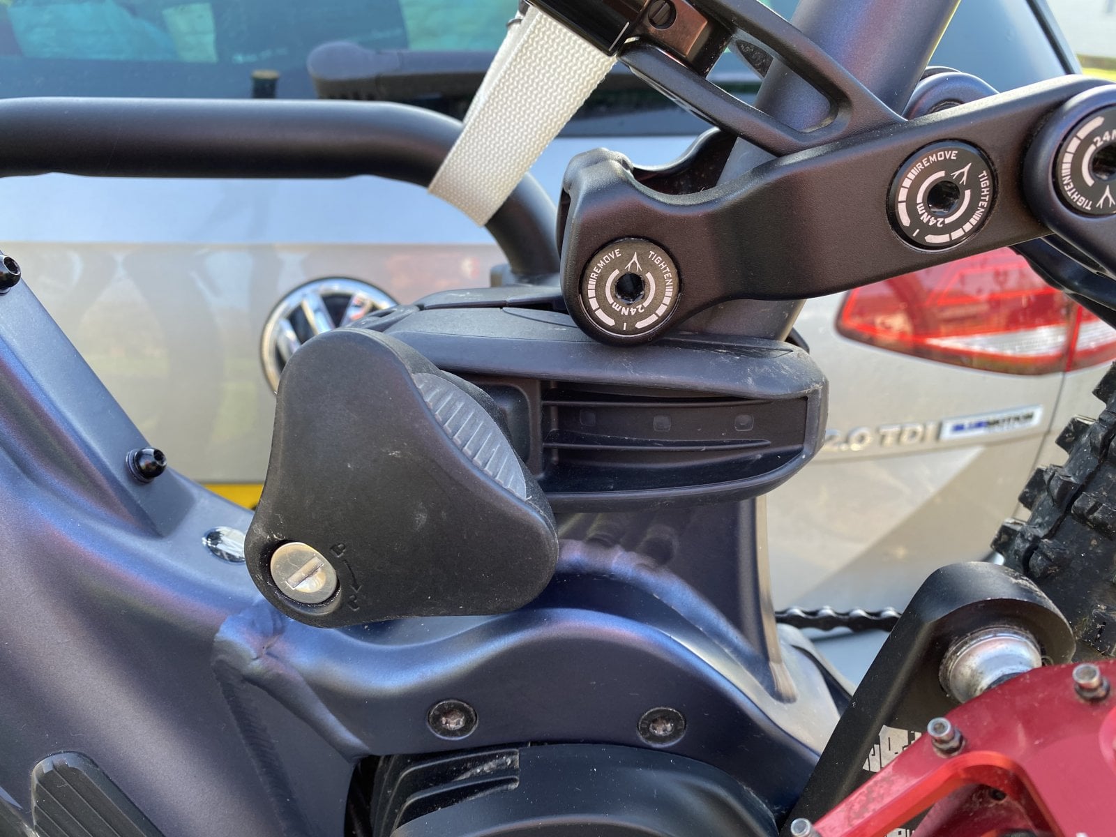

I have the same rack and bike (e160s but obviously the same frame), it took a bit of working out but the small clamp fits very securely just above the motor.
I couldn’t find anywhere else it would fit, my wife’s bike is in the way but you can clearly see my bike behind and how it is held.
I couldn’t find anywhere else it would fit, my wife’s bike is in the way but you can clearly see my bike behind and how it is held. View attachment 85265
Thanks Stoffel, there is another thread running where someone else posted an image using the same position so I'm going to try that tomorrow to see how secure it is for me but if I'm still not happy I'll order the Fiamma arm. First time fitting bike to rack and just wanted to get home with it so didn't really have the time to spend on it 👍

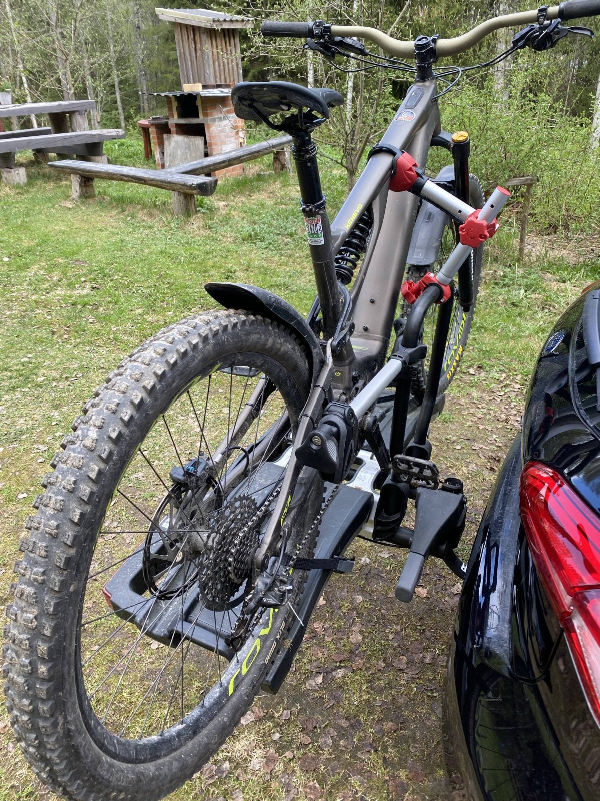

I've got an e160RS and a Thule 2 bike rack. I'm not sure if you have the same rack but I put the long arm on the top of the fork stantion (not on the moving bit) and the other smaller one on the small triangle near the seat post tube. I also use two ratchet tie downs.
I found the wheel carriers on the Thule a bit too short for my bike, a large, so I have unbolted and moved one down about 8cm so the wheel rachet straps work on both wheels.

I used the small clamp under the rear shock as in the photo Hobo Mikey posted above and it worked a treat. I'll try the long arm on the forks next time. Mine is a medium and the front wheel strap could do with being longer so I'll look into moving it, thanks
You can buy longer wheel straps, I got mine from Roof box Company, although the small straps are ok with my bike which is a medium (y)

I replaced the short arm with Fiamma bike block pro d1. Makes mounting any bike with ease now.
I did exactly the same on both the velospace and the easyfold. Way better than the standard thule arm for Whytes. Also bought the XL straps but only for the Velospace Xt 3, on the easyfold for some reason the standard ones work well.
