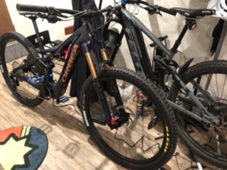

Hello to all,
coming to u guys from San Francisco. Just picked up a 2021 Orbea Rise. Shout out to the great guys at Woodside Bikes, Redwood City. Will do my first ride Super Bowl Sunday on my local trails.
