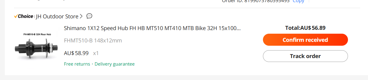

I've never had a problem with my Shimano EP600, which is almost identical to the EP801. I'm just in the process of building a new rear wheel, so I can fit a 11s Linkglide transmission. So I did quite a bit of research, and came across the magnet issue.
