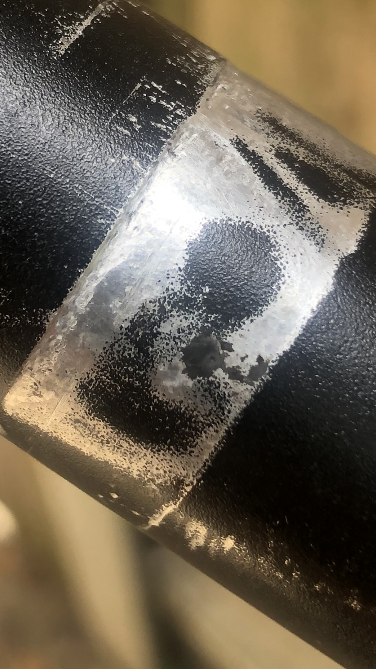

So have been having some creaking/knocking sounding like its coming from the headset on my "21" Stereo 160.
Re-greased and bearings seem ok, made no difference.
Just taken it right apart and noticed where the plastic compression ring goes onto the steerer tube on the top bearing, its VERY worn!
Its hard to see on the pics but there is a groove in the steerer tube of my Zeb!
The top bearing seems ok, but have a replacement along with cup coming tomorrow. But concerned with the amount of wear on the steerer tube - the problem will continue.
Have spoken to my local Cube store, they are happy to take a look next week, but want it re-assembled first. So will try the new bearing tomorrow first.
But what do we think caused this? Will the new bearing fix it? Im guessing the steerer tube can't be replaced on the Zeb?

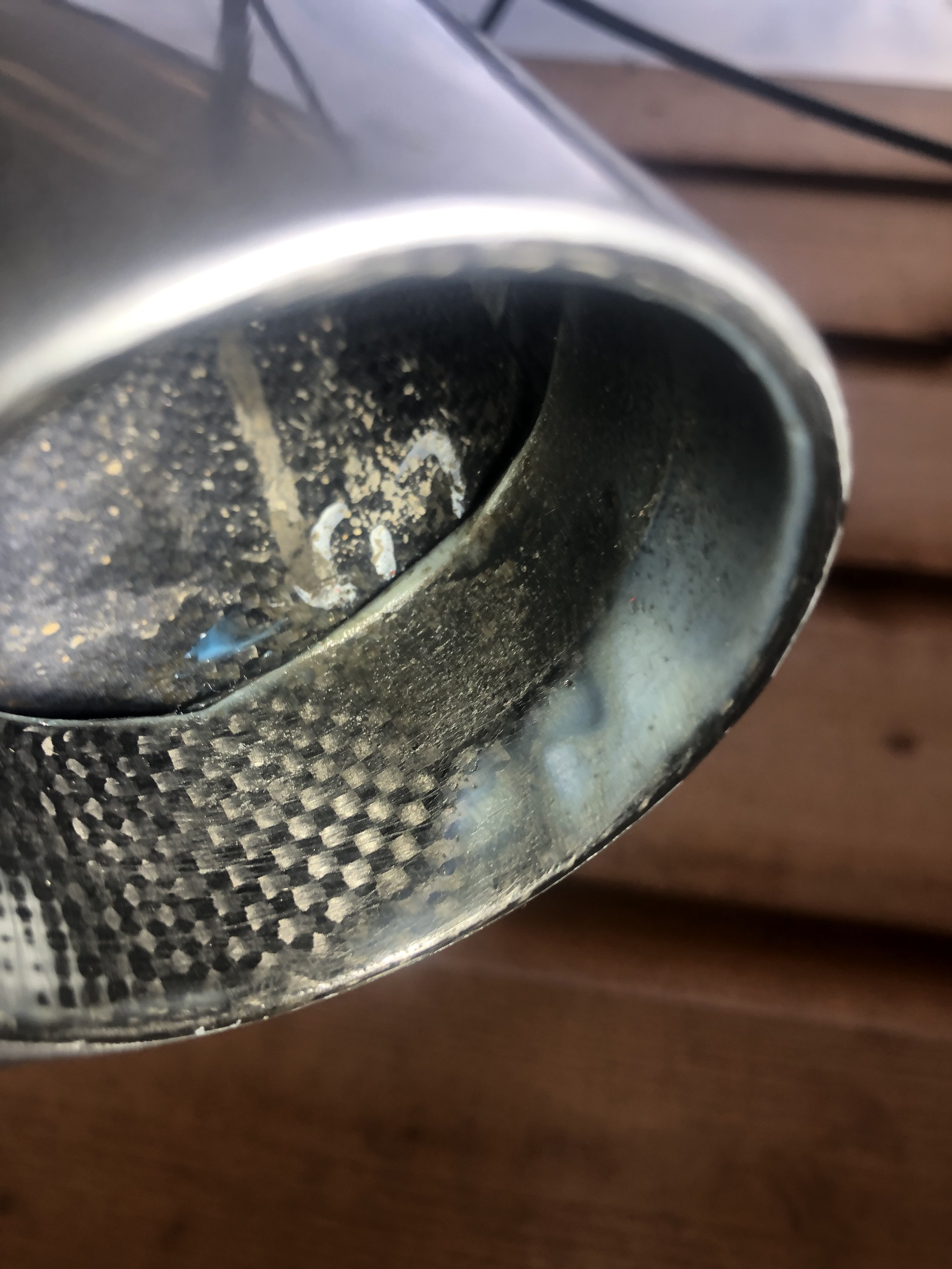

Hmm, and even more worrying, the carbon that the lower bearing cup presses into looks a bit worn?....

I think you have your cause and effect backwards though. That wear on the steerer and the headtube is because the headset was not properly adjusted/tensioned or a component was worn, not the other way round. I wouldn't worry too much about the steerer, but if the bearing moves in the headtube, you may have a big issue.

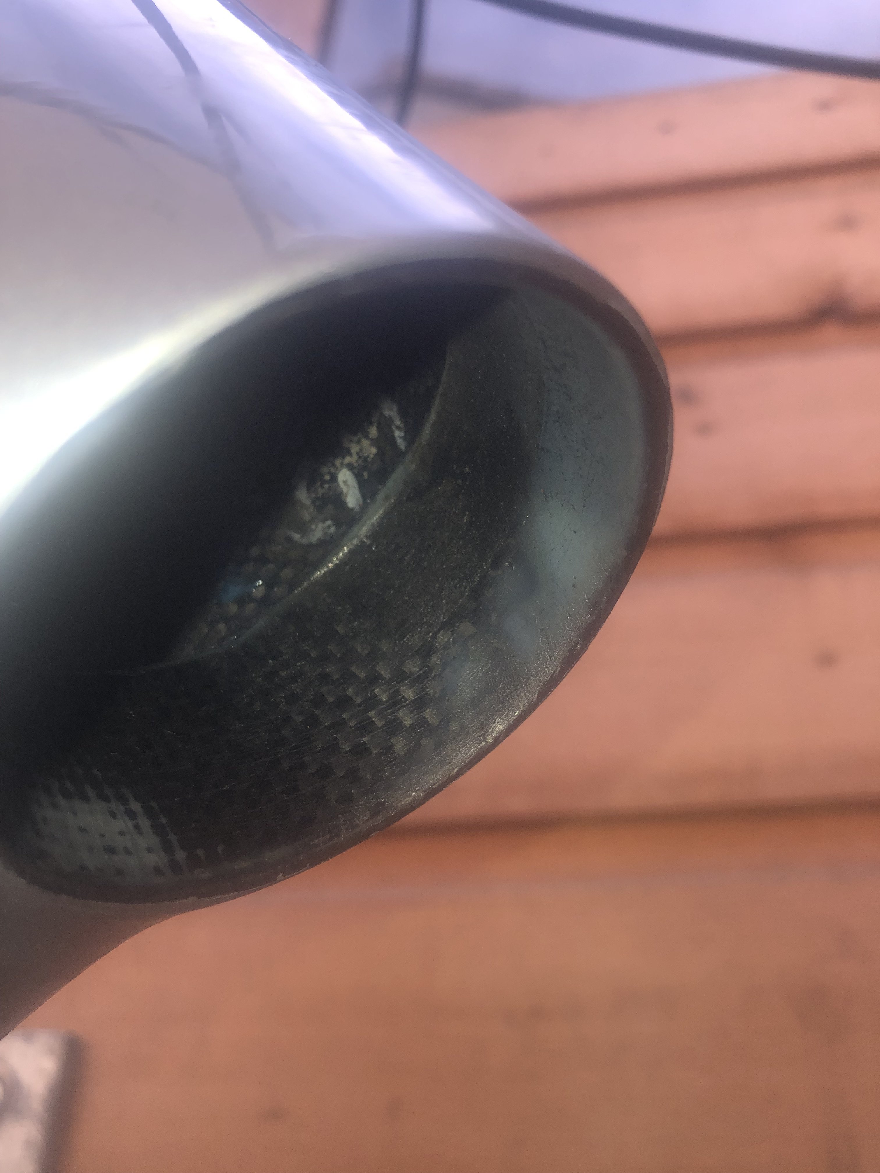

Actually now i take a better photo with some light, you can see the left side is clear Carbon Fibre, where the right hand almost looks like it been ground down and some form of filler in there??
But its not perfectly smooth, there is a bump in the filler'y stuff.
And the bearing cup only goes half way up, you can just about see the line, so can't have been from the cup slipping.
So it must have left the factory like this? would this be normal?

Having spoken to a few motorsport peeps, they are pretty certain the head tube is de-laminating, causing weakness. Hence the sounds :eek:
I wonder if the lower tube is flexing, this caused the wear on the steerer tube?
Im very certain i didn't have a loose headset/tension.
But if thats the case, thats probably goodbye frame :(

Almost certainly an issue with improper installation or adjustment, unfortunately. The *MOMENT* a headset starts making any type of noise or has movement, it needs to be dealt with, or damage can occur fairly quickly. I check mine before every ride by turning the bars 90 degrees, grabbing the brakes, and pushing the front end back and forth and looking/listening for movement.

Looks more like rubbing than delamination to me. Loose headset for my money.

So i took the bike back to the supplying dealer on Tuesday (6 hour round trip!), he had a look at the photo's and thinks it looks like the cup has been slipping causing wear - but not seen it before on these bikes.
Said he will strip it down, take photo's and submit a warranty claim with cube, and push for new frame and fork. But was pretty vague on whether the claim is likely to be approved and potential repair timeframe.
