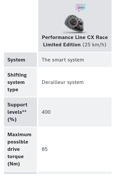

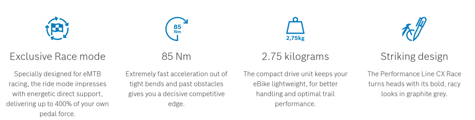

This isn't really a very good example.
For starters the OW02, whilst stunning, wasn't lighter or more powerful. It was actually homologated to comply with the German 100hp limit, so it was actually heavily de-tuned with the knowledge that anyone buying it would re-build the motor with higher spec components to get the race performance required (unless you forgot the change the cams, then they failed). Agreed, it was extremely expensive though !
The CX4 Race is pulling the same power, so theoretically no more strain (not knowing the component changes, it might just be a magnesium case like a Brose Mag S with bonded bearings and then lots of failures...) However it ups assistance in Race mode to 400% from 340% so you don't have to pedal as hard for the same assistance (for example, the EP8 is 400%). The other obvious change is the longer over run, which means you can crank it over obstacles easier and learn to use those moments to your performance advantage.

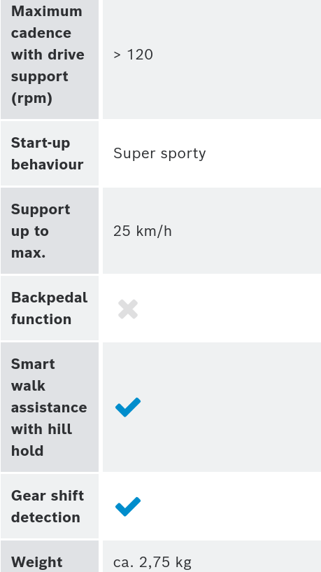

My XC race cadence was usually 85-90 anyway. Not sure why I'd want a motor optimized for 100+
Hey, yes that is your average cadence. That is also my average cadence.
What I am talking about is exactly what you said in your answer.
To elaborate, I live just under a 1200m mountain where the WC DH races are held, the slope range goes all the way from 6% to 15%...so I have a looot of options for serious climbing.
I monitor my cadence very closely and in the really steep parts where u use a low gear higher assistance level the cadence goes beyond 120rpm(can send screenshots if you don't believe me)...so you are out of the ideal power band(high assistance) and out of ideal cadence range(low gear)...and how that feels probably you know...if not then you need to find steeper and longer hills.
One thing to have in mind, all the motors are based on sensors, one of them being the magnet. Some motors when you do a half(technical climbing) pedal stroke(magnet moves past the sensor twice in a very short time)motor registers that as one revolution...and with such pedal strokes the cadence can rise up to 140+(like TQ mentioned they did in their tests).
The problem with any low power systems(in this case 250W limited emtb motors) is that you need to keep it in an ideal power band and so that is managed in one part with internal gearing for ideal pedaling speed(cadence) down/up gearing to match the motor speed, the other part is software/firmware that manages electric current, the voltage drops with discharge so the unless the software is smart enough to compensate with current increase then you can also feel the snall power drop in the lower third of the battery charge.
So for this/my type of riding and racing of course it would definitely be a good decision to optimize a motor for a higher ideal cadence range and some first reports do also say that it supports with the same level in higher cadence ranges.
