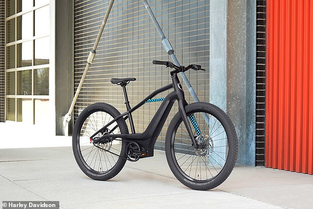

The new Harley Davidson pedelec has a mid-mounted gear box.
Is this the future?
Will we start to see the gradual disappearance of derailleurs?

Undoubtedly. Mass centralisation and less exposure to dirt/damage. Good to see that has a gates belt drive too, I love the one on my Cannondale.
That said, the HD pictured above has to be one of the least attractive ebikes ever made, so maybe let's wait until someone sensible has designed one!

Looking at that Hardly Ferguson design concept - could be tidied up some, however being a hard-tail things are much easier. Add rear suspension then you have to allow space for a shock, swing-arm pivot and most importantly, add a chain tensioner as unless you can design a system with the pivot point exactly at the centre of the front sprocket you are going to have chain tension dynamics come into play.

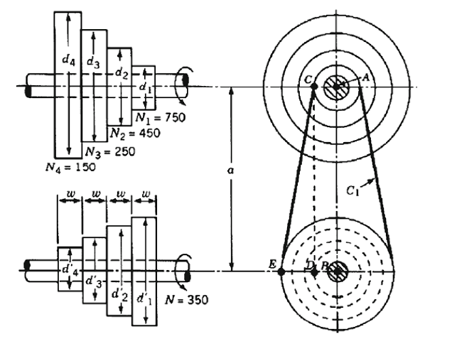

Having looked inside a couple old motorcycle road-racer gearboxes (Honda 12sp & Suzuki 14 sp) I am thinking that even though metallurgy has come a long way there would be too much weight and more importantly too much drag. However, as @Fivetones (not a bassist are you?) says CVT could be an option. Yes there would be drag but having seen a simple design a few years ago with stepped cones, a belt and a sliding mechanism to move the belt up or down
similar to image below, but would need ramps between the levels.
images
With something like this the cones can be hollow with just spiders back to the rotating shaft.
That would keep weight down and if designed correctly should I hope minimise drag.
