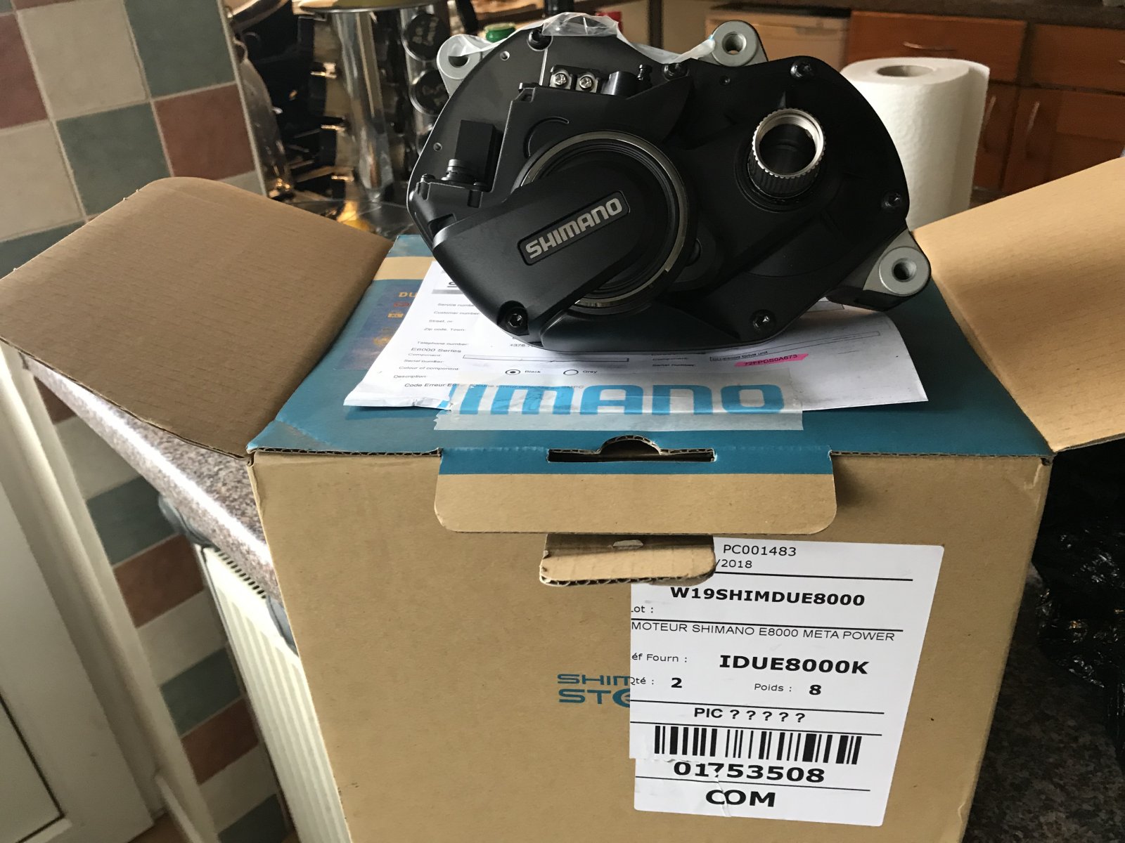

New motor just arrived from commencal , shimano France are not great at testing intermittent faults , but commencal have stuck thier necks out and sent me a new motor from thier own stock after experiencing constant random fault codes . That’s pretty dam good customer care I think , and it hasn’t cost me a penny in postage iether

Yes should be all set up with latest update just plug in and go I expect not fitted it yet
I was getting differing error codes
But usually it would show E010 while riding and just cut out sometimes when Re booted it would show w013 or be ok for a bit then E010 again
It would sometimes stop and be dead for a few days then just re start and be fine for a few rides hence the problem I have had getting shimano France to warranty it they obviously thought other parts of the system were at fault and didn’t know I had tried everything else

Yes it was probably the worst situation with an intermittent fault , I took a video of it when it failed the last time , commencal knew I had tried everything else , new speed sensor , new switch , new battery cable plus I have 2 batteries , we also have the pc plug in device to show there was nothing as faulty , so it had to be motor . Commencal were top notch with their service , shimano France not so great . It may have been easier if I had sent to shimano uk I could have spoken to them and made the problems clear , however I would have had to have gone through a uk dealer and probably paid the labour to diagnose and replace motor etc . I had my bike here and was able to give it a full strip and service while the motor was away , possibly more time but no hassle or cost .

Tamas the motor took latest update from 4.5.1 to 4.6.0 and i had to activate the lights switch function I’m the app on my phone . All seems to run fine now
