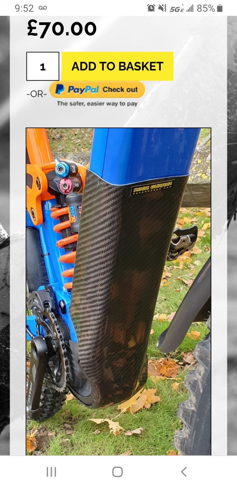

As soon as I get some extra cash, I'd like one of these for keeping out much of the water and mud. The socks, work well but are heavy and hard to take on/off.
I ordered one of these and it seems the model changed a bit. It has a bit of extra material on both sides and really clings around the battery tube. A velcro strap is included but not even needed given the exact fit.
It'll surely prevent mud entering the gap between battery and motor cover and protects the latter. Worth every cent.
IanVersion2
Jun 12, 2020
64
79
Stroud, Glos, UK
Any chance of a photo mate? Sounds really good, but £70 is a lot of beer tokens :D

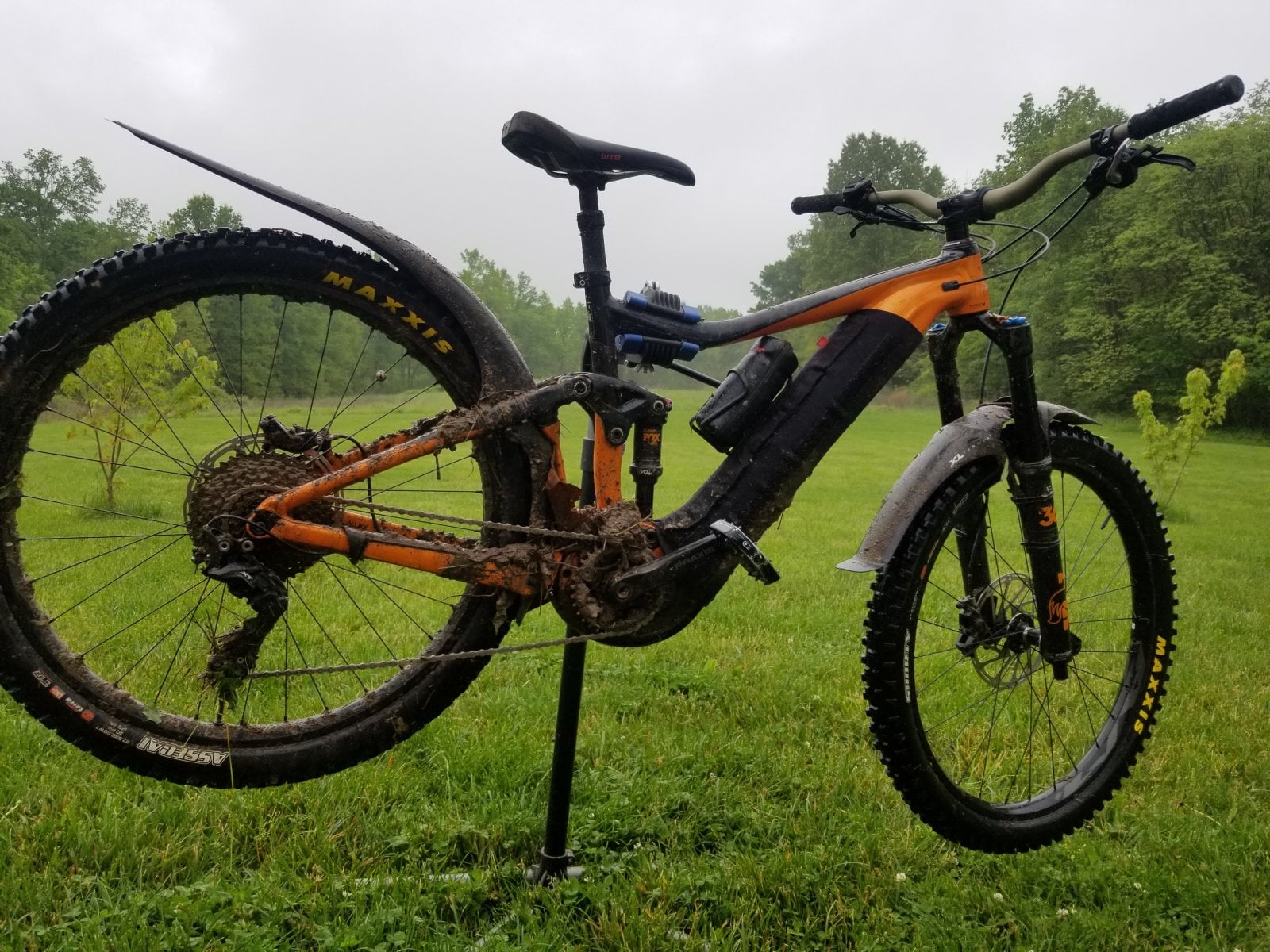

Is that a separate mud guard protecting the suspension linkages?
Bilko
Aug 18, 2018
53
45
Dorset
Yes, many of us started stuffing a front mud fender inside our mudhuggers to protect the linkage. I post a link if I can find the thread.
That would be helpful thanks, now the weathers turning i want to protect those pivots and linkages as they look expensive.
