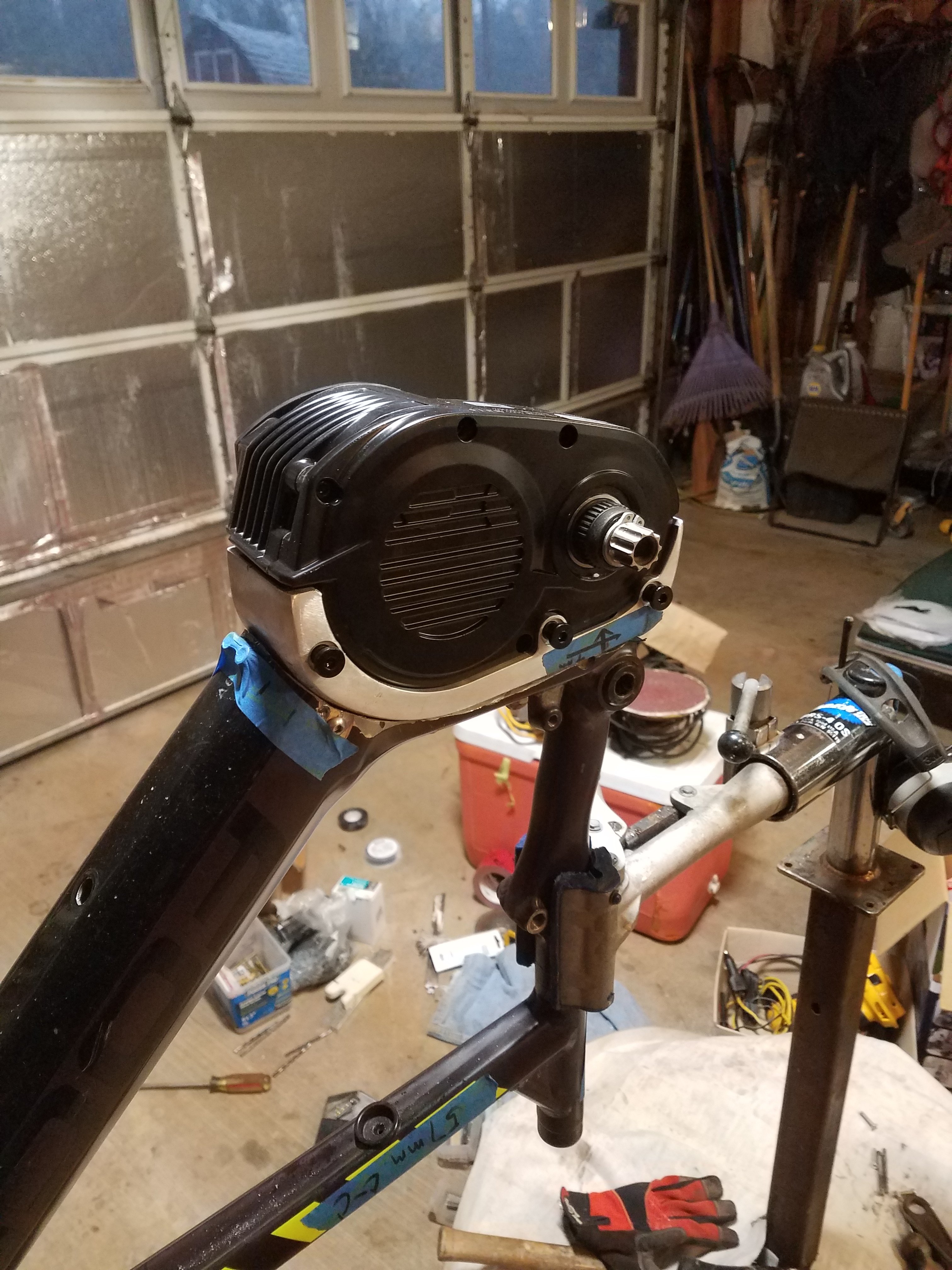

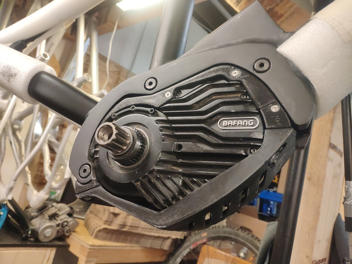

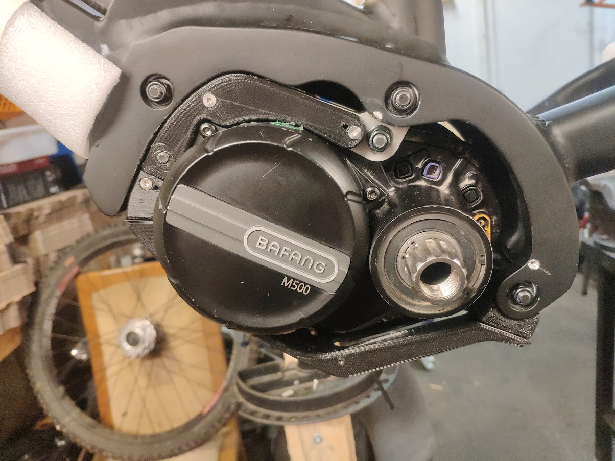

Yes I designed everything around them so that one can reuse them. I talk about the Bafang Skidplate and sidecover, not Shimano Covers.Does the plastic engine cover still fit?
Exactly! Is the crank axle at the same position then the shimano crank axle was?Yes I designed everything around them so that one can reuse them. I talk about the Bafang Skidplate and sidecover, not Shimano Covers.

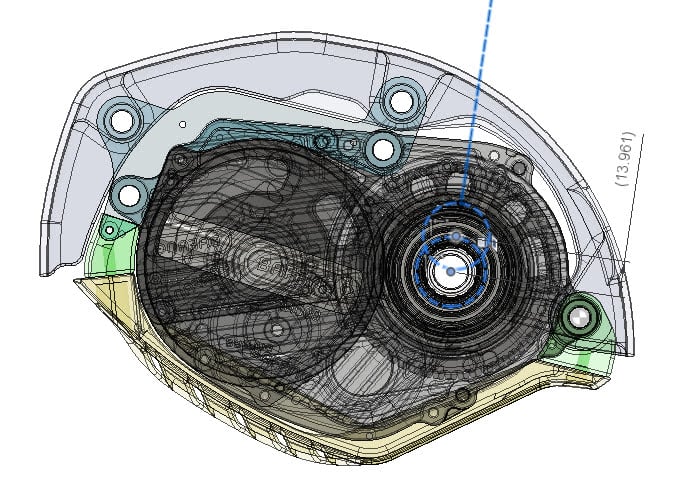

Similar, but had to move it along the seat tube direction by around 14mm. See:Exactly! Is the crank axle at the same position then the shimano crank axle was?
So You lower the BB of an existing frame by 14mm. Not bad, but important to know!Similar, but had to move it along the seat tube direction by around 14mm. See:

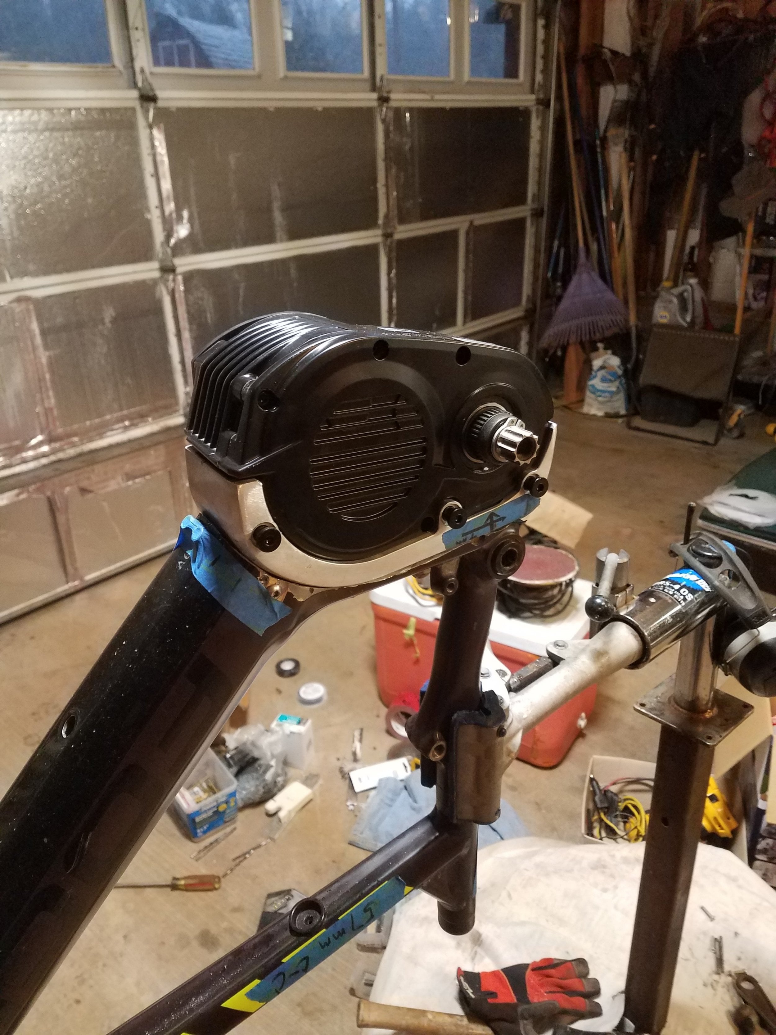

Plates are already lasercut, but want to finish the 3D-printed parts before general release. Can send you a pair including screws, if you want.Any date for general availability?

Shimano E6100/E7000/E8000/EP8 [Frame] to Bafang M500/M510/M600 [Motor]
That may be the case for M500, but not for M510 and even less for M600. A lot people love tinkering and Shimano is closed. However frames that fit Bafang drives are often trash when it comes to geometry and quality. Other reason might be that one may convert his old Shimano bike sitting in the shed for a while now and revive it? I have a customer that has bought Shimano frames and Shimano won't sell him battery and motor. He asked me to develop a kit. Already had this in mind.Can you please clarify what is the purpose of this conversion? I am asking this because imo ep8 or even e8000 is superior to bafang m500

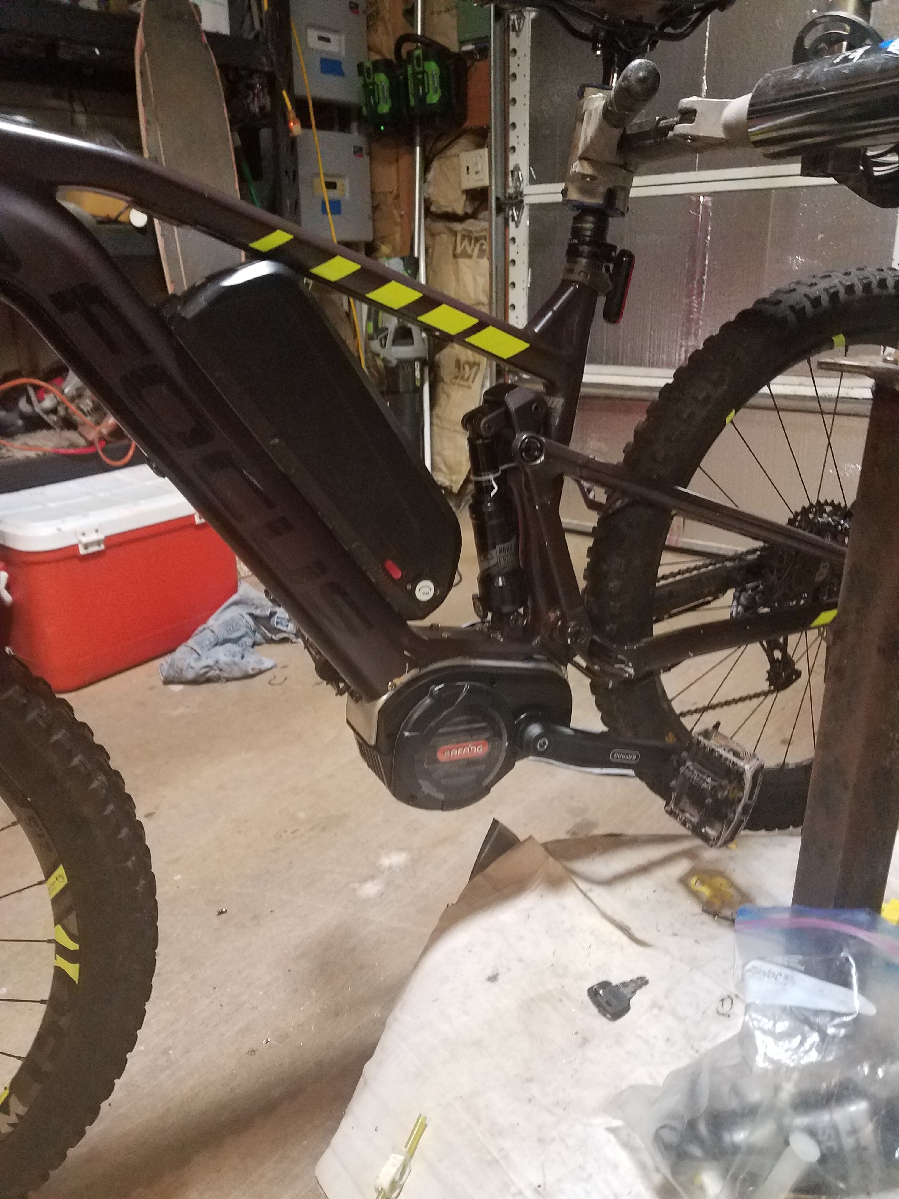

no, you need all from Bafang: Motor, Battery, Display, etc.hiya mate, i just signed up so i can ask how easy would this be? i hve an ep8 mondraker dusk rr....would it be a straight swap and still work with the battery and shimano steps screen thingy???
spose i could get a battery made to go in the frame like the one inside atm....not that this guys ever gonna reply about his motor conversion kit lol.no, you need all from Bafang: Motor, Battery, Display, etc.
