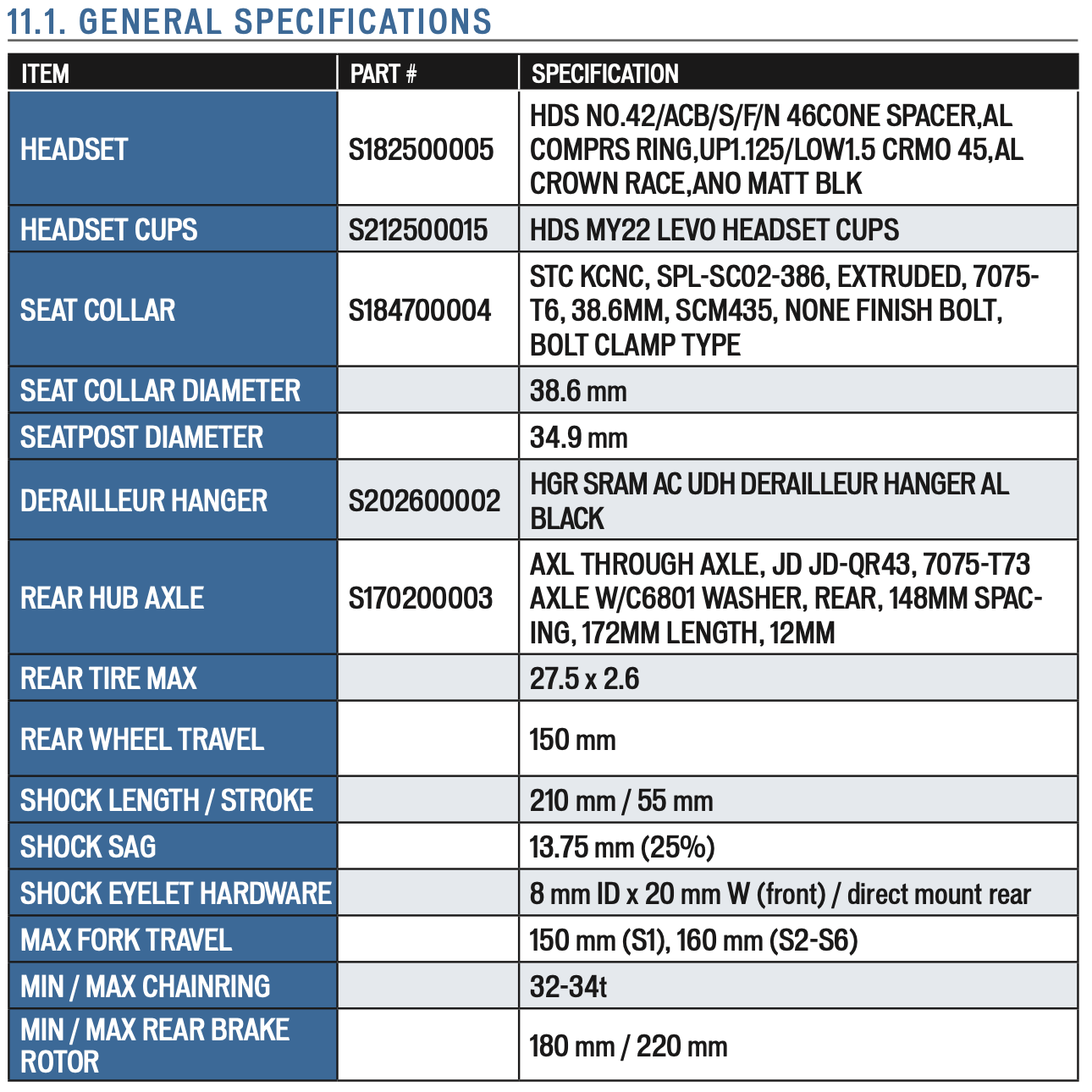

In the levo paper user guide thst comes with the bike it's rear design sag is 25%- 13.75mm . Not suggesting this Is the correct sag point for everyone tho. The kenevo is stated to be 30% which I found interesting
Do you have a picture of this page?
I just set mine by preferred feel and ended up at 15.5mm.
As always, sag is just a starting point. You should always run what feels best to you, not what the sag number says.
