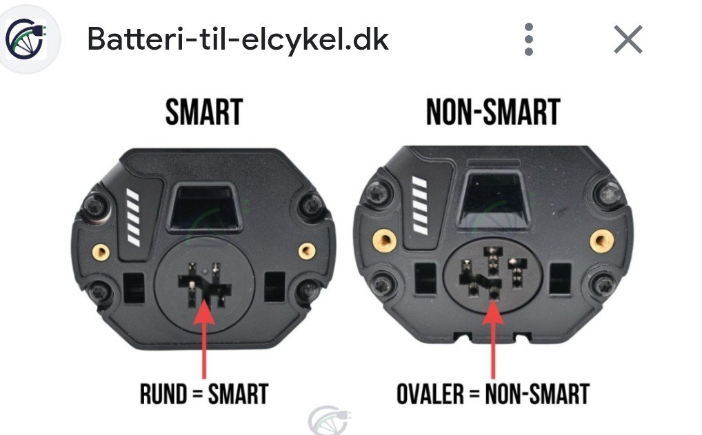

I’m not sure about the new 750w battery. (Longer battery compartment). I think the power connections are different.
