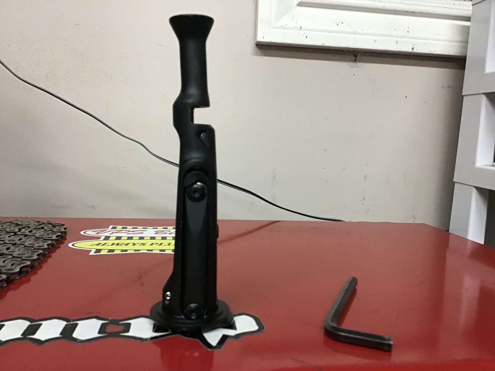

So after using the SWAT chain break tool, it appears to be bent, or maybe they are supposed to be like that. Have a look at the photo and you can see the threaded section is out of line with the rest of the unit. Would anyone be interested in taking their tool kit out to se if it is the same or not? I would really appreciate it.

More likely you have tightened headset too much causing swat tool to bend....

I found it very hard to believe you could bend swat tool like that while breaking the chain without damaging the chain while doing it ... I used this chain breaker feature several times with no issues. I still believe more likely this swat tool is bent from excessive headset tightening ...

You would have to seriously tighten the headset bolt to do that , probably strip the threads before tbh 😳

Laugh all you want. I’ve always been very careful tightening the headset to ensure not to over tighten. common sense would also tell you that the threads with strip, and you would have to use a large wrench to achieve that. Also, it couldn’t bend inside the head tube from tightening, as it would be pulling straight down not on an angle. The only thing that has changed is I used it to break the chain. i’m not sure why I’m even trying to defend myself here 🙄

^Actually due to the cutout, the chain breaker DOES have a higher chance to bend at that spot when tightening the headset, DESPITE the bolt being in-line with the center of the steerer...

Yup that’s the Location of the bend. I just sent a message to customer care at specialized explaining what happened. Let’s see what they say.

Sorry, forgot to update. Specialized credited my LBS the full amount, as they can get that part here in Canada 🤷🏻‍♂️. I wouldn’t want another one again anyway. Specialized were great to deal with. I installed a regular star nut and top cap and will carry my tools from here on out.
